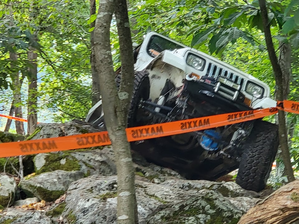

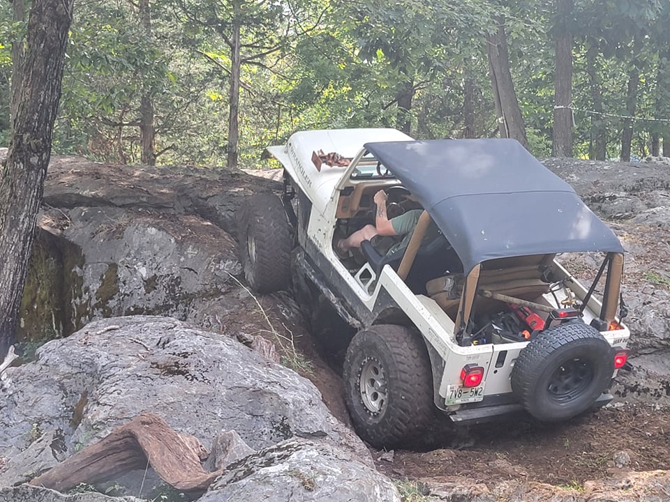

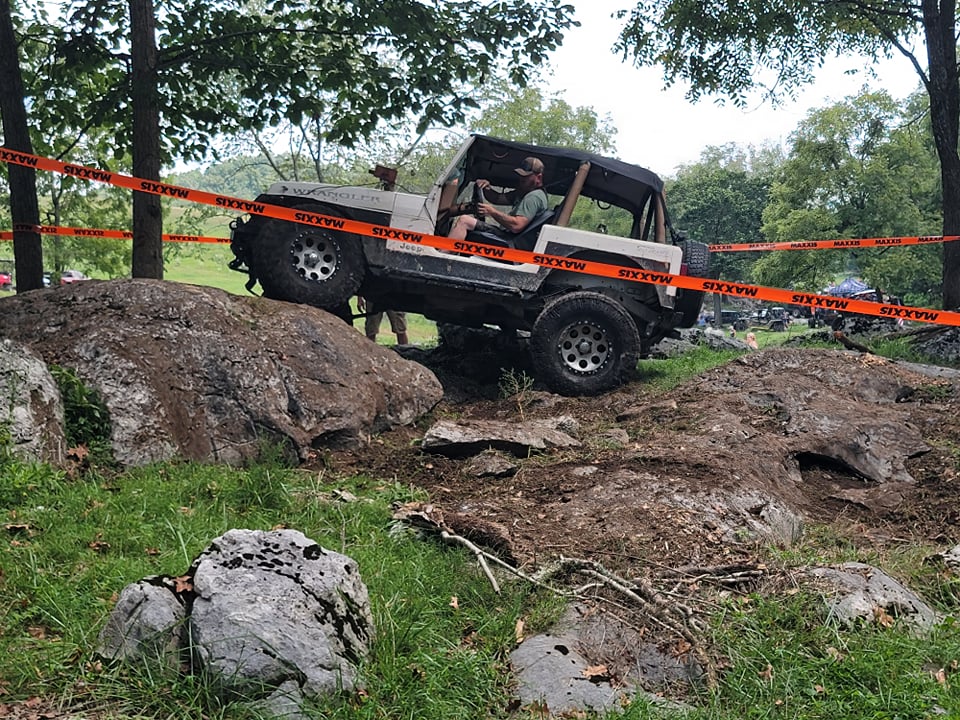

It already has quite a few upgrades, I beat the crap out of it on black and double black trails, Windrock, Sandmines, Tackett Creek etc.. HP D30 front, locked, Yukon moly axles Revolution 5.38 thicc cut gears, rear is a Ford 8.8, detroit full locker, moly axles same gears. Rubicon express suspension, Barnes diff covers, Barnes one ton xover steering, Barnes skid, 1/4' armor and tied sliders etc... Its a built little trail rig that I daily. It now has Metalcloak full front tube fenders as well. I am trying to get my one tone axles done and my v8 ready to swap as well, but it takes time lol, especially once you pick up this hobby again.
