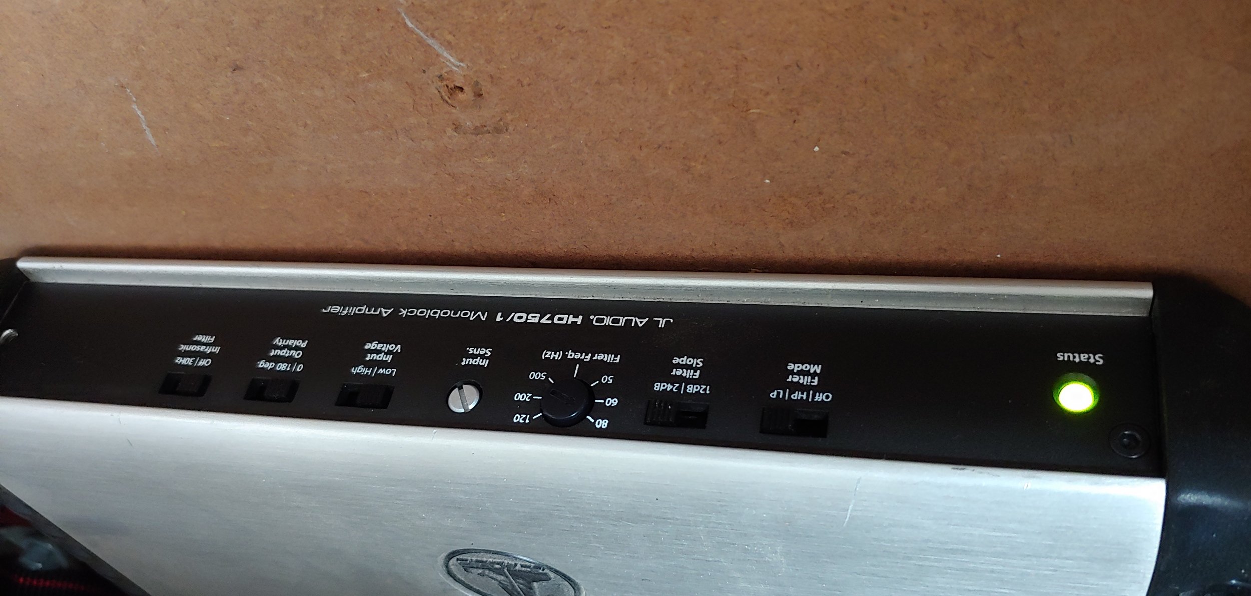

You have the crossover turned all the way down? It looks like it has a LPF at 40 HZ when turned all the way down. A 60 HZ test tone will be filtered out. Turn the filter up a little maybe. Is that push button on the left labeled “HP” and “PB” a switch between a high pass filter and a low pas filter?
With PB bass comes in, HP plays sharper, less bass. If i start to turn filter a bit, voltage raises, but barely, maxed out with 300Hz gives 6.8ACV.
Okey, tried playing 40Hz tone, Amp set on PB 40Hz, gain all the way up, i get 7ACV
40Hz tone, Amp set on PB 300Hz, gain all the way up, 9.5ACV
With HP filter voltage also low. 40Hz i think shows like 4 volts. These numbers i get with head unit raised to 75% volume and everything flat.

I tried the flat setting to no avail. It turns out my gain is already set to it's lowest voltage input, so setting eq bass flat completely attenuates my bass output.
Although thanks to your input, I found that my settings were wrong. What I thought was the 45Hz slide, is actually 100Hz. The reason for that is the radio has a Sub output channel for the 45Hz curve. Now I know why it was easy to blend the sub stage with the front; I had 100Hz maxed out! I set that halfway and the subs sound better. These are flat subs so they benefit from flatter upper bass notes.

Why is your gain structure messed up? Typically, the gain input sensitivity ranges from ~200mv to 5v+. Usually the output voltage of a HU is 2v or more.
It surprised me as well. It is a Pioneer Appradio on a JL HD750/1. The adjustments I made were lower the 100Hz to 50% and raise the subwoofer output frequency to 120Hz. I use the amp's x-over for that setting.
