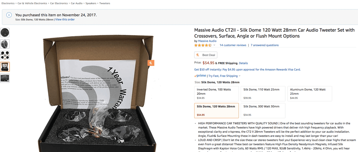

I love mine.  Honestly I have no idea what the difference is if there is one.
i was the pioneer to using them haha. Its a pretty good standard baseline for an all around high output durable and airy tweeter for bassheads and the borderline bass/SQ crowd. The main advantage is with the swivel pods that are included for the installation on axis. The off axis performance is pretty decent too but i'd go with on axis if possible.

looks like the main difference between the old version and the new version is its not german silk anymore, some other kind of silk, the tweeter is reconable now, the crossover is a cheap inline crossover thats a -6 db slope vs a full blown crossover at -12 db slope with the old one.
looks like they kinda cheaped out a bit vs the old gen and they are charging 5 dollars more.. Let me know how the performance is when you get them in.
