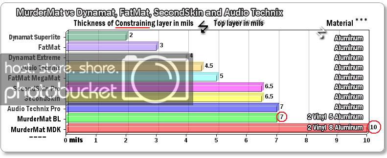

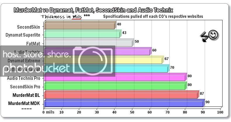

remember the purpose of deadener is to provide damping. thickness is not a useful metric. you can increase thickness by injecting air into the process without increasing material, cost, or damping benefits.
you need to be able to quantify the elastomeric and viscoelastic properties of the materials in order to compare them.
the only true test of deadener uses accelerometers and thermal monitoring.

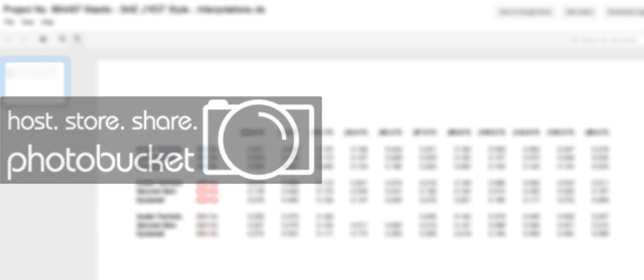

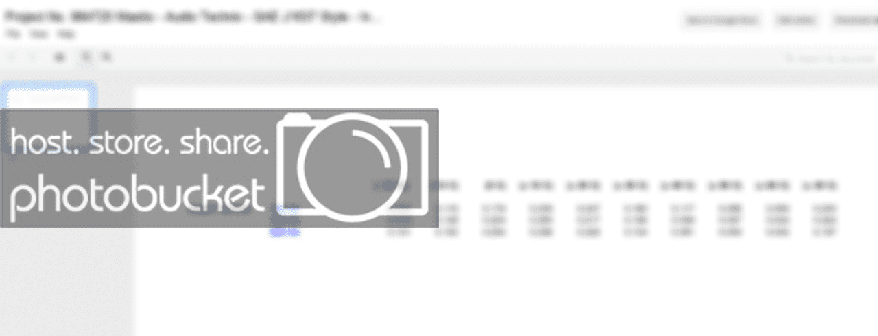

The SAE J1637 style test is the only fair way to compare deadeners. Just because one product is thicker than the other does not mean it will preform better, it truly comes down to the adhesive. The SAE J1637 cost $600 per sample to have it tested. I had them test 10+ samples (my own and several other brands) for me in the past, IMO it is the only real way to compare deadeners. It compares how they preform against each other acoustically.

Send me an email Coleman@AudioTechnix.com or check the AT section there is two threads with the SAE J1637 style tests comparing a few companies (please note I have not posted results for every sample I have tested but have posted the test results for SS, Dynamat, and AT).

We know that it is not all about the thickness of the CLD that determines its effectiveness in actual dampening... as you know there are also 2 parts to deadening, controlling resonance of the panel AND mass loading, in which the thicker butyl layer weighing more is almost always going to be more effective.
Especially in the Car audio arena the idea is to stop/prevent flex as much as possible as well as just control resonance.

This is what he's talking about. These tests. I actually pulled some of the numbers I used in my graphs from that sheet, nobody else had them.
I'm pleased everyone is back on topic, it's a perfect opportunity for a discussion about it and other products. It was never my intention to make
other sound deadeners look bad, nor make MurderMat look "the best". I've stated this 3 times previously. I pulled the specifications in the graphs
off of each co respective websites and compared what Dynamat, FatMat, SecondSkin and Audio Technix wrote, that's it. What you seen in the
graph's was never a matter of personal opinion. I can't help it if the numbers specified by the companies referring to their ''premium versions'',
Dynamat Extreme, FatMat MegaMat, SecondSkin Pro, and Audio Technix Pro were all "surpassed" by MurderMat's standard 87 mil BL version.
My personal experience with MurderMat is that it's a great product, but is it the best? Who know's, I'll leave that to you guys to figure out.

Actually that is not what I was referring too. Give me a few minutes and I will post what I was talking about.

Ah. I thought it was, I pulled that off of one of your posts here. So are we to understand the comparison chart you made I posted does not reflect
the testing you paid for of those products then? Or was what you just posted here additional. Thanks.

Correct. The charts I posted above are the tests I was referring to that cost $600 per sample to have done. The test is called SAE J1637. Basically tells you how a deadening product preforms acoustic wise. I did not post all the of the results for all the samples I have had tested, just posted a few to give you (and others) an idea of what I was referring too.
The chart you posted from the AT section is similar to yours. It is a chart showing what manufactures said the thickness of there products were. Then I went out and purchased every product on the chart. Next I measured each sample with a micro-meter (which you can get at a hardware store for $25-50) to see if each sample was as thick as the manufacture claimed.
These tests were only done with the 60 Mil.. Correct?
Yes Audio Technix on the graphs above represent the 2 old versions of the 60 mil. I no longer sell those 2 versions.
Second Skin in the graph is there current version of Damplifier and the Dyanamt in the graph is the current version of Dynamat Extreme.
