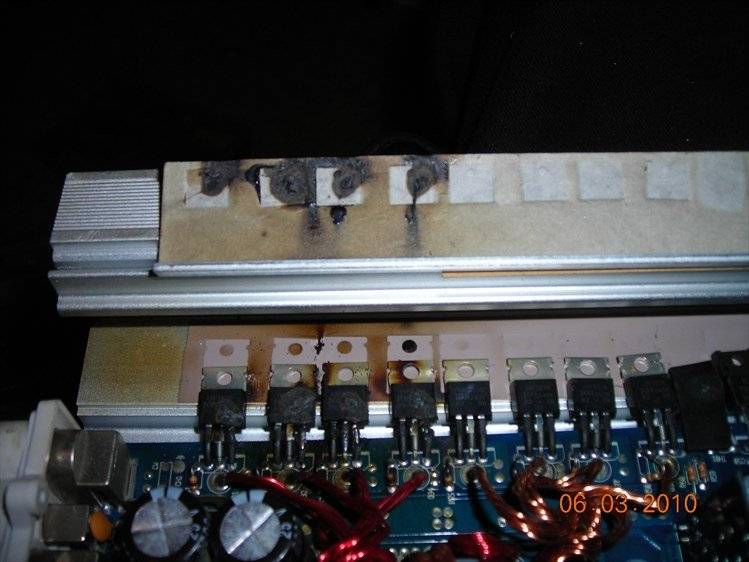

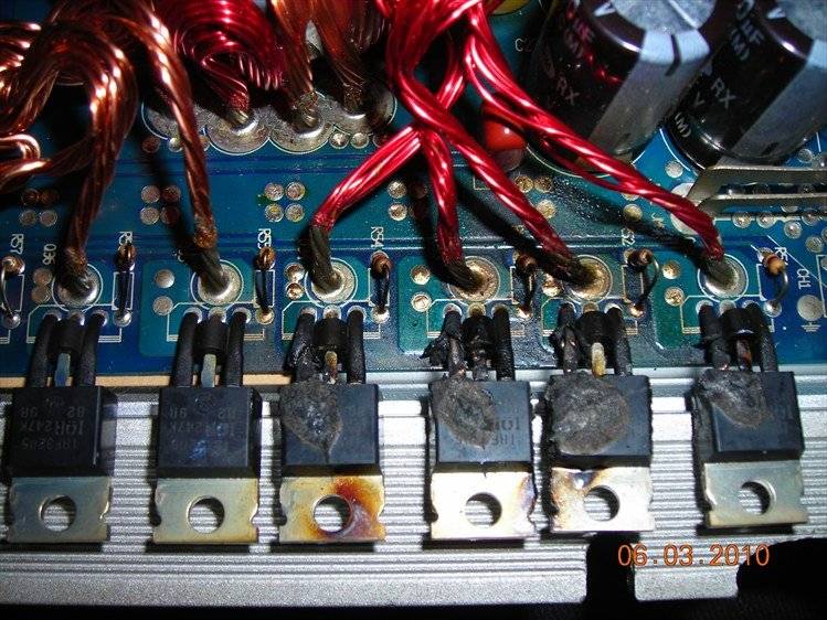

Look what happens when you push an amp w/o block fuses well past its thermal capabilities due to being under powered. I had this hooked up at 500 @ 2ohms to two 12's. I over loaded my alt which cooked my voltage regulator b4 I could save the amp. First the amp went.... then my deck reset it's self and not long after I lost all power to everything. Stranded for 2hrs w/o music *****!!!!
I called CF and they will repair it for $150... I'm wondering if it's worth it? Considering it dosn't have any fuses and no thermal sensor??? I can just see me cooking it again, but I know it's a good amp when feed properly. It's just really power hungry at any load...

Just buy yourself some replacement IRF3205 mosfets off of jameco.com for $1.55 each, ALSO test the resistors and replace as necessary, and your amp will probably be good to go again. Looks like a pretty simple fix to me.

I agree with the guy above and try and repair it yourself. $10 worth of parts and some time and patience can go a long way. Just test all the parts in the power supply fro shorts. replace all of those power supply fets.
Just buy yourself some replacement IRF3205 mosfets off of jameco.com for $1.55 each, test the resistors and replace as necessary, and your amp will probably be good to go again. Looks like a pretty simple fix to me.

If your regulator went then the alternator would have been running full field and would be putting out increased voltage... Anything over 16volts is not good for those amps... And you can clearly see it is the power supply fets that burned up...
In this case, I'm not sure either a fuse or thermal protection would have helped...
(an overvoltage protection circuit would have)
