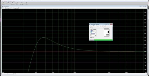

My first "Active" "SQ'ish" build attempt.
I have been back and forth on my subwoofer situation. I love my little P3D4-10 and the thought occurred to me that I could run two of these little *******. So I put the parameters into WinISD and came up with 4 vented boxes... I was thinking that box #1, 3.0 cubic feet and tuned to 28hz looks great... But there are 3 others. Based on these graphs, which looks best to you? 1 ohm - 1200 - 1500w amp so 1000w`ish is what I would throw at them.
Yeah the 3.0 @ 28hz looks best out of the 4. You wouldn't want to tune any lower than that anyway. You should try graphing 30hz to see what you get.
I did, It's not too much different than the 28... a lil more boosted from +3db to +4db and shifted right slightly, obviously. Still looks good. I think the 28hz tune would require less tuning in the 3sixty.3 in the end.

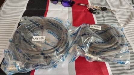

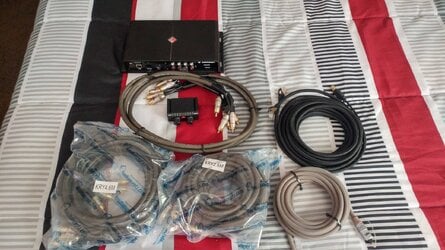

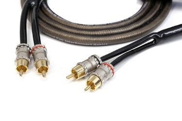

I ordered all my RCA cables... 90%on looks, I think they look great. These are for going from the source unit to the DSP. I also have short versions of the same brand, same model to go from the DSP out to the amps.
Knukonceptz Krystal RCA's

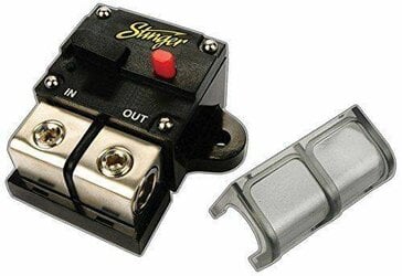

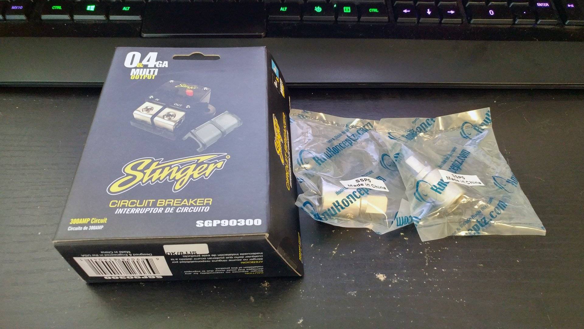

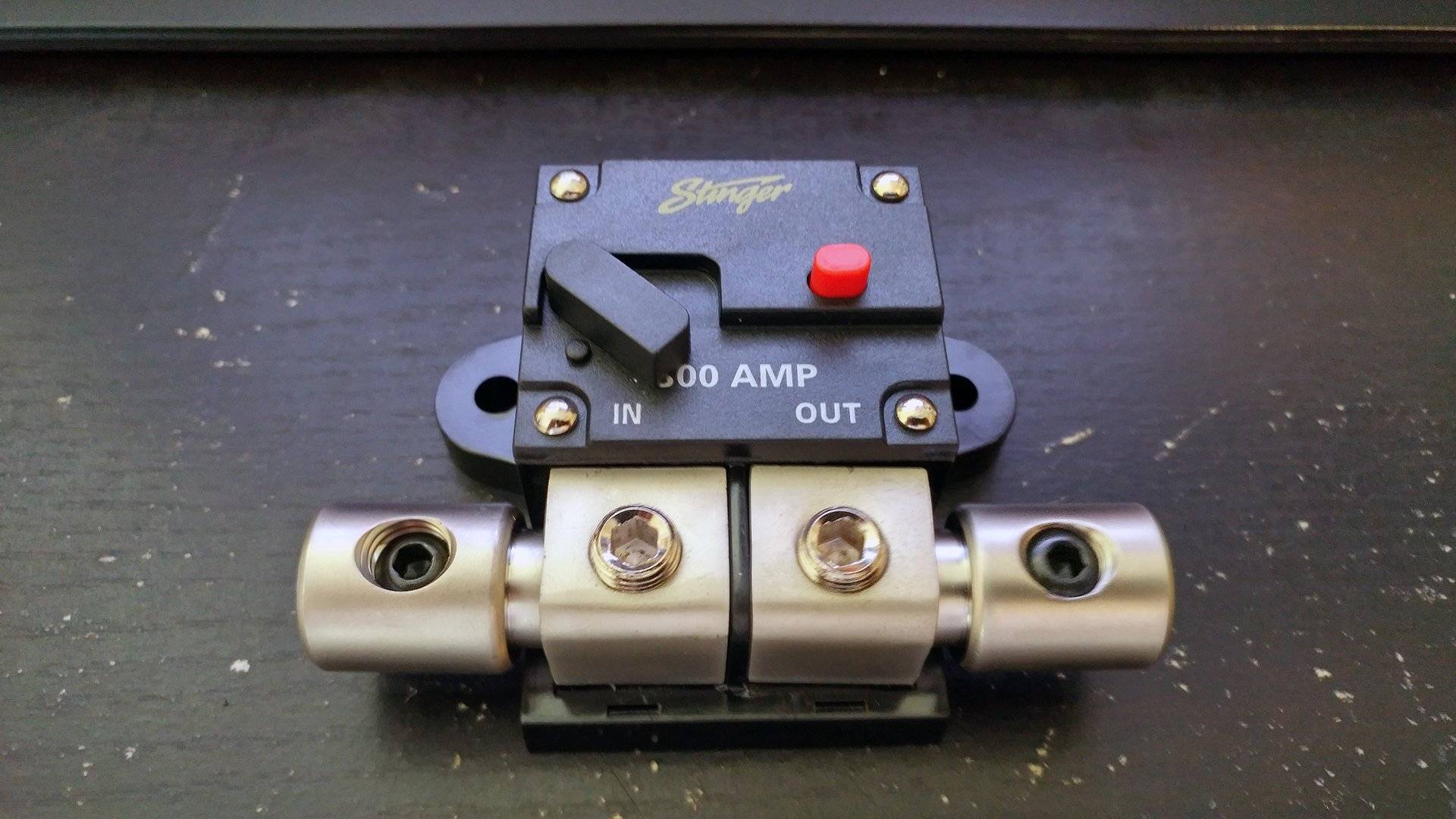

I ordered my Stinger 300a circuit breaker and some Knukonceptz 0awg - 0awg cable reducers. The "reducers" are going into the circuit breaker.

Just me... I wouldn't tune under 30hz.
Cabin gain will help the low end a ton. Idk... how low is too low?.. for some people it's never low enough I guess.
No, that is actually a good point... I keep forgetting about that cabin gain thing. I have no way to know, though, what frequencies will be boosted by cabin gain.
I understand the whole idea about flattening the response by tuning low, I'd play with volumes to flatten response in conjunction with a lowish tune.
Be careful... Larger volumes will give a peakier response irregardless and require more port area. A smaller volume may end up needing less port area but require a difficult port length if tuned to low.
Cabin gain ought to really help those lower notes anyways. I'm still unclear what type of response/goals your after.
I suppose it just depends how it models up to you and what you feel is gonna work, me? I like a punchier tune with accuracy and decent lows... not digging into the cellar.
I just want it to play sub bass frequencies (bass music occasionally) and reinforce kick drums, bass guitar, lower piano keys and the like daily on the regular. For example, when I listen to The Holly Cole Trio (Tennessee Waltz) and that upright bass kicks in... I want to feel as if I am sitting right in front of them... I want to feel the air coming off that upright bass and hear the finger plucks. I played guitar in a band for some time and I am not going for a representation of a quality recording... I know what the instruments sound like in person, that is what I want to re-create. If I hear a 18" ride bell I want it to sound like I am at Sam Ash hitting that bell, the same sound. If I hear an A power chord played through a Duncan TB4 humbucker through a Marshall TSL head and 4-12 cab... I want to be able to say yes, that is the right tone... and so on.

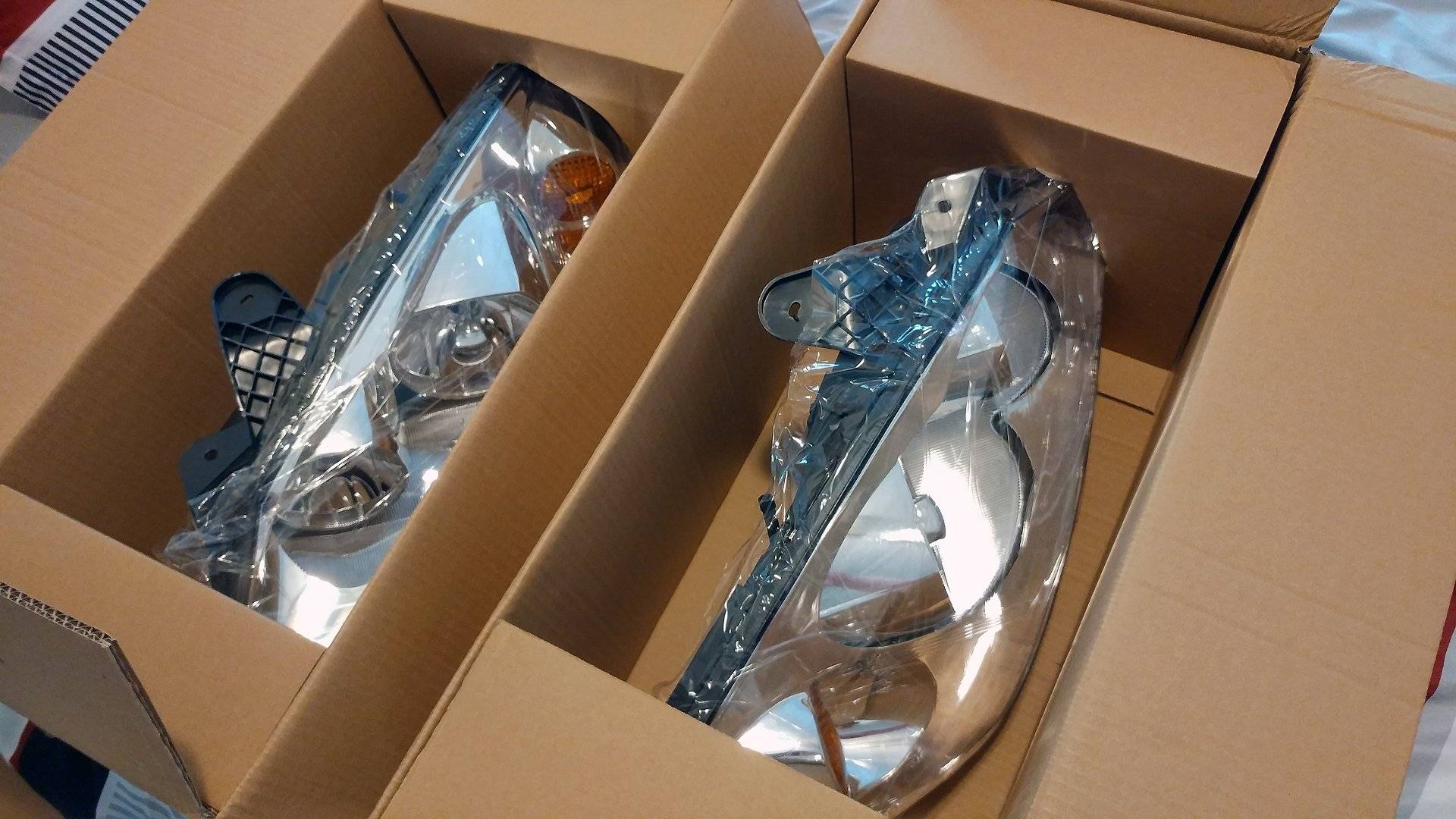

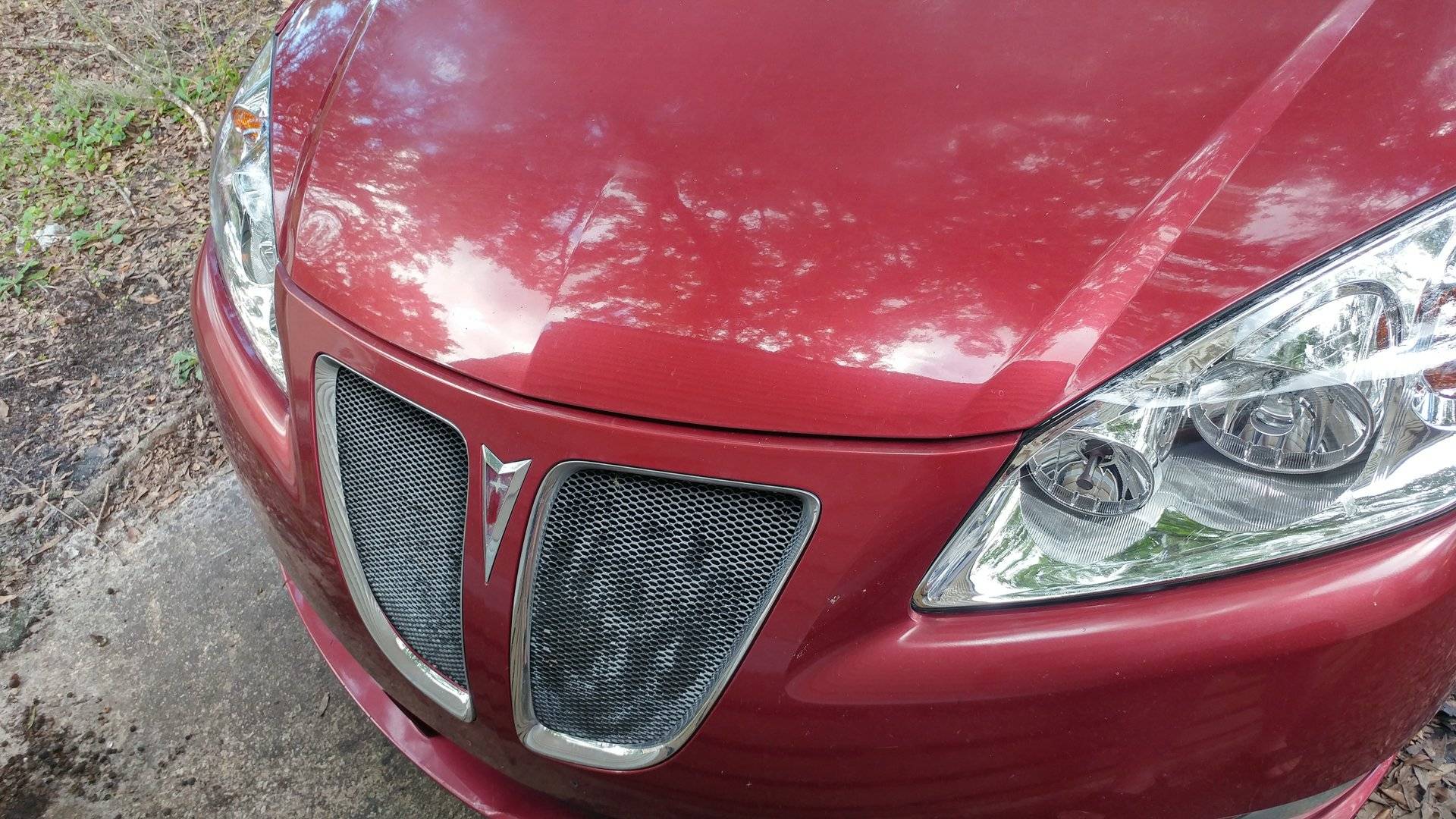

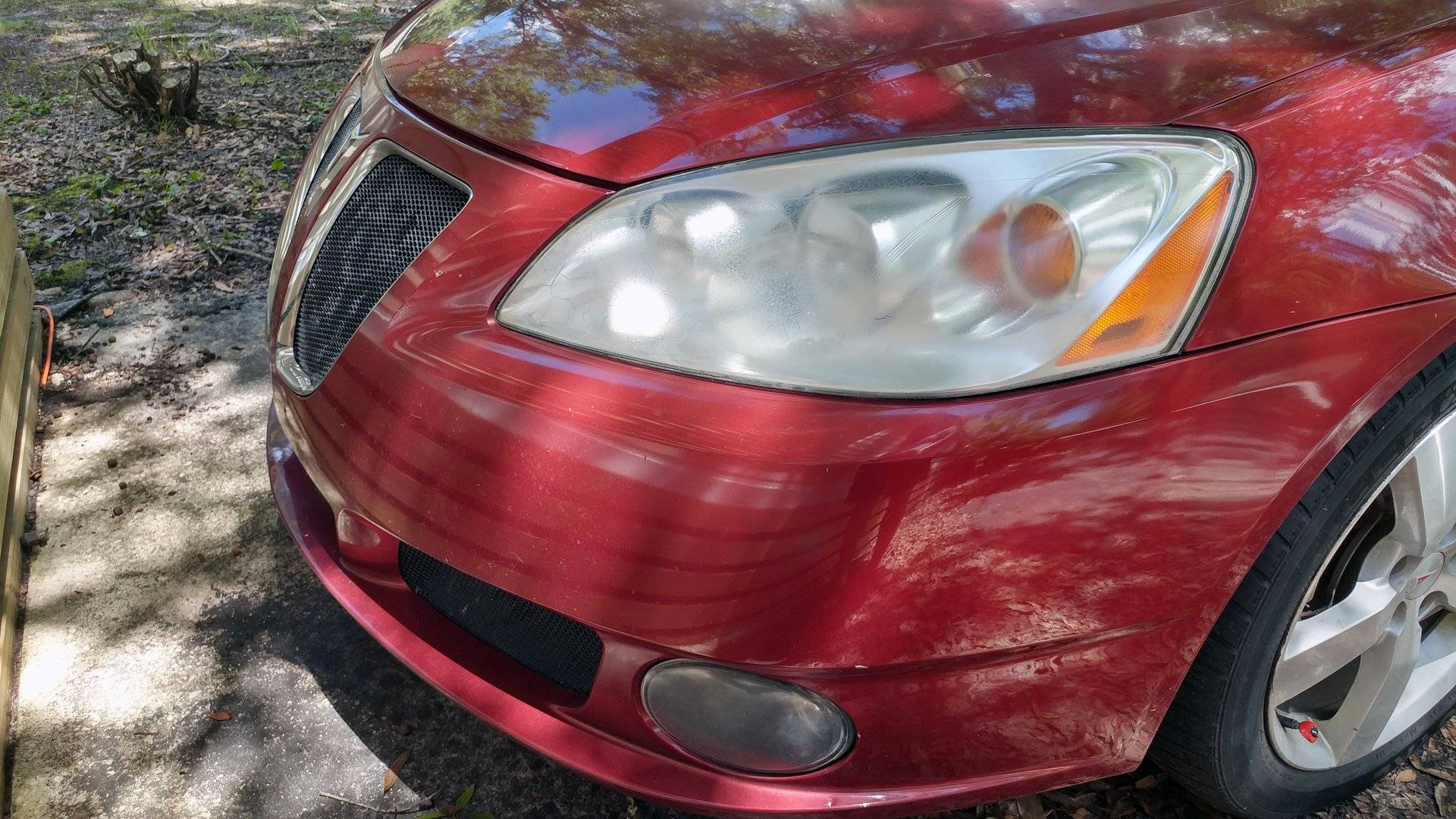

Whilst waiting for car audio related items to ship to me, these lovely gems showed up today. The G6 got new eyes!
I have been running the H11 LED Low beams in the current housings and I have the H9 LED High beam bulbs right here waiting for these new housings. I am going to swap all the bulbs over soon.

I now have the main power junction from the battery. I am going to use the 300a breaker. 1, it should blow fast if needed. 2, I can cut power to the system to work safely. 3, it looks cool.

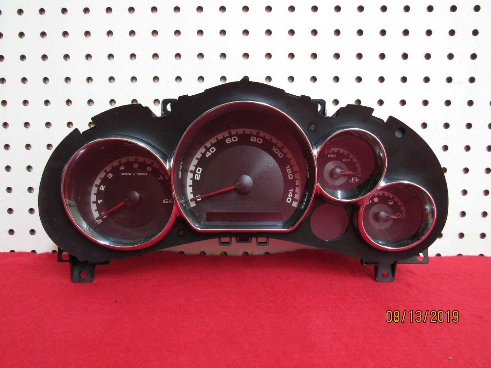

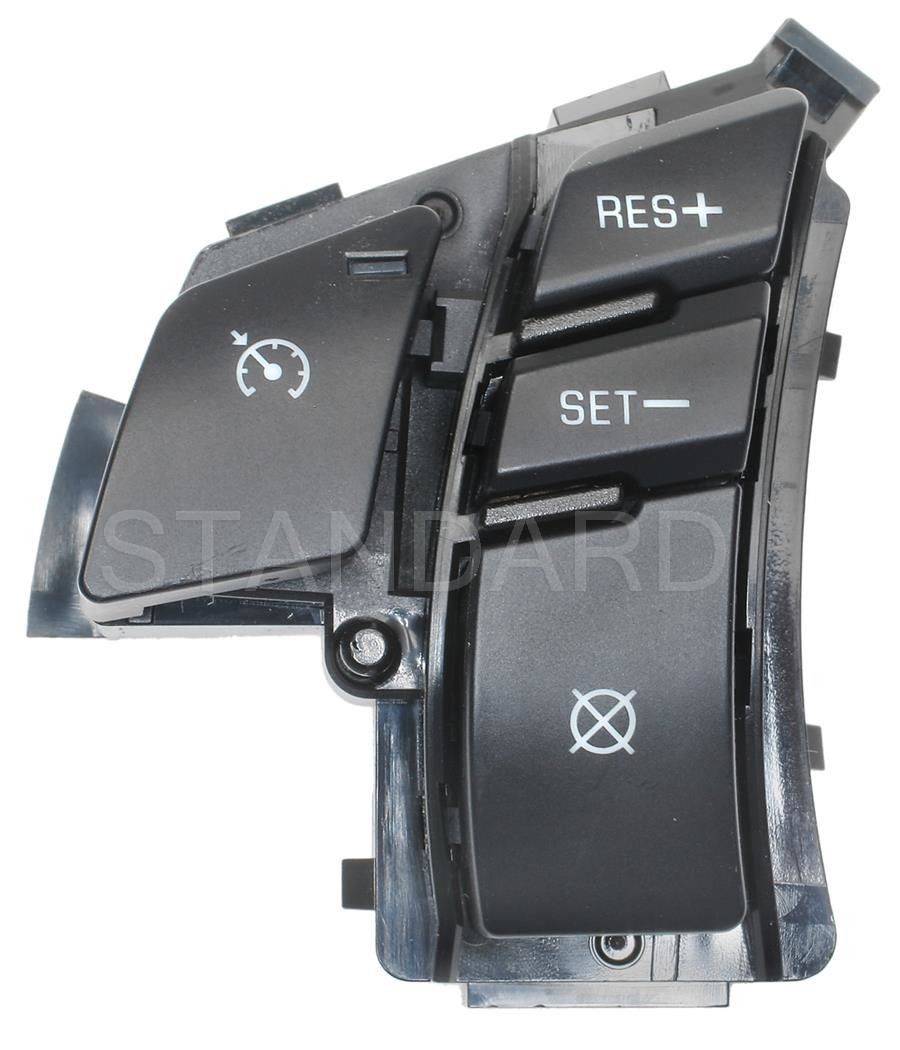

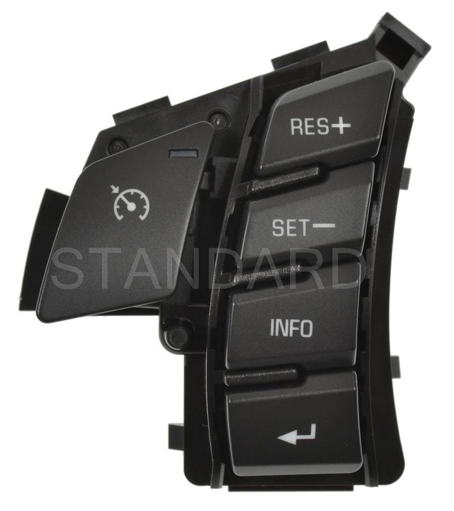

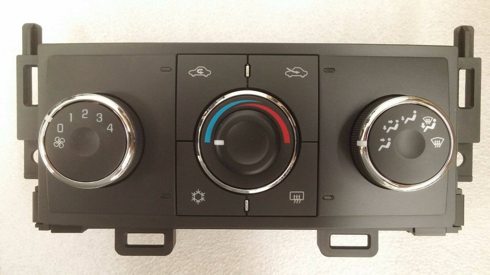

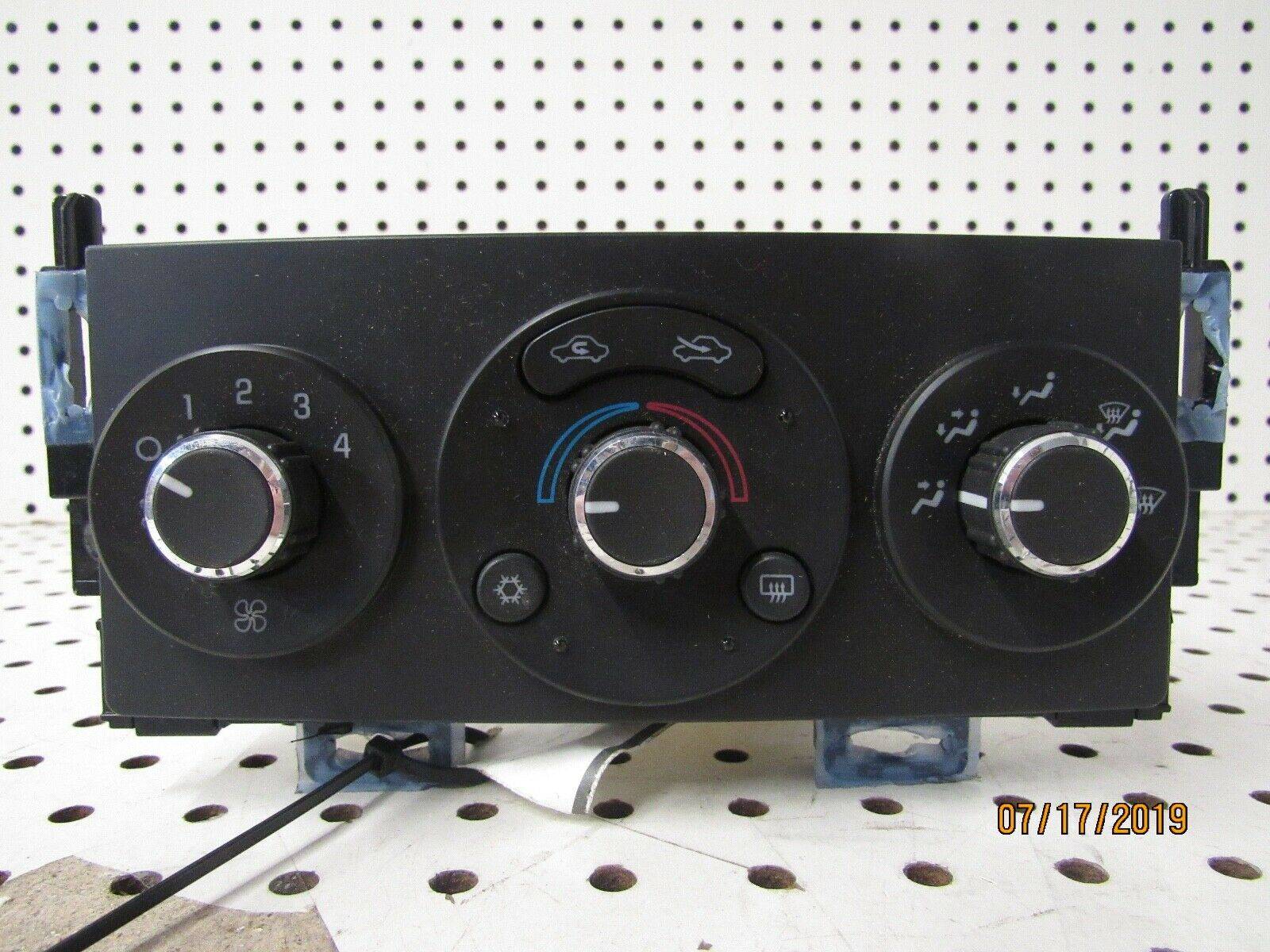

Some "progress". I Kinda have a pain in the ass car to do a stereo install in but have come across alternatives that save me money, upgrade the looks and functionality of the car and retain all my cars features. The dash kit for my car would be $299... that is just the dash kit. This is because my Vehicle Information Center in built into the factory radio. I have learned that if I swap my 2008 gauge cluster with a specific and newer model gauge cluster, swap my cruise control buttons mounted on the steering wheel and relocate one wire from one pin in the CC connector plug to another slot on the same plug, I will have moved the VIC to the dash and will be able to control it from the steering wheel. No Jerry rigging or anything. It will function just as the newer model does. I am also going to swap my climate controls... they are swappable and plug N play. I have already ordered the new Double DIN mounting kit. $9 Metra. This is gonna be fun!!! Here is what the new and old parts look like. Old first...
