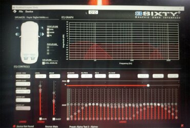

My first "Active" "SQ'ish" build attempt.
Made an overlay of all three drivers.

I have not one piece of sound dampening on my doors. None. After last nights readjustments, I am starting to get some noticeable midbass when the sub is muted. In fact, I played with it for a while with the sub off. I think sound dampening material would help tremendously with these SilverFlute speakers however, I don't think they are ideal for being in a door... something is just off about the sound they produce. They respond very very well to small EQ adjustments and their tone changes instantly but something seems odd about them. I will sound dampen the door eventually and see if that helps cure the weirdness that I can't put my finger on or if I will need a different type of cone.
What I am used to is an active set of near field studio monitors, literally 2.5ft away from me with an active servo subwoofer down on the floor and all I play is Hires audio through them. If I could get my doors to come close to the punch my monitors put out using 5.25" woofers with the 6.5" woofers the car has, I would be impressed and very satisfied.

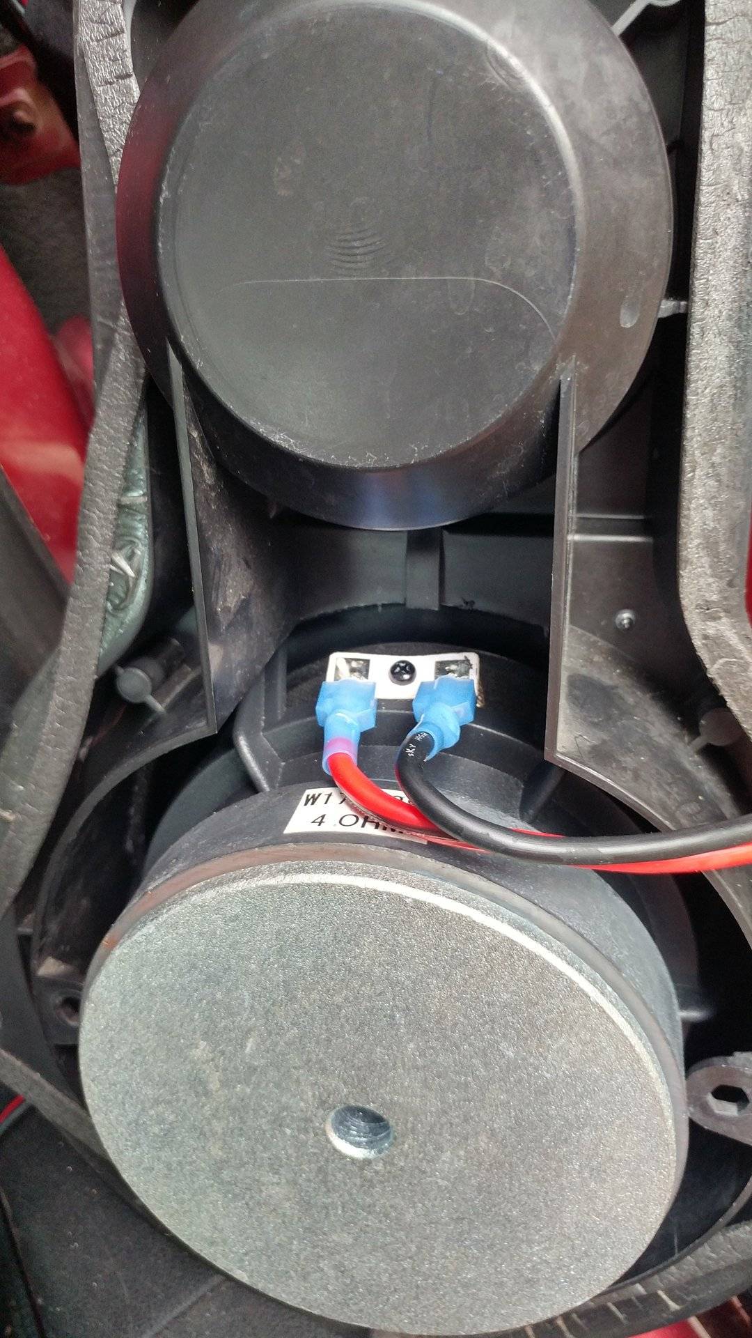

My right door mid has apparently been messing up since day one, no clue what the issue is anymore as it seems to have fixed itself. I thought I cut corners and didn't use spade connectors on its terminals. I did though.
Dig this, I have to disconnect my Alpine tweeter to remove the door panel so I decided to hook up my DD 2.75" to the tweeter channel at the door... I could barely hear it at the tweeters power level and crossover setting until I cranked that *****. It will play above 4Khz that's for sure lol. I wouldn't do that to the poor lil guy though. I bet if I take the 6.5" down to 700hz and the 2.75" down to 700hz and up... I wouldn't really "need" the tweet. As soon as I order the US Acoustics Wendy, I will run the 3-Way active.
