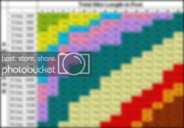

Need to match the wire/length rating if your wanting to fuse. Just did mine and everyone reminded me it isn't necessary, but if you want you need to match the length/wire.
Here.
