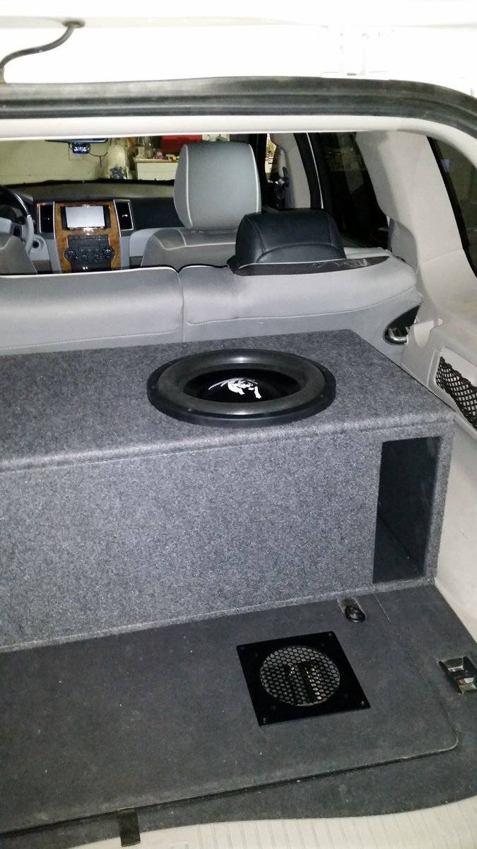

i received mine last week....
Looks nice... how does that Brahma sound in there?

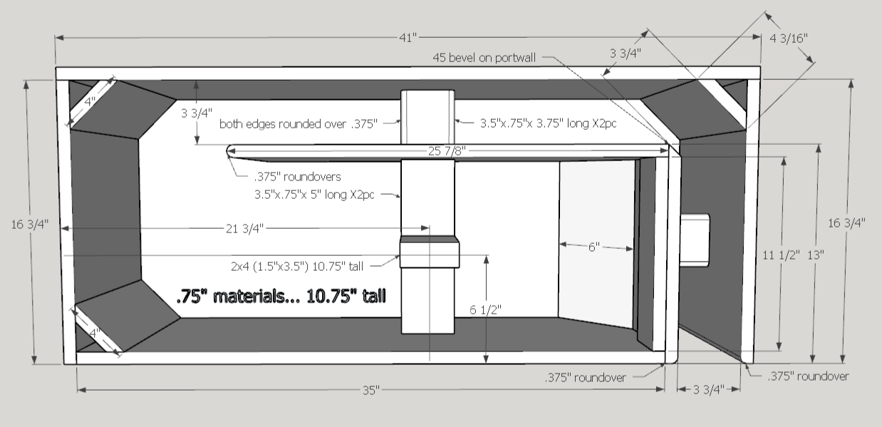

beautiful....box is your design(Fi SSD), but the guy i had build it for me f*cked up on port length, ended up being 26hz tune instead of 30hz, but i think it worked out better at 26hz, i might throw some 2x4's in to bring it up a bit...but overall more than satisfied....almost too loud for me at times
i dunno its kinda hard for me to get in there and actually measure it, but using a tone generator there is pretty much no cone movement at around 26hz.... he used different bracing pieces,but i wouldnt think those would not displace enough volume to effect it that much....something aint according to plans...but i like it so far so thats all that matters
Did you test the tune with the SSD?
Was it already broken-in?
I'm thinking that if any volume was gained with different bracing and a loosened-up sub was used... it would lower the tune noticeably.
Ah crap... I'll quit cutting-up the corpse so to speak... as long as you're pleased
tested with SSD and Brahma both same result.... 26ish
extremely different suspension between the two subs...Fi after a year is still extremely tight, Brahma brand new was as loose as my wifes *******
It was a system from 2 vehicles ago. The enclosure was rock solid. Had a P9 combo to deal with whatever equalization was going to be required.
