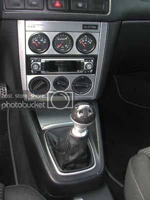

Not sure if you have your heart set on a 12 but if you stepped it down to a 10 you could hide your sub under the floor board so you still have your trunk. I own a suby and plan on doing this soon. But as far as your setup goes it looks solid! Also Not sure if you have gauges for your track days, but with a single din head unit you would be able to put 3 gauges just above or below the head unit.

I know this photo is of a vw but you get the idea.

I do have gauges. I have the clock pod, and the gauges turned (needles up=ok, anything else=oh ****.) I really would not mind a ten, and I had not considered putting it under the seat mostly because I assume it will be a pita to remove.
