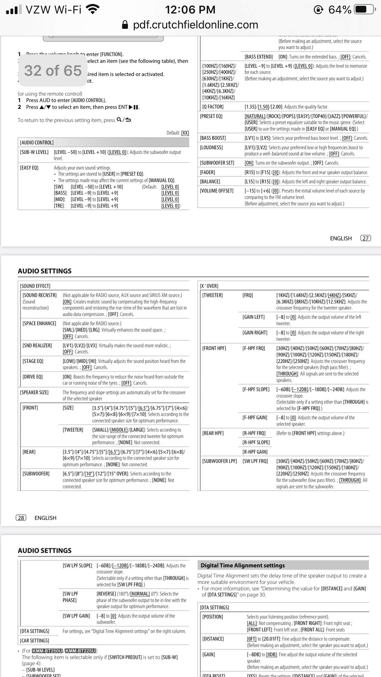

- that deck is pretty good. I had it in my first 4Runner. I thinnnnk it has active feature, pulled this from the manual. I could be wrong.
23140
A Focus on front stage (Ditch rear speakers Monday drain) with Active with your type x’s (Ditch passive crossovers) or even using passive crossover in regular Component mode will yield positive results in sound result.Also, in an active scenario with tweeters And mids driven on separate amp channels or the Comp set bridged on a 4 channel should contribute to an improved result. Work that 13band eq for that Desired range but enable it first with control ability and powah

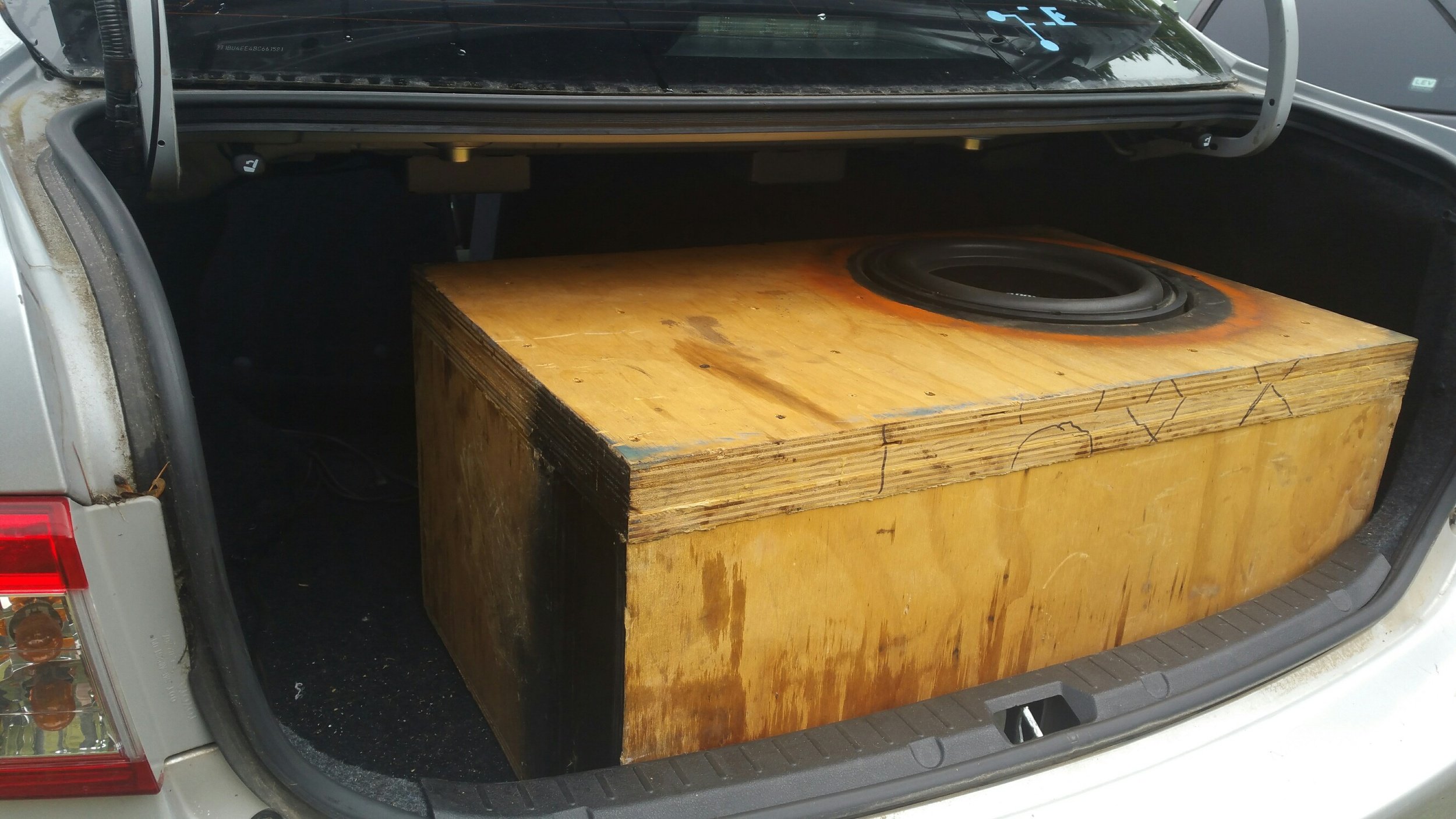

Should be easy enough to get a tape measure and do some double checking on the volume, port area and port depth. DD subs sound good/get loud in the "DD Box" (see DD website). Those ratios work well for most subs that are high motor force and highly damped (stiff suspension). It'll sound really punchy for your rock music and similar. You should really like it. The big caveat being I've had mixed results crowding stuff into trunks. Trunks are notoriously hard to get big sound out of in general and often a smaller box that leaves room for the sound wave to get up front will outperform a bigger box that is wedged in super tight. Trunks are also super finicky with box position and sub/port aiming. Moving things around just a little bit or changing orientation of something will usually make a dramatic change in frequency response and overall output.
This box is about 3 cube net and works pretty well as it sits in the trunk of my Corolla. Box was originally used in my old Jeep and I was doing 148 and high change dB with it and it plays music well enough. Subs I use perform very similar to DD "power tuned" type. Anyway, the takeaway here is there's plenty of room for the sound waves to get up front and there's more than a port width distance in front of the port so that can function as intended.
