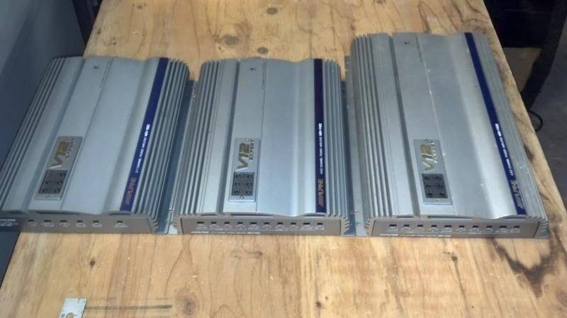

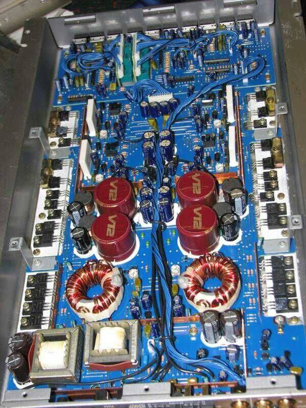

Alpine - the 1996 MRV series is an excellent amp choice. A MRV-F405, MRV-F505, and MRV-1505 are all Japan made with awesome internals, close to F#1. I ran these for a bit with the Hertz Mille's and they did awesome. I still have the F405. Active capable amps with flexible crossovers.

Is this the alpine line you are talking about?
no.
this: MRV-1005, MRV-F405,& MRF-F505 (left to right, top pic). the MRV-1505 is not pictured but is a 2 channel the size of the F505.
