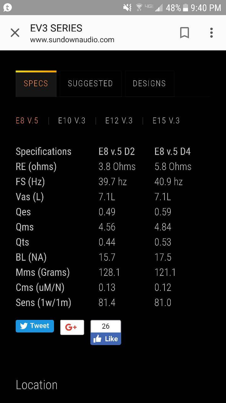

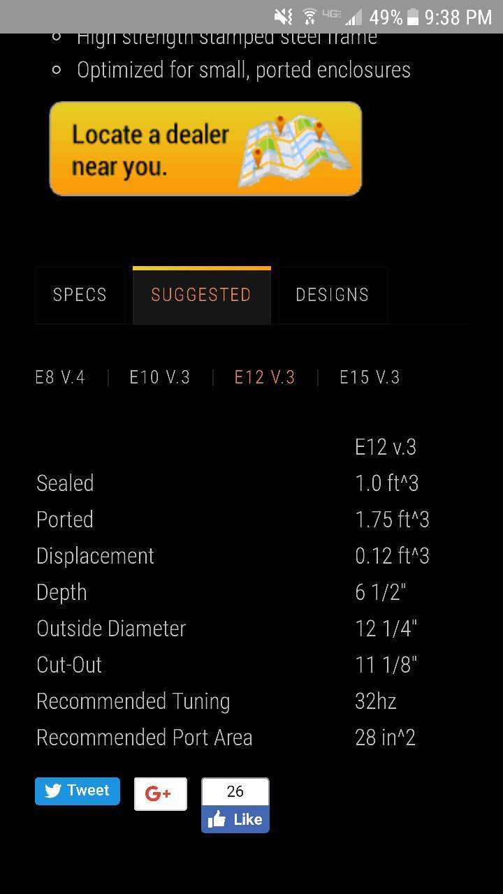

I'm not in any groups. I was thinking about ordering one off eBay. What does all the stuff in the pictures mean

I can go as big as i want really,. But my max area i want to dedicate to it is, 36w x 15t x 15d. Single 12 dvc 4ohm wired to 2ohm with 800watts...
