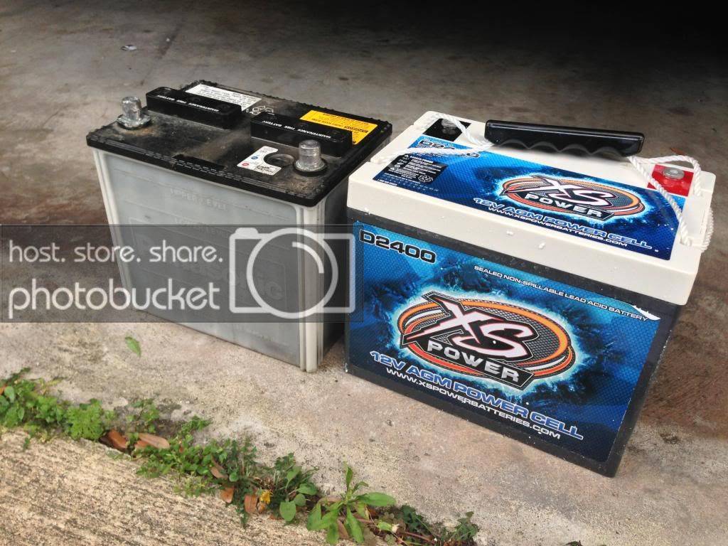

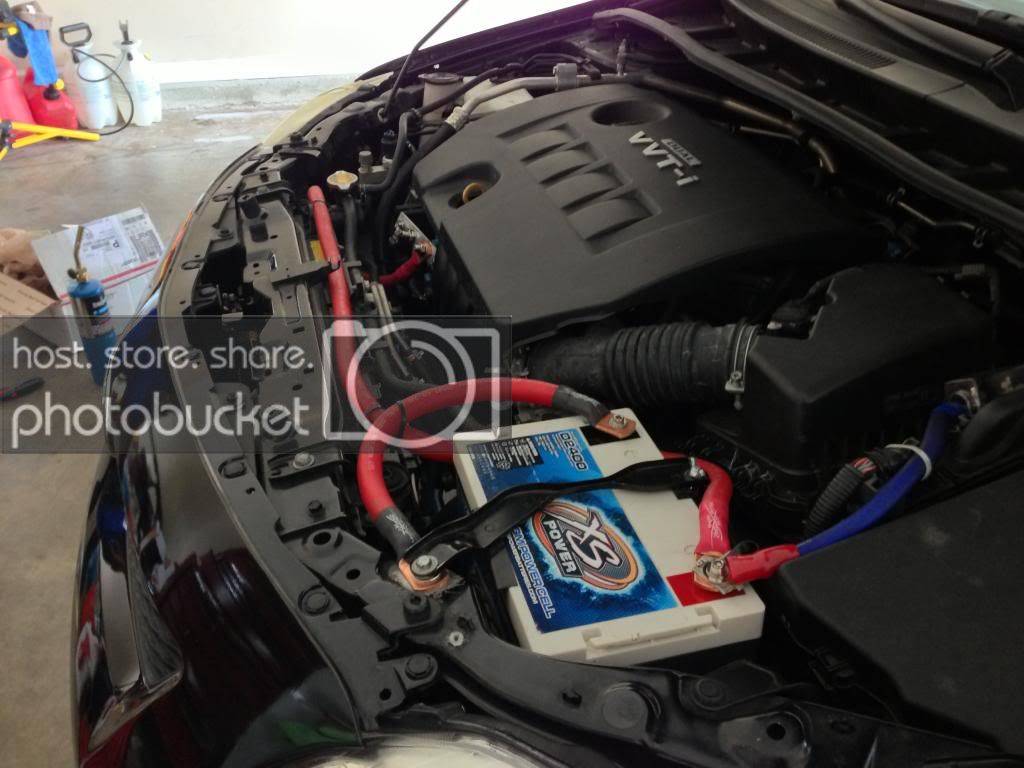

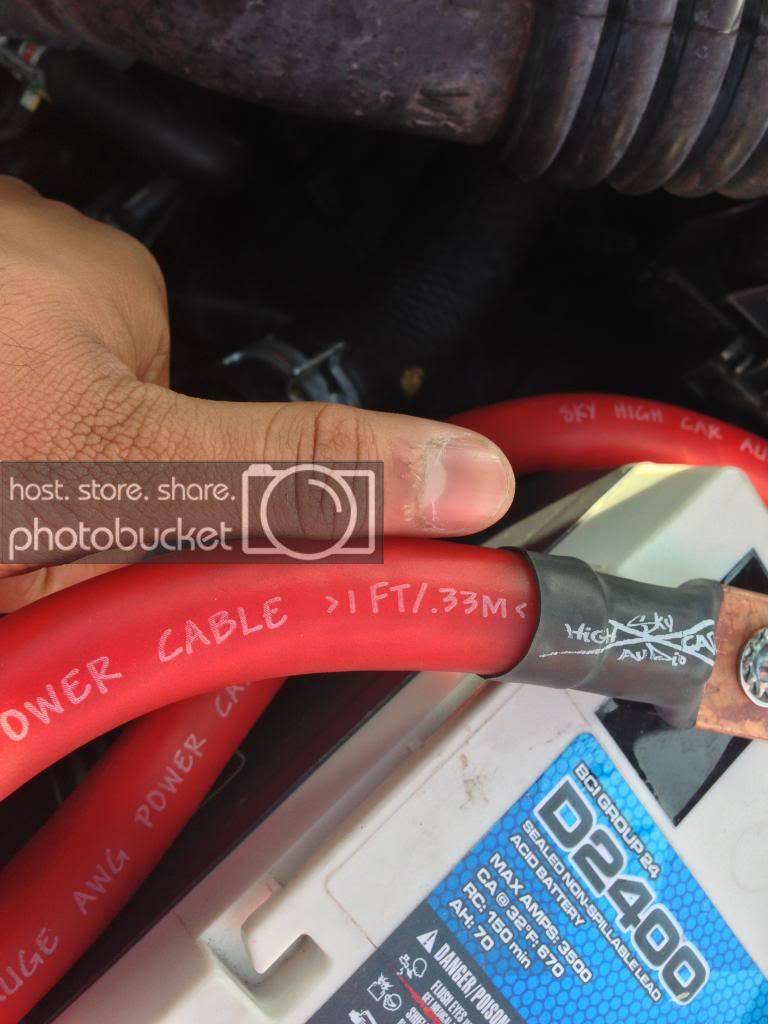

Front Battery: XS Power D2400

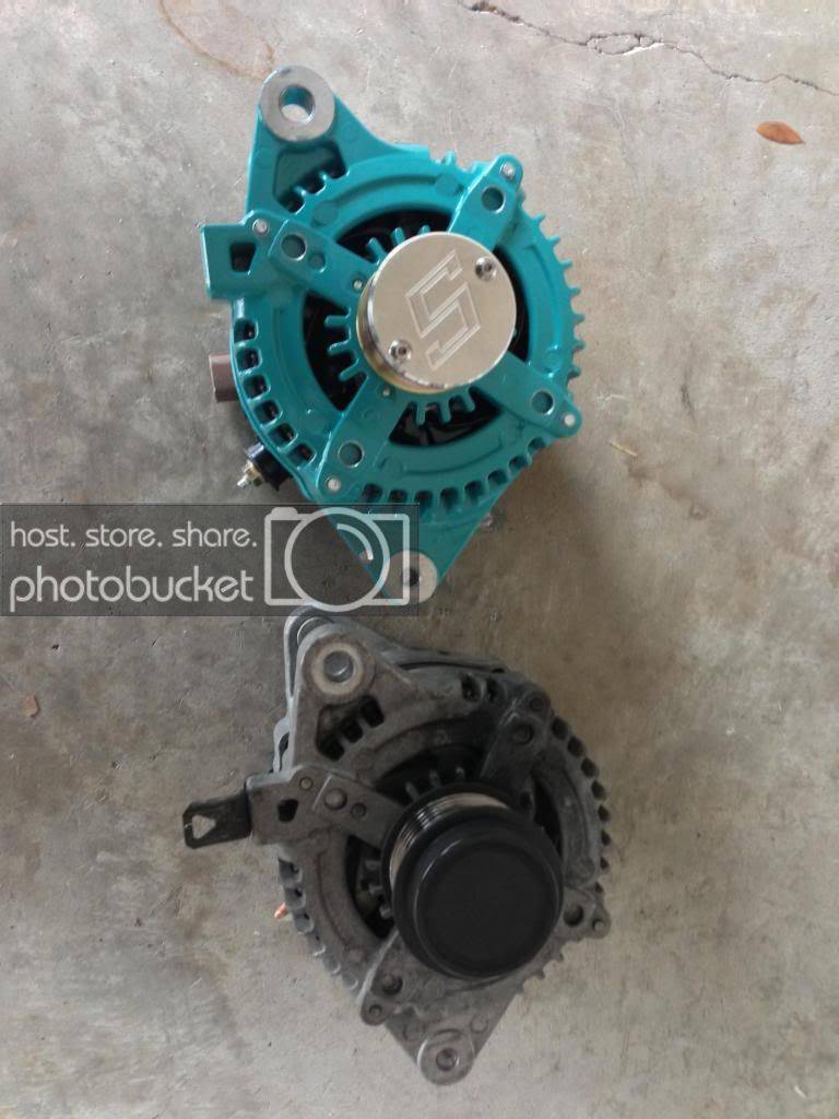

Alternator: Singer 310A

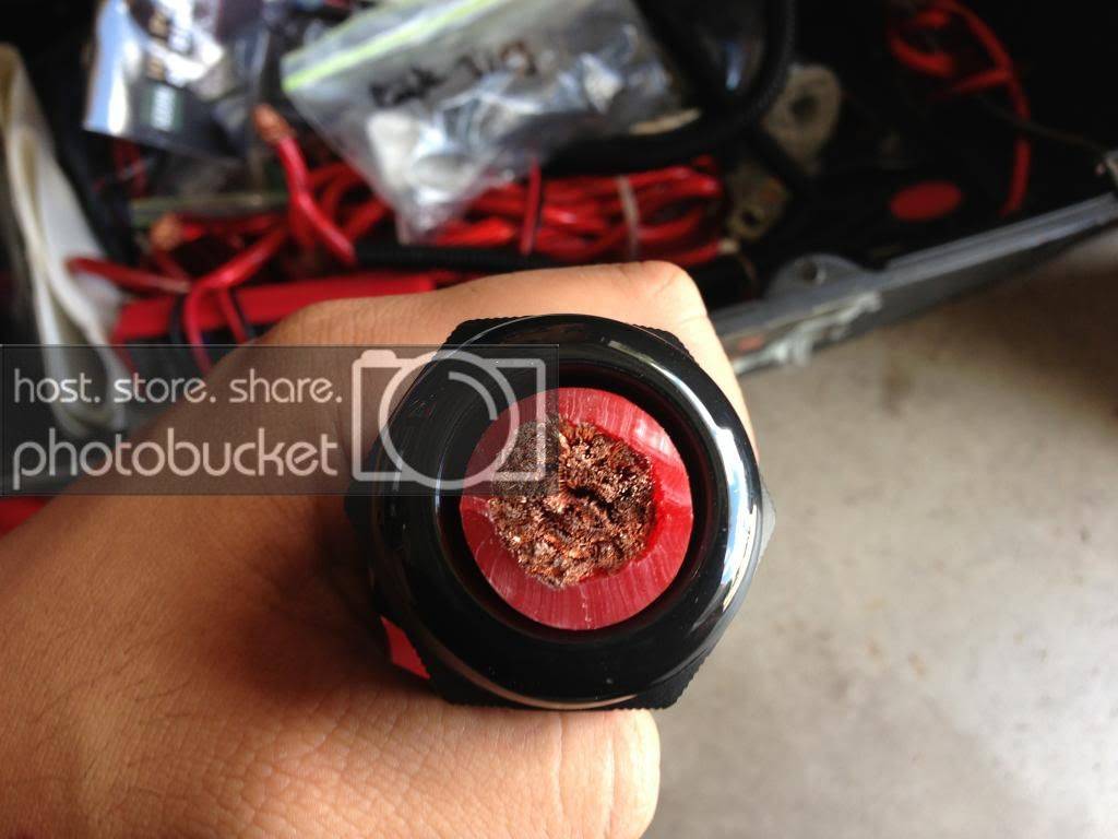

Wires: Sky High Car Audio 2/0 OFC (Garden Hose According to Jeremy)

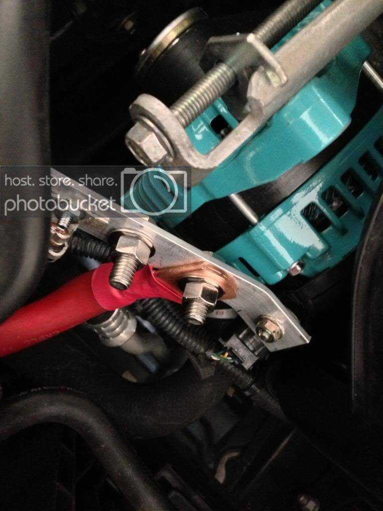

Here it is after I've installed them and the "big 3" with Jeremy and his crimpers.
The only problem that I do have -well kind of- is that I need a better buss bar than this for my alternator. (So I need to get a better one soon).

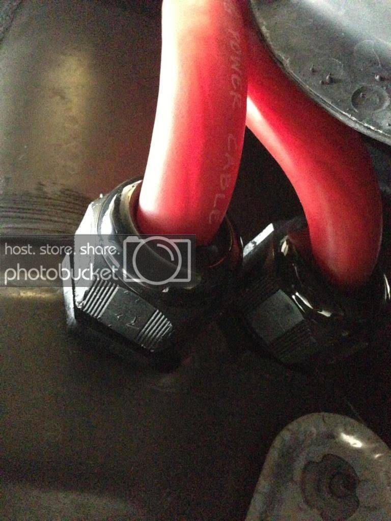

Grommets are bulky enough for me to use as a club just incase somebody wants to mess with me.

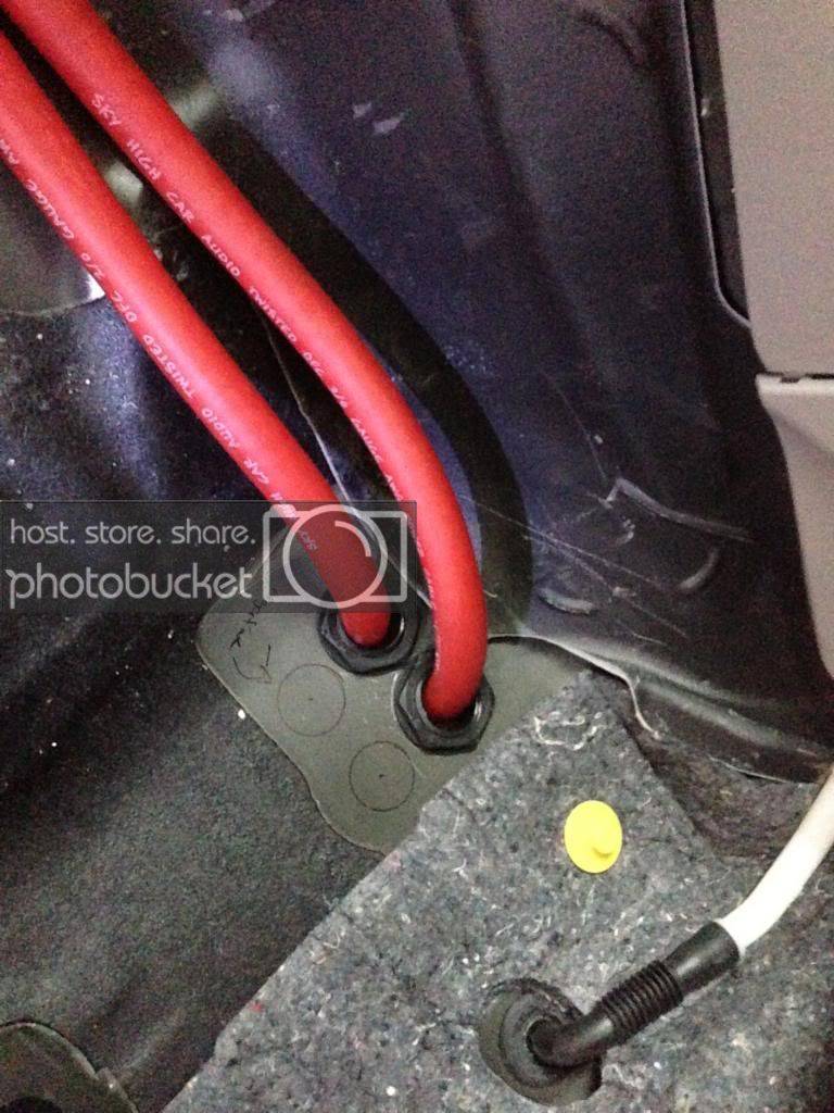

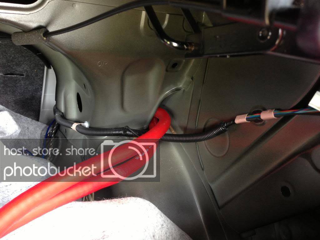

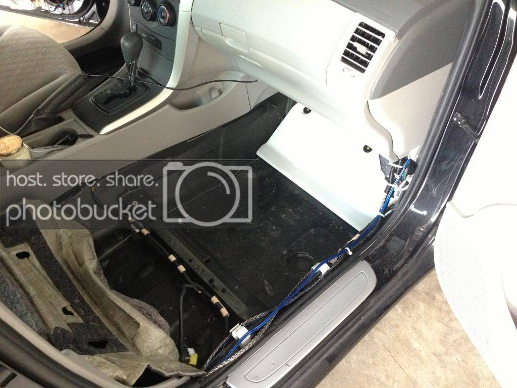

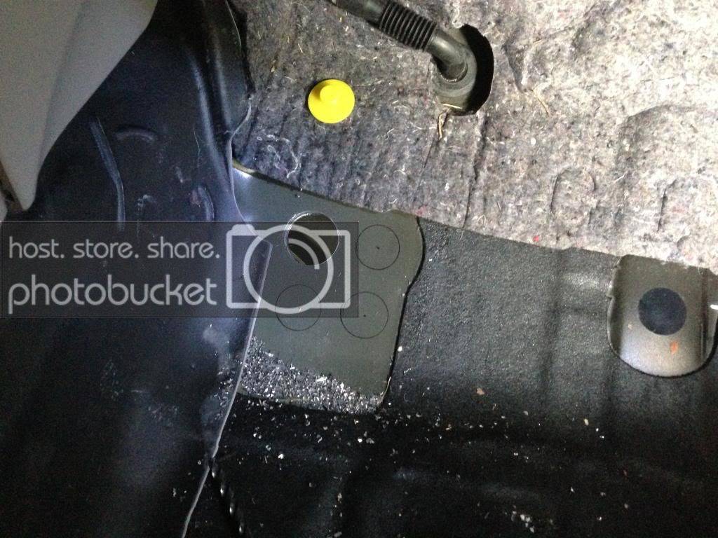

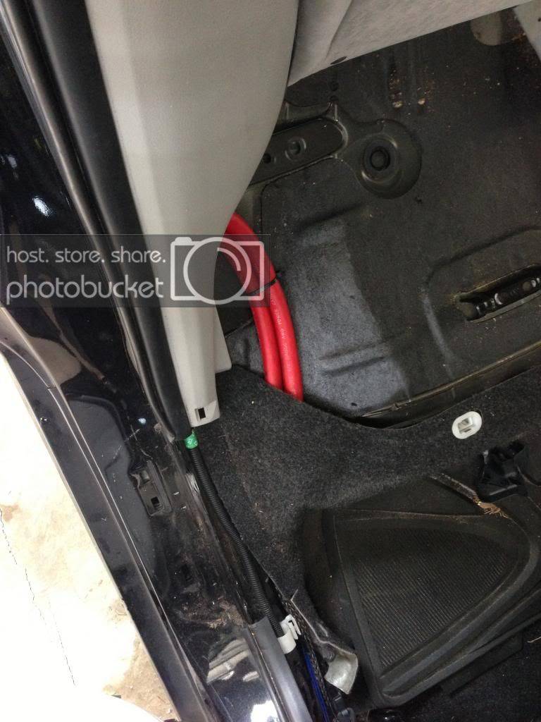

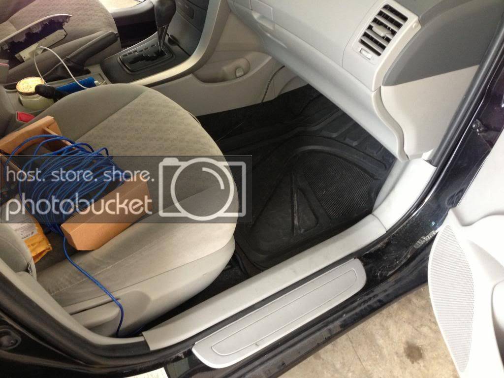

I have 2 runs of 2/0 inside the car to the trunk.
I must say for a couple of amateurs we didn't do that bad at all.
Going into the trunk:
Pretty clean. We're impressed ourselves on how it turned out.

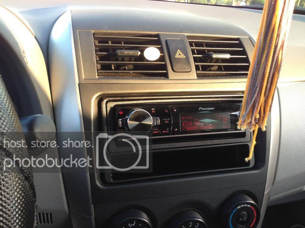

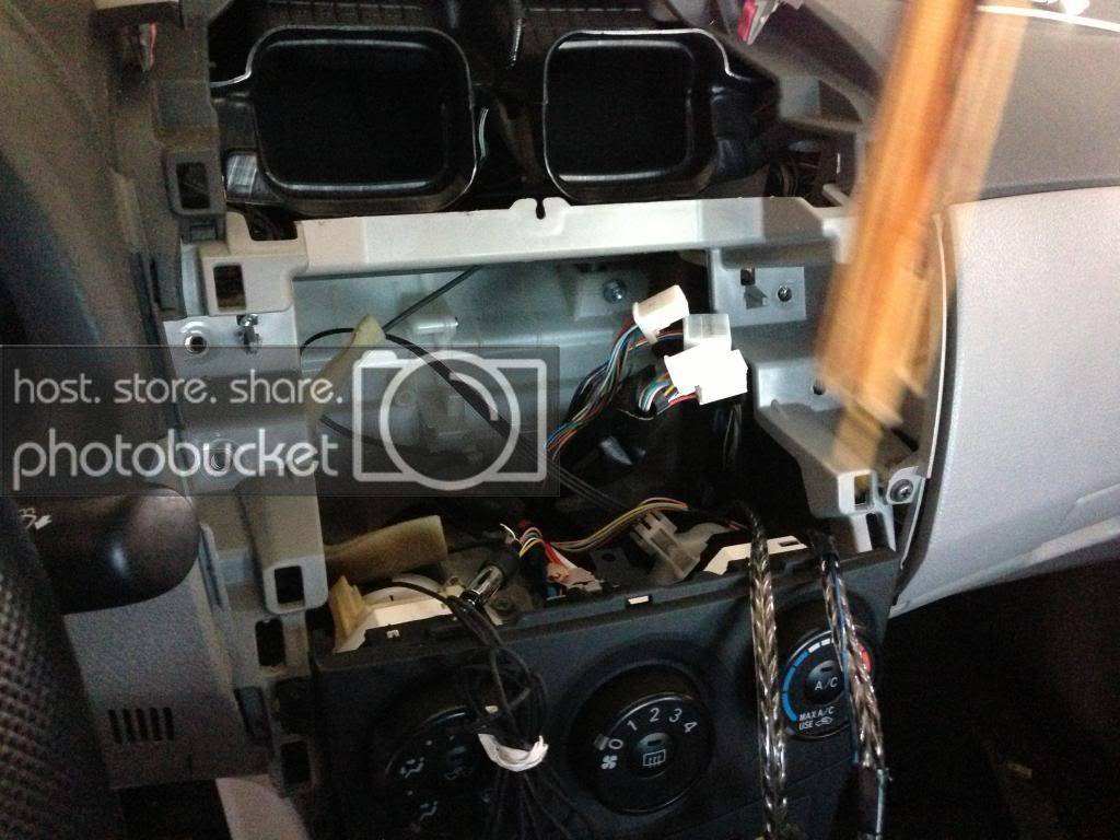

Now let's go into the head unit.

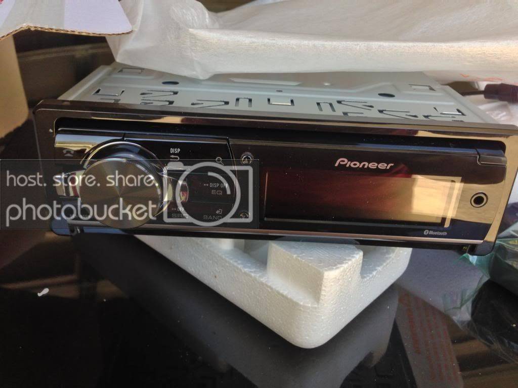

My choice is Pioneer 80prs.

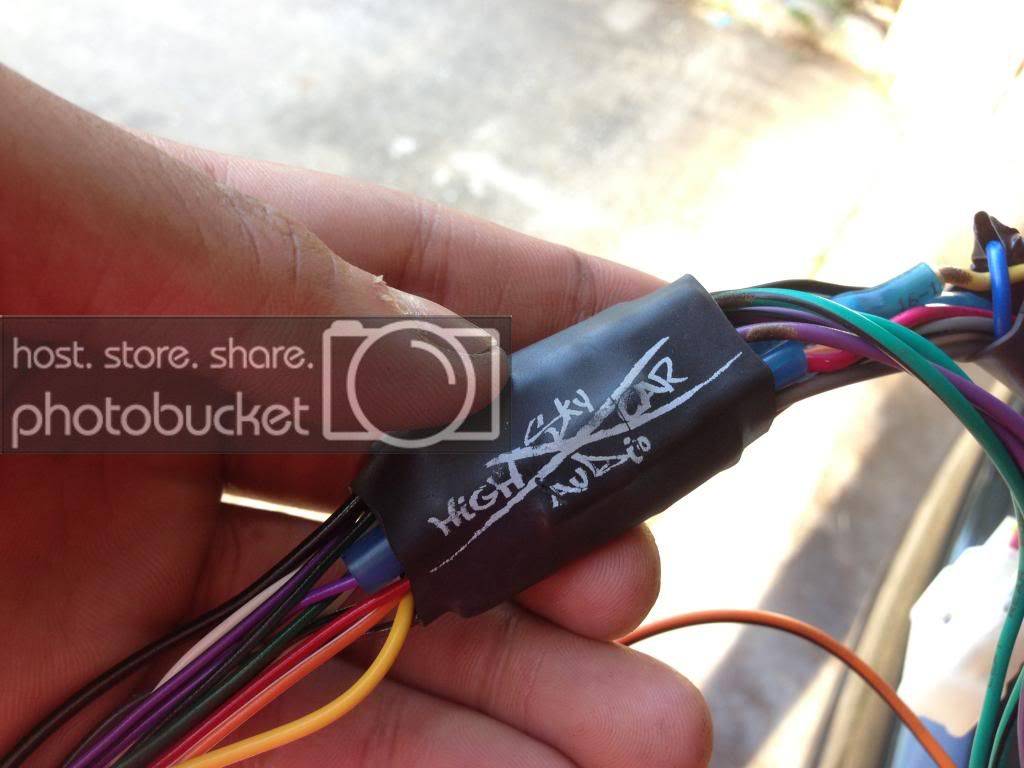

Heat shrunk some wires together with some extra heat shrinks for clean wiring.
It's in looking purdddyyyyy:

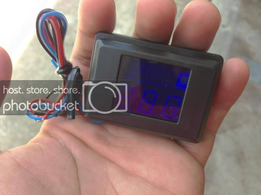

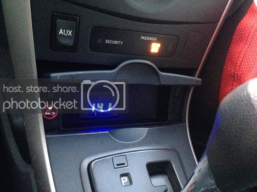

Volt meter, can't forget about that. I'm going to have 2 volt meters 1 front battery. The second the back bank.
Jeremy and I (well mostly him lol) made a wedge panel to mount the volt meters on to give it a OEM look.

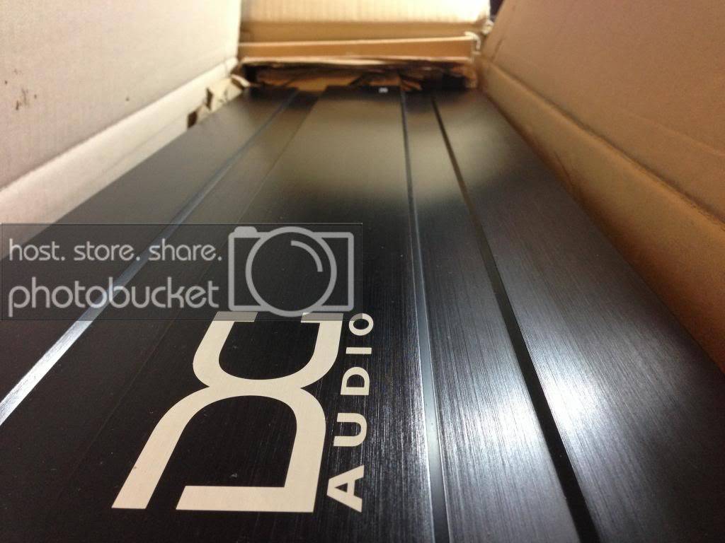

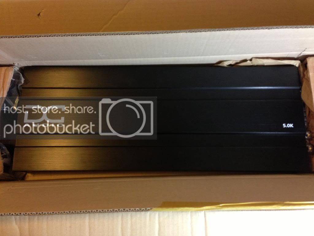

Now my amp of choice:
Big thanks to Jason for selling me his DC 5k.:grin:

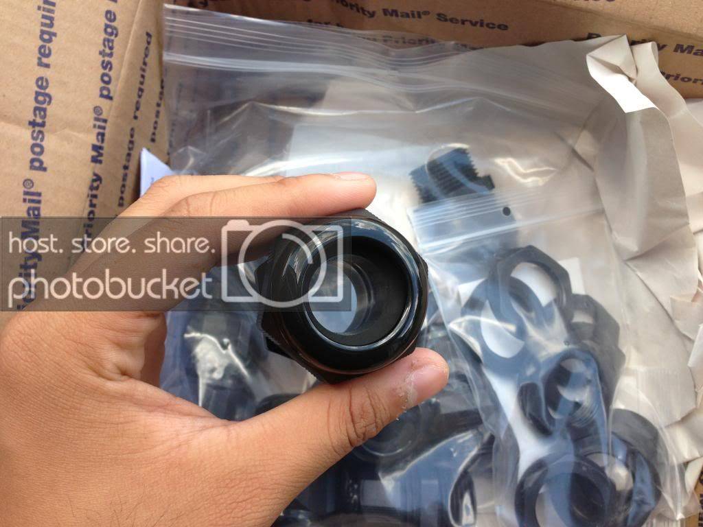

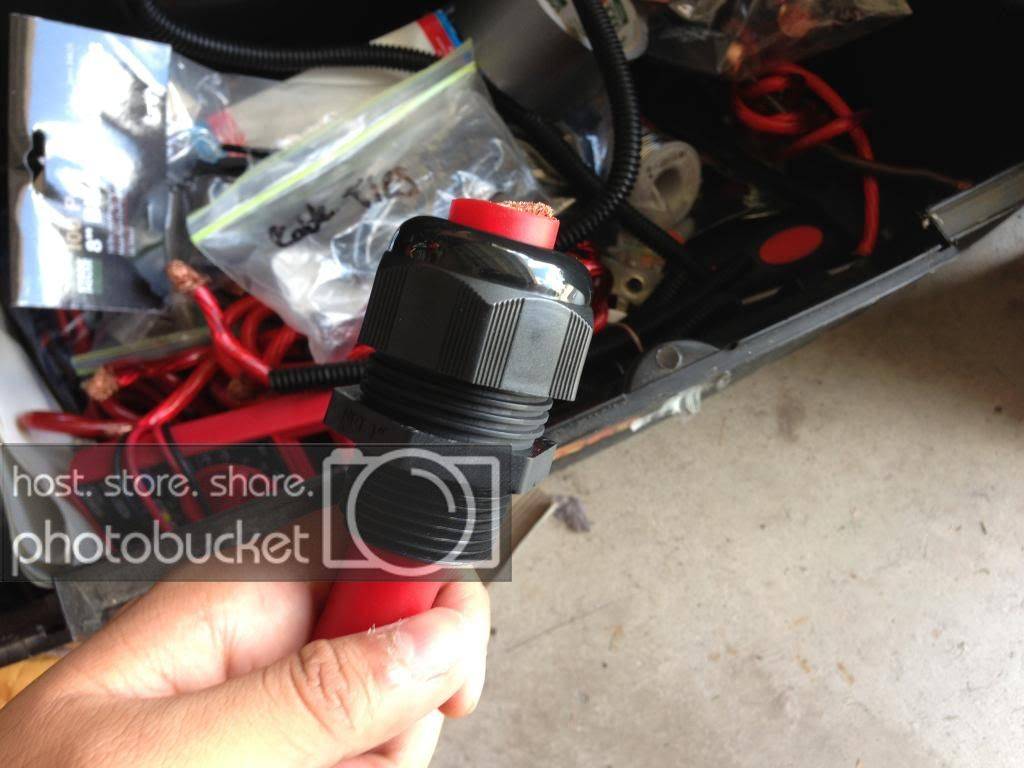

i first saw post then your pic. for a second i thought you were doingthe real chris browns build, ha. im curious where you got those groments for wire? is tgat what people use when doing a ground thats directly to the frame. or is that a firewall groment? are they the same thing?
Maybe you should wait until I'm progressing through the build and see..
I only had 50feet of wire used.
As you can see from the picture where we ran the wires, there's a circle made for a ground.
I got the grommets from Electdirect I think.
It's a firewall grommet.
