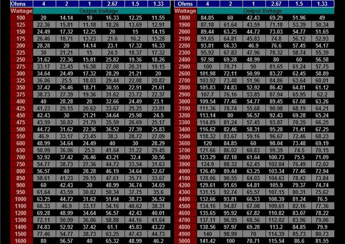

I'm trying to set my gain on my amp to get an idea of where I should set my gain.
I'm running a 12 inch HD D2 American Bass to 1 ohm at 2000 watts. When I'm doing the calculations do I use my woofer ohm or the amp ohm? Like does my amp output need to be 2000 x 1 then square of that or do I do 2000 x 2 for the square root of 4000. I have it set at 63v which I think it should be 44v. Thanks for any help

Where did you come up with 2000x2 then sq rt of that?
It should be set to 44.7v
You mulitply the nominal ohm load by the desired wattage you intend to run.
63v is clipping the fuck out of your signal because you're trying to pull 4k out of a 2k amp. You will blow your **** quick at the level you are set at.
Save this chart for reference
17878
2000 was my amp watts, and the 2 was my speakers resistance. Then I took the square root of 4000 for the 63v, which was because originally I thought I was supposed to go by my speakers resistance (which is 2 ohm), so I set it to output 63v, which I guess now from what you're saying I need to go buy what im running it at which would be 1 ohm and set to 44v.
Thats all I needed to know, I wasn't sure if I was supposed to go by my speakers resistance of 2 ohm or what im running it at on the amp at 1 ohm. I need a bigger amp lol.
