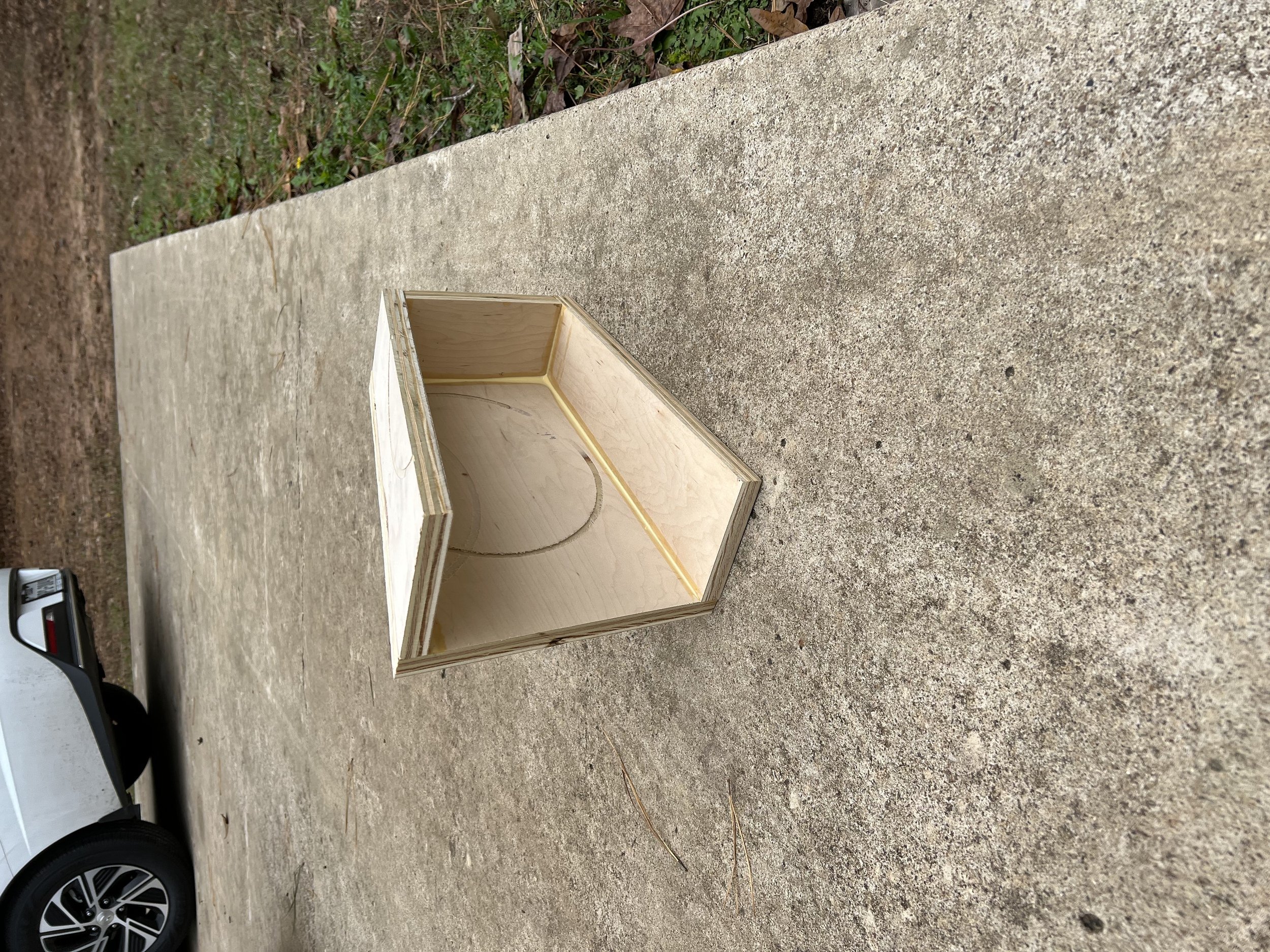

I just need to know how many inches from the port you’re thinking of to start, and if it flares out, to how many inches, and I can build one just for the hell of it. I have plenty of scrap wood.

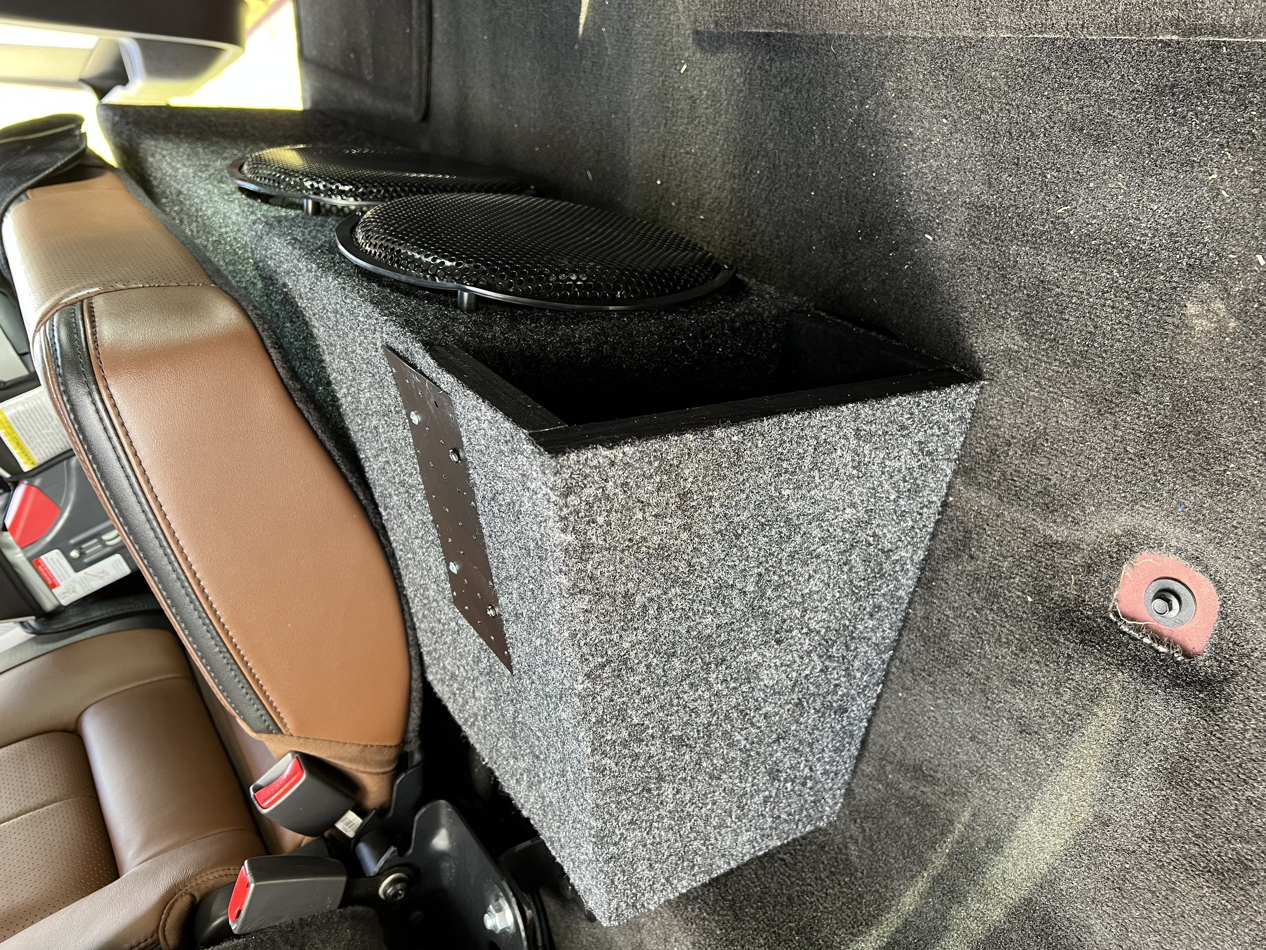

Built and installed the “loading port.” It actually sounds really good and is a little louder now. @Buck suggested I make it 3.125” at the back and I flared it out to 4.5” at the front.

So what's it tuned to now 20hz, or as I previously stated was it not designed and built correctly the first time?
It’s called having fun, and playing with sound, and experimenting with different audio things to see what improvements can be made. Almost any system has room for improvements, and doing stuff like this on the forum helps everyone learn. All he’s doing is experimenting. If you rid yourself of some of that hate you carry, you might learn how to have fun.
Also, if knew about sound, you’d know the strange acoustical properties of pickup trucks and how sometimes the smallest things or changes in orientation can change the sound. I advised OP on the flare some, and he’s just messing around with it, and just experimenting with how he can get it to sound, seeing what it does, because it’s fun, unlike you.
