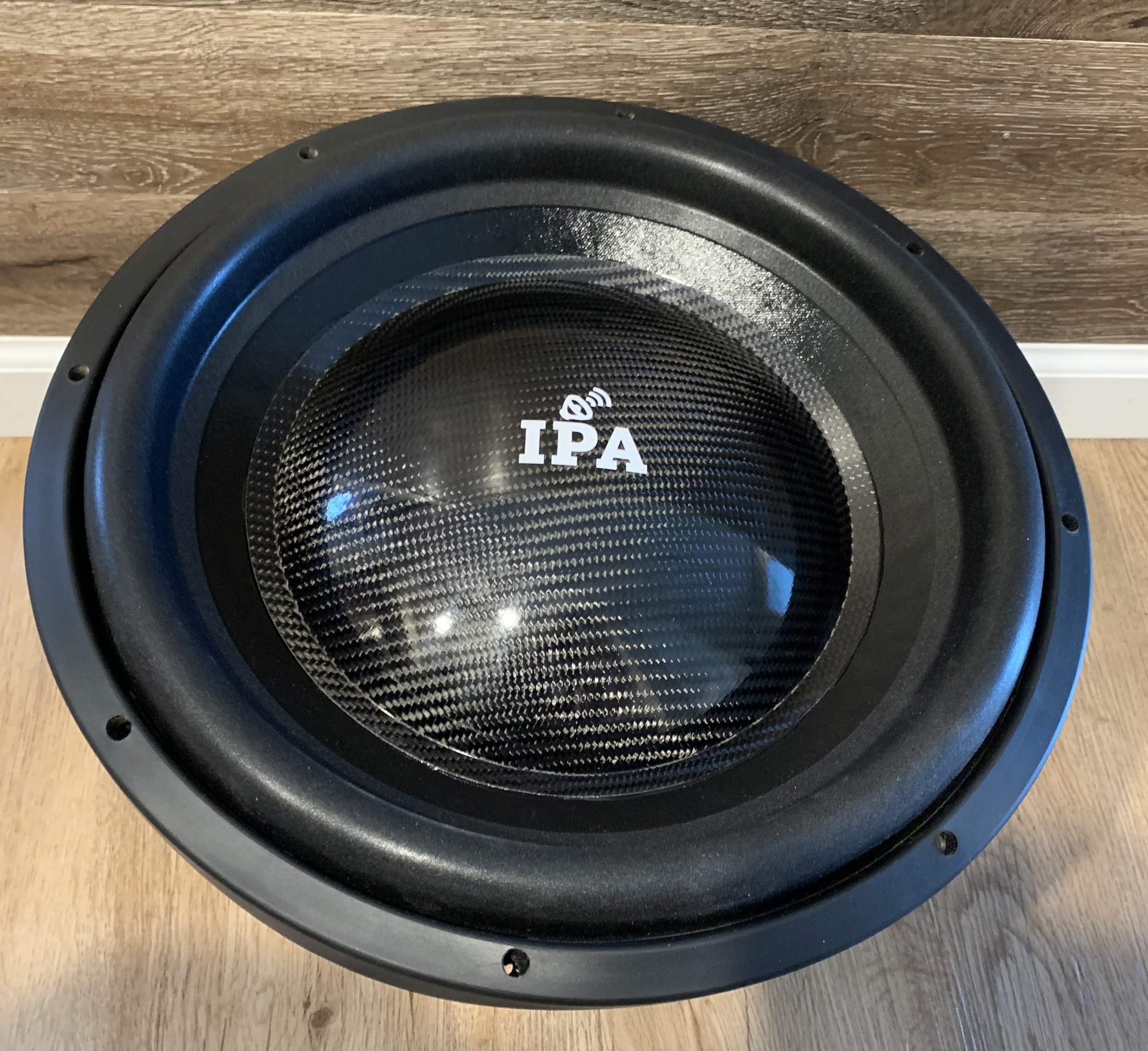

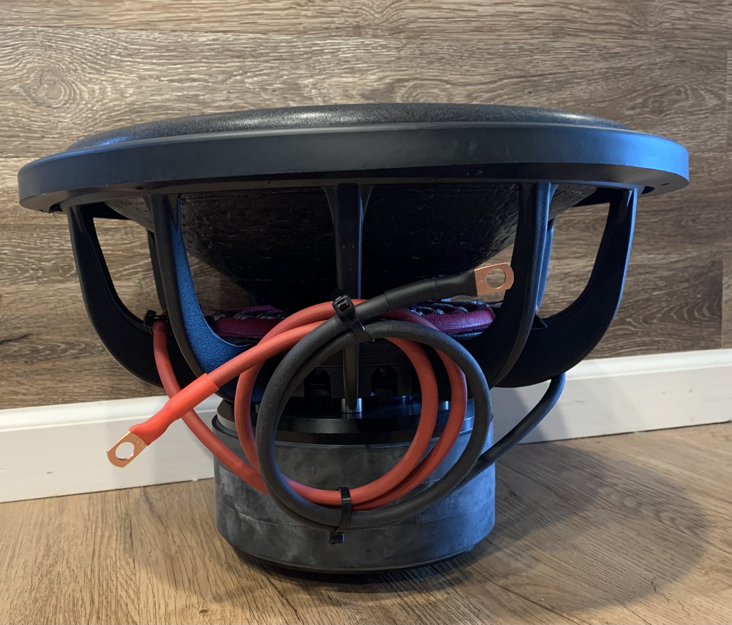

my own I built. I do these SPL style subs which are pretty bad ass! They are built on a 12 spoke frame, triple stacked Y35 motor, non pressed pulp cone that is Kevlar infused (has small strands in it) with the backs glassed, motor to frame spacers, 3” 8 layer flat aluminum wire coils (tightly gapped), 10” carbon fiber dust caps, nomex spiders with tex70 nomex thread to sew the dual leads, 8 ga direct leads etc. Mathematically the subs have 33mm of xmax but if klipple tested allowing for I believe 10% thd it would probably be around 40 ish. While I do sell these and this car is being built not only for personal enjoyment but also to show them off, I’m in no rush to sell them like hot cakes. Still want to get more test equipment as sending them to klipple for example with these shipping rates now is just insane! I also have to build a test bench here (power supply with batteries and high power amplifier) as it’s a pain to go to my buddies and do the testing there. I’m not looking to make this a big thing at all, I do it mostly for the tax write off and cause I enjoy it.

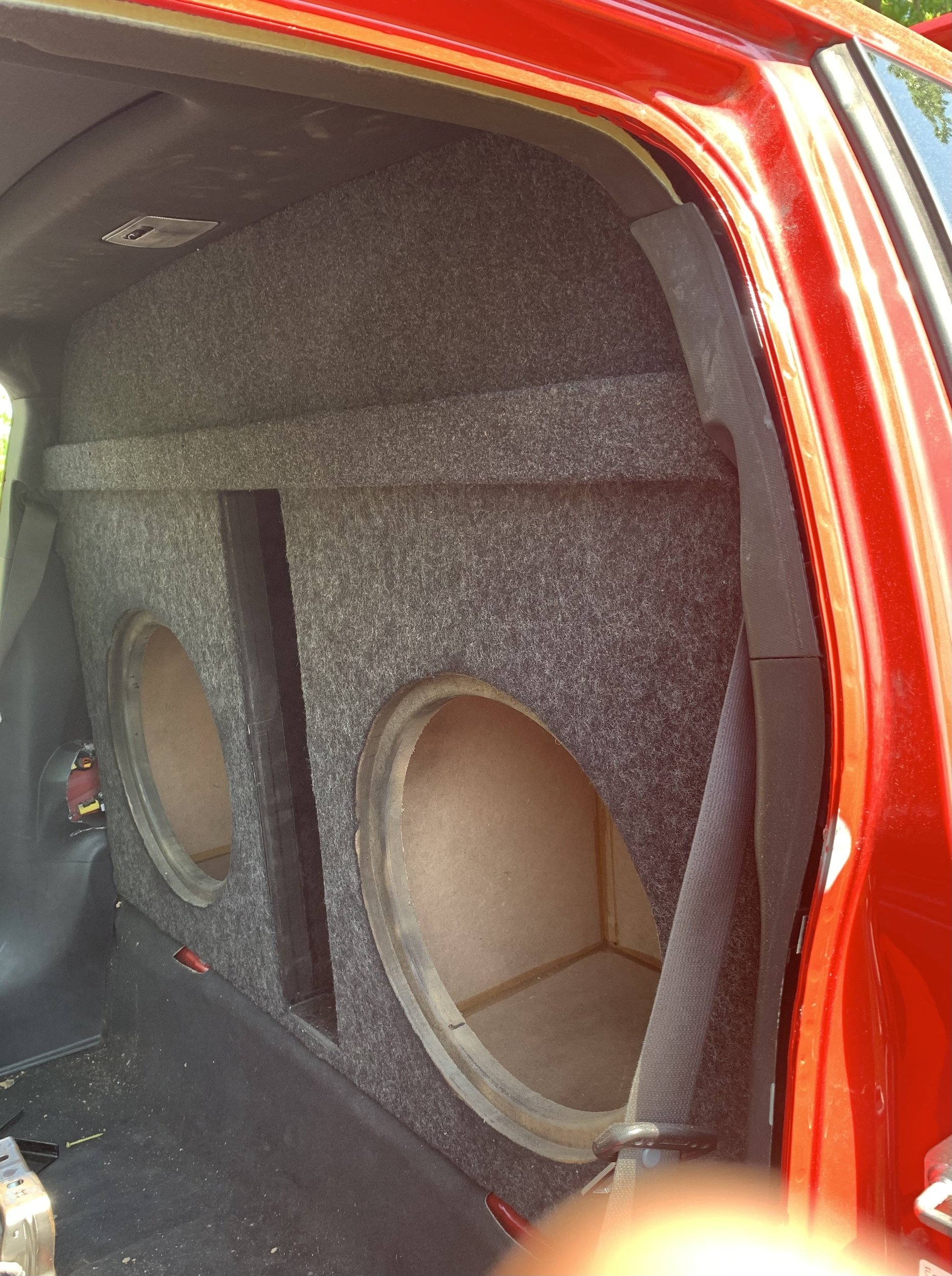

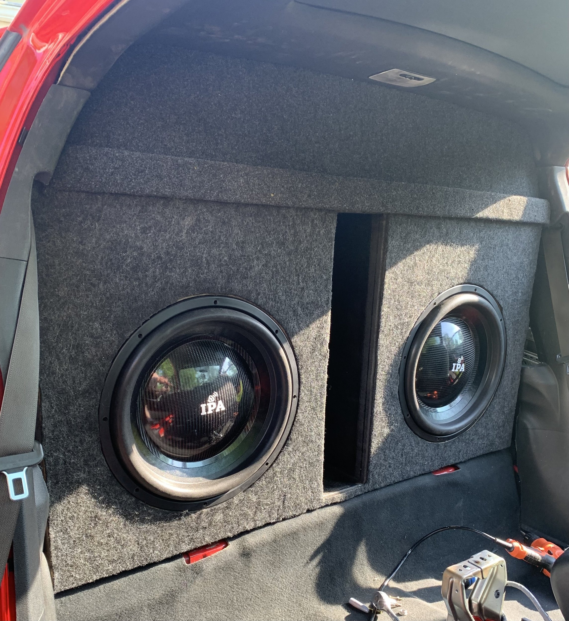

Brackets in the back of the box are done! I had to stuff the wife in the trunk to use the ratchet while I was inside the car with a ratchet going through the port end 😂. It is rock solid! Tomorrow morning I’ll do the lags for inside the enclosure to lock the front in place. Then we make it look like a wall! Stay tuned 😈.

to get more crazier we add 100 more oz to the motor, add .5” to the winding width on the coil, Ti frame, 10” spiders, and a taller surround. Still keep it as a 3” 8 layer coil. You would need more than 3k tho. 2k min for each 2500 each would be ideal. I’ve free aired these things on 3k with ease. When I get the setup here and don’t have to drive 45 min to my buddies to do testing I’ll take some sub porn. On a 18” 12 spoke built just like the 15’s I’m doing in my car, it’s honestly the best all around setup. It’s also more cost effective, especially since they are about 20 pounds lighter so it’s cheaper to ship lol.
Almost got the top plate of the wall complete. Just tweaking the fit a tiny bit in spots and then will carpet it! Pics by sometime tonight maybe sooner! Wednesday I’m gonna do the Xs power D5100r under the hood and make all the wiring pretty.
Almost there, came in to take a break since it’s hotter than hell outside!

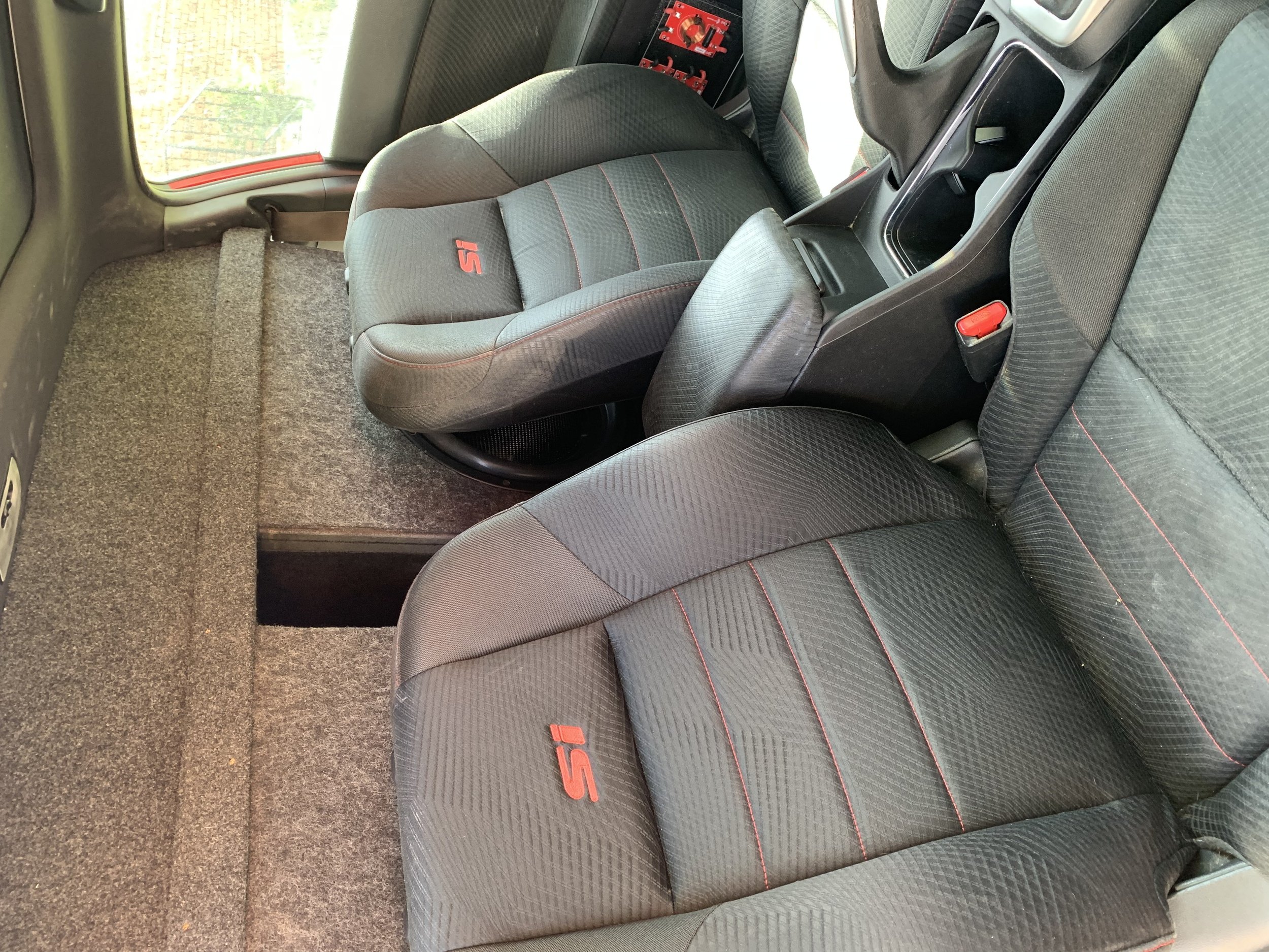

Man the interior shrunk lol. AC gonna really pump now 😂🤣. Just gotta clean the interior and do the head unit and the inside is pretty much done but some small finishing touches. Under hood battery will be done Wednesday and then next week the battery in the trunk followed by laying out the amps and distro blocks on the amp rack. Almost done!
