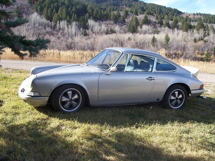

Greetings from the newb!
I don't have a thing I this old porsche except dated 80's Sony stuff.
I'll be installing whatever single DIN HU I get In a modified glove box enclosure (built from scratch)
