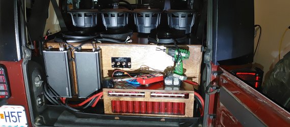

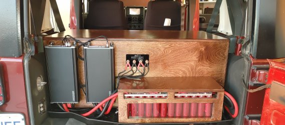

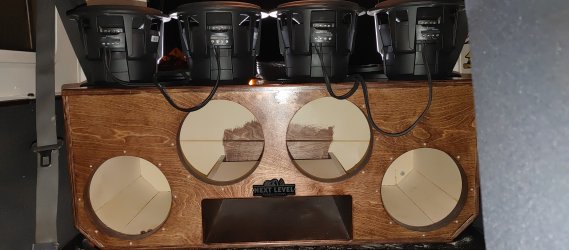

I installed my build today and im not sure what i have going on. 4 subs wired to two monoblocks. When i turned on the key for the first time the subs made a thump and a few seconds later i could hear the subs sizzling and i shut the. Key off.. Subs thumped again and i could smell burnt coils and see smoke coming out of the port.. I had the gains all the way down and had not connected the rcas yet... So I pulled the subs and unwired them. Everything appeared wired correctly inside and outside the box.. I had my son turn on the key while i watched the voltage coming out of both amps and i couldn't detect any voltage upon turning the key on and off?? I dont know what the hell happened.. Subs still test 1.7 ohms each. Any ideas?

No scratching resistance against pushing down seeing normal. They are x-w-10d4 Alpine Subs and kicker CX 1800.1 amplifiers. Each amp was wired at 1 ohm on a pair of subwoofers. One thing I didn't mention earlier was that I accidentally reversed polarities on one of the amplifiers enough to make a spark. But it seems to come on and does not go into protect mode or anything. Green light is there. I got to work today but I was planning on doing what I should have done to begin with and set my amplifier gains with a dd1 plus and see if everything looks normal there with the Subs disconnected. I'm guessing scratching and excess resistance is bad right?

Yeah those subs have some odd jumper card you change for parallel or series wiring. That's what that thin gray thing is above the screws. Looks like he has each sub set to parallel, which should be 2-ohm per sub, so his approximate 1.7-ohm sounds like they are wired correctly, at least the subs themselves anyway.

Yeah they have a switch above the connections for parallel and series. According to the manual the way I have it set up is for a 2 ohm load per subwoofer and then two subs on each channel for a 1 ohm load on each amplifier.

The amplifiers aren't really strapped as I understand strapping an amplifier.. Please correct me if im wrong cause im ignorant of what strapping amps really is? ...it's more like the signal is split from the rcas to two individual amplifiers and each amplifier runs two subs and you match the gains between the amplifiers so all four subs see the same output voltage.

Ok everything disconnected and amps powered up and one amp shows 43V DC at the speaker outputs. So do i need a new amp?
