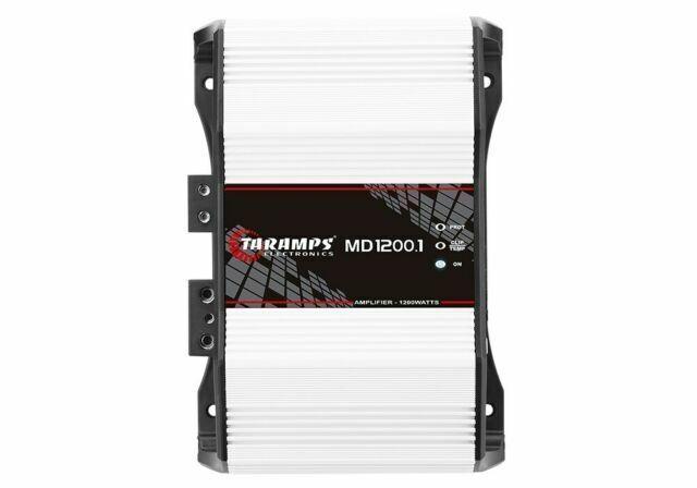

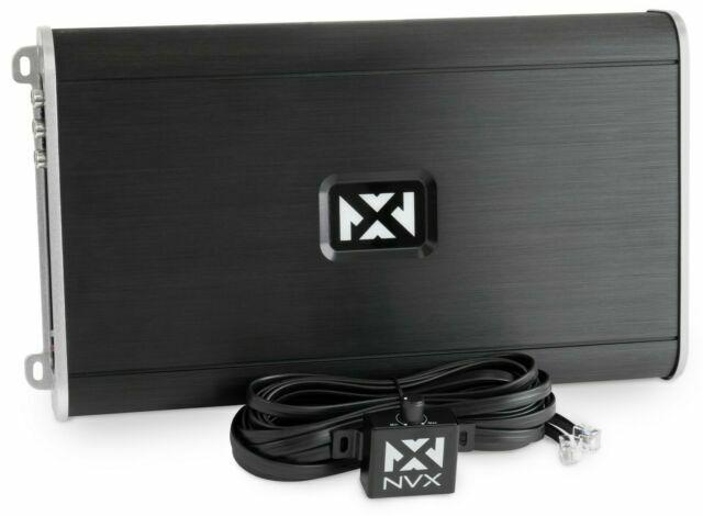

Agree. I felt like the sound was getting dirty way too soon. I would also stuff 1lb of acoustic stuff in each chamber or 2 pounds if it is shared. That stuff (no pun intended) really cleans up sealed enclosures. That amp is a tad bit meek for dual 12s too. Sell the JL, pick up something like this:
I mean it's not JL but is considered decent among some of the better mid/budget lines, but they are nice amps for the money. It puts out double the 300 your JL is giving the 2 woofers. You're really underpowering those 12s in my opinion.
4 ohms: 80 watts x 4 chan. + 350 x 1 chan.
• 2 ohms: 125 watts x 4 chan. + 600 x 1 chan.
• Bridged, 4 ohms: 250 watts x 2 chan. + 600 x 1 chan.
• 5/4/2 Channel Operation
The amp is being sold by Sonic Electronics' eBay liquidator, Their Username is CARAUDIO of all things! They always take offers, I would offer the guy $200.00. he may take it or if not will almost always counteroffer. It's already a good deal and works well in your situation.
You could also keep the JL, ignore the 5th channel and add one of these:
Its output at 2 ohms matches well with the subs you have - it's good quality power that will run great, around 800 watts at 2 ohms.
- just a couple of suggestions.
