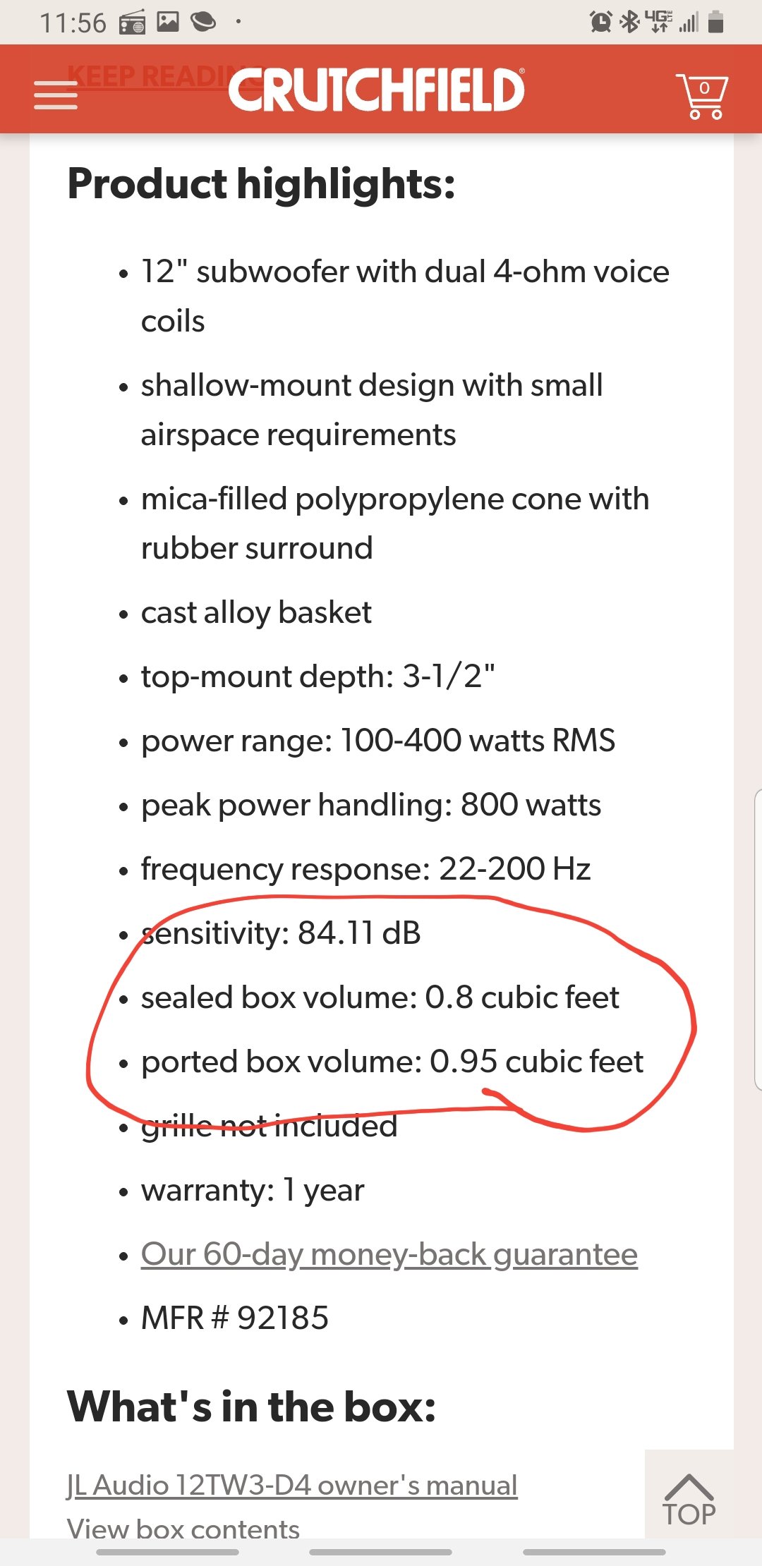

I would try this setup. 1 cubic foot vented.
I would try this setup. 1 cubic foot vented. View attachment 19691View attachment 19692
It's on my short-list as well. i was leaning towards the SD$ because of the underhung design and the fact that it has 50mm+ of xmech so it would be less likely to bottom-out like many low-pro drivers do. i have heard very good things about the TW line though...may end up being my ultimate choice. i currntly own a 13tw5v1 that I'll be making a sealed box for...but I have a feeling I'll want to try a ported box though.
sundown SD series needs ported. Sounds like absolute **** in a sealed or rather just extremely weak especially in a truck yikes. The sundown will be centered around deep low frequency response more while the JL T series will have a typical musical sound focused a bit on the higher notes naturally.
