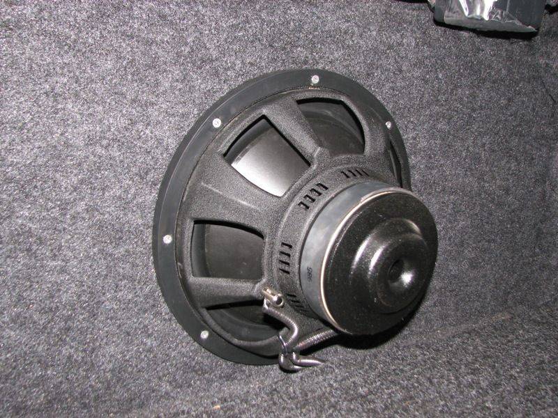

I ran the A-12 in a vented/aperiodic enclosure as part of my home theater. It replaced the Vega-124 that was using the same enclosure. The A-12 outperformed the Vega 124 in every way. A-12 sounded better, more natural. A-12 played lower. I was very pleased and will likely get another A-12 for this purpose. The HT application was mostly for break-in and also to get a feel for the musicality of the subwoofer. The enclosure was a front-facing slot ported enclosure with fiberglass insulation fill in the cavities as well as the port (creating an aperiodic effect). Amplifier was a plate amp rated 240W@4ohm and 1%THD. Mechanical excursion limits were not exceeded at any point. The A-12 blended flawlessly with the Boston Acoustics A40 speakers it was paired with. The sub was located directly below one of the speakers, pointed at the listeners. Even crossover points as high as 160Hz were fine, the A-12 sounds very nice.
I moved the A-12 into my 2001 Honda Accord. I placed it in the IB/TB wall that previously held a pair of Oz Audio 300H subwoofers (12" IB subs). I have been very happy with the Oz subs for both output and musical ability. I ran the A-12 from two different amplifiers. The first was an Xtant 3300c on the mono output (160W@4ohm .01%THD). The second was a Rockford Fosgate 500x with one channel bridged (200W@4ohm and .1%THD). While the RF should have "more power", the Xtant 3300c certainly provides more impact and overall output.

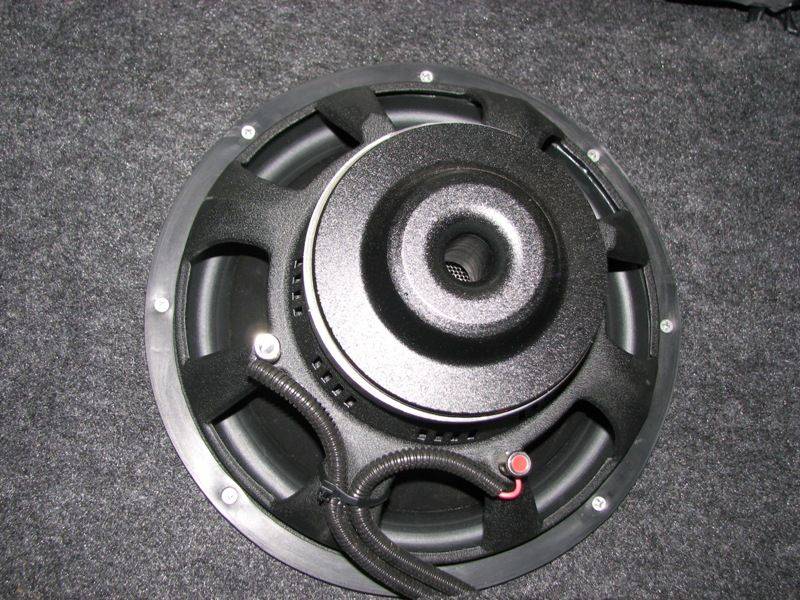

- The cone is a decently stiff poly.
- The surround is durable.
- The basket is stamped steel, but coated and shaped to look like cast. It certainly is more rigid than any other steel basket i've seen. They saved money but didn't forget the end goal of rigidity.
- Push-terminals seem to be more common these days - they work just fine.
- Cooling is adequate, both pole piece and also coil/spider venting.
- Cosmetics are simple. I like that in a sub.
