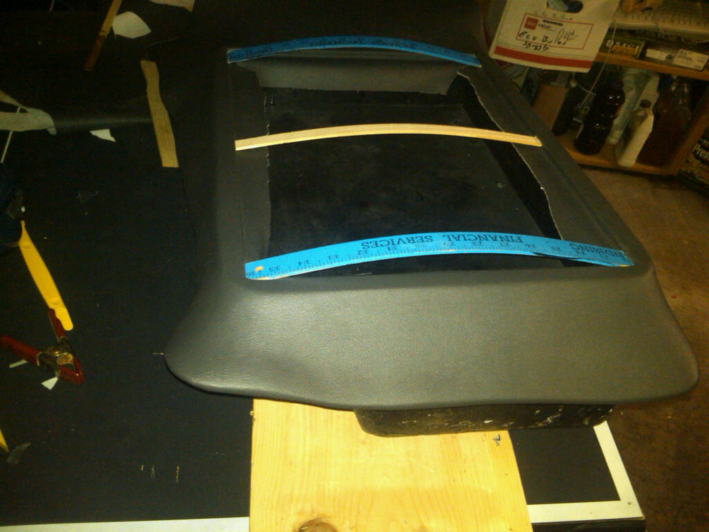

I was terrified I would mess this up. My two young boys helped me as extra sets of hands. There is a good video on You Tube which gave me a crash course of sorts. I found this really helpful, especially the tip about shocking the vinyl into place with a wet sponge. This really does work on some of the more difficult bends!
Worked on the vinyl around the amp rack tonight. Yard sticks make great clamps for the corners...
Man that Looks simply just BA period,and very clean..Very nice indeed!

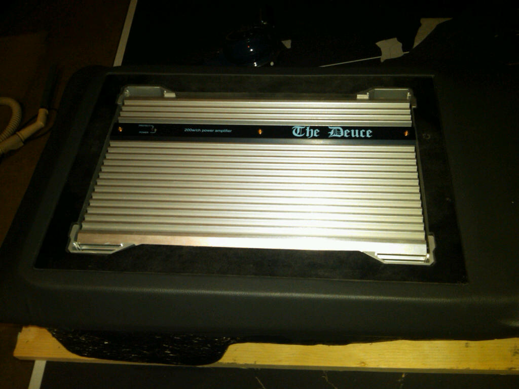

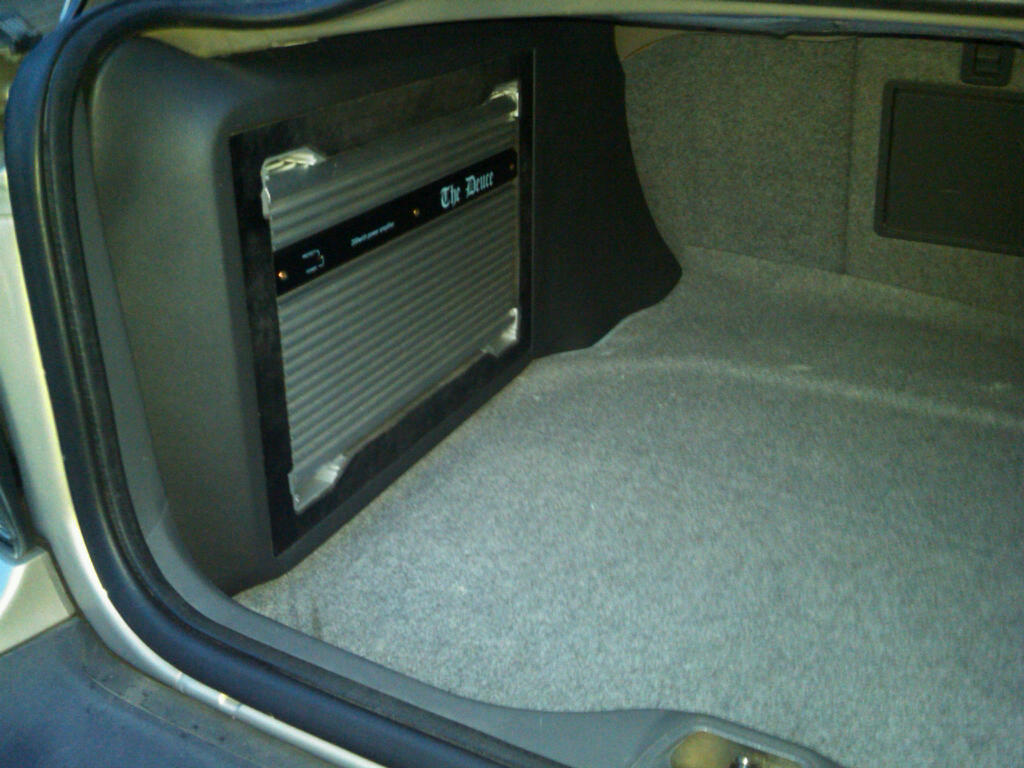

Thanks dude! I can't say it is perfect. There is a spot which did not adhere quite the way I wanted. Thankfully it's on the back area which will not be visible to anyone. I could go back and work on that area. Sometimes it's best to leave well enough alone. If I have to pull up vinyl at this stage, heat and re-glue, who knows what sort of unintended consequences that will create. I think I will quit while I'm ahead and call it good on this panel. I started placing the amp in the rack this morning. Here is a shot with an MDF mock up of the frame which will go around the amp. The actual frame will be made of black acrylic which I plan to have a local shop make for me. I will take the mock up in and have them use it as a template. The place is called TAP Plastics here in Redmond, WA. It's the same shop where I got my fiberglassing supplies.
Test fit of the panel with amp in the trunk. I'm diggin' the way this looks. Next thing I will start doing some of the wiring. I'm anxious to get some sound out of this thing and the front stage is a good place to start. Need to wire all the power, ground, RCAs, turn on, etc. I also received a blue LED illumination kit this week which should be a pretty easy hour job to wire in parallel with the factory trunk lights and glue gun the tubes into place up under the rear deck.
...frame around the amp is the temporary MDF piece by the way. Ideally what I want to do is have a piece of black acrylic cut with about 1/8" gap around the amp itself. Then put one of the blue LED tubes in the amp rack so the outline of the Zed audio Deuce will glow blue. It has a very unique shape which will be cool to highlight. I've also figured out a way to blank out the factory trunk lights with a Z shape so with a blue LED festoon bulb in them, it should project a Z (for ZED) on the side of each amp panel. Those are some of the details I'm thinking through now as I see how this is all fitting together.

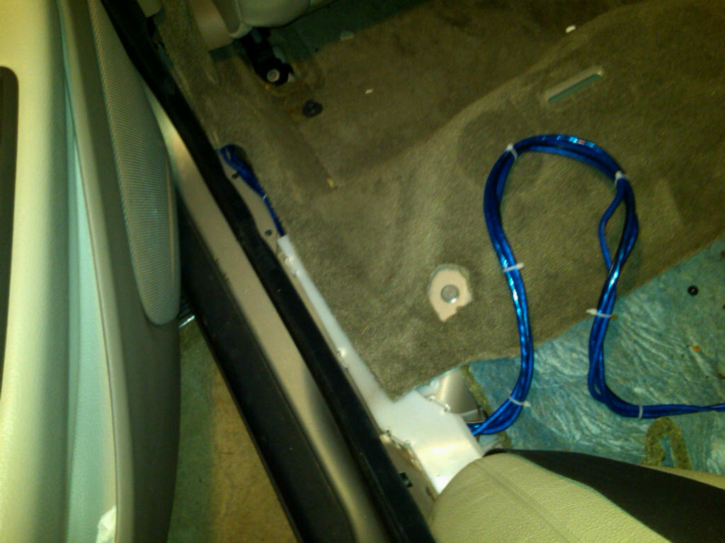

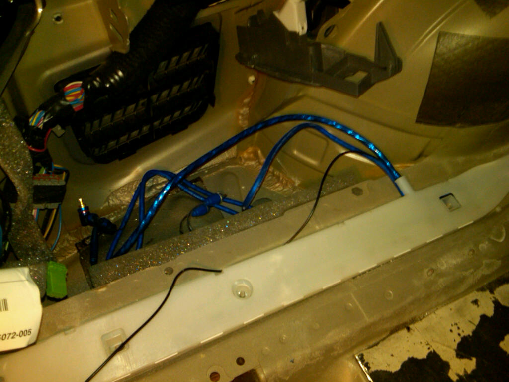

First thing was running the RCA cables and the front speaker wires. I chose to run a set of RCAs for Front/Rear/Sub which are all of the outputs the Kenwood KDCX994 deck has. The immediate plan is to use the Front and Sub RCAs but while I was at it, I figured I would save myself some work for future in case I have a need for the rear RCA outputs. I pulled the drivers seat in the car (sort of). Turns out the seat belt is fixed to the frame of the seat with a large torque bolt. I have a set of torques wrenches but nothing that large. So I unbolted the seat and just moved it out of the way towards the back seat of the car. That gave me enough room to work. I ran the RCA cables down the drivers side of the vehicle using the factory wire conduits wherever possible. Here are a few shots of that. The factory conduits had enough room to house the RCA cables, speaker wires, and turn on lead.
RCAs and turn on lead route to where amp will mount which happens to have an extra factory hole in the conduit which I pulled the RCAs and turn on lead through.

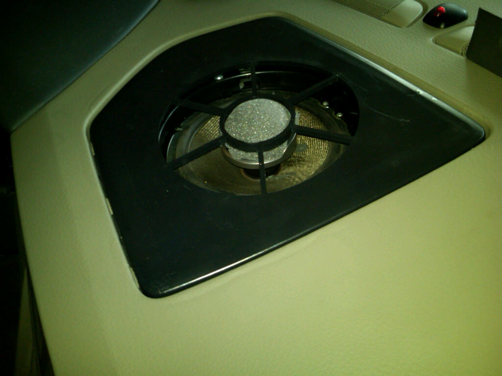

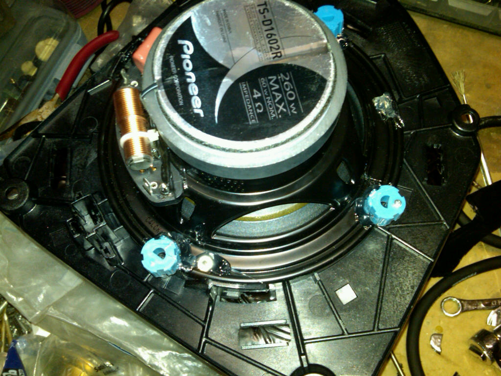

The next thing I tackled was the center channel. The S60 has a factory location in the middle of the dash for a center channel. I always assumed this location had a speaker in it. But upon prying off the grill, I found it did not even have a speaker there. It was blank. Luckily, though, Volvo included the baffle for the 6.5" speaker which I was able to use for the Pioneer coaxial with just a little bit of Dremel modification. I am going to experiment with the center channel to see what sounds best. But for the first go, I am dampening the tweeter with some foam and using the low pass cross-over on the Zed Audio deuce set to 3500Hz. The deck will provide a HP crossover so that will effectively make a bandpass for the center. I'll experiment with some caps in series with the center as well in order to tweak the HP crossover point for that speaker.

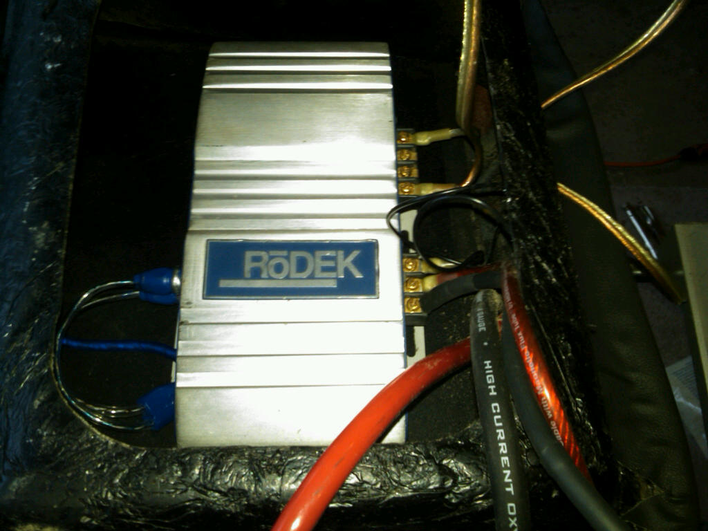

Keeping with the theme of Zed Audio, a Rodek 225i bridged mono will drive the center. By controlling the gain on the 225i, the overall amount of center channel in the mix can be adjusted.

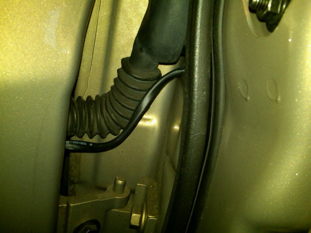

Next was routing the speaker wire into the doors for the fronts. I could have taken the easy path and patched into the factory wiring but after looking at the puny connectors in the molex connector and the gauge of wire, I just went for it and ran my own. This was a huge pain. The Volvo uses molex connectors. It took some figuring out how to remove them to get a look. I saw the Porsche build on this site recently and hoped I would have similar luck, being able to drill them out and run my wire through the molex. No dice. After staring at the door and connector for nearly an hour, the route I took was to use one of the factory bolt holes for the molex as my wire hole. Basically, there is a plastic harness for the molex that is held onto the door with two nuts that thread onto bolts that are reverse threaded into the plastic harness. I found that the reverse threaded bolts can be removed. One nut and bolt is enough to hold on the plastic harness effectively so I removed one bolt which left a hole for the wire to route through. What you see here is the result with the speaker wire running right along side, underneath, the molex connectors and then just punching through the factory rubber grommet. Looks easy but this was a pain to figure out how I wanted to do it. Probably took about 2 hours for the first door and 1 hour for the second door.

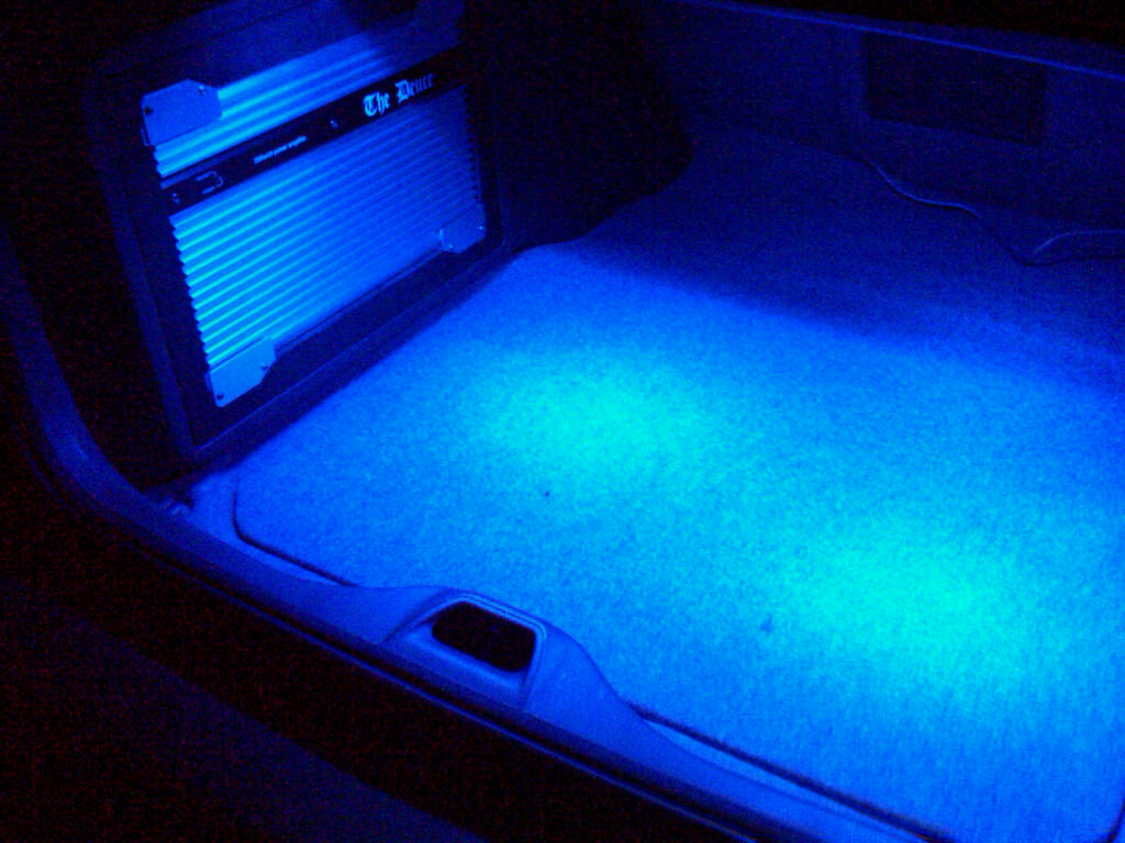

Here is one picture you all haven't seen yet. I got a little blue LED glow kit for the trunk. It comes with 4 "tubes" of blue LEDs wired to a little controller box. I wired it to the factory trunk illumination so it kicks on when the trunk is opened. There are other features this kit will do such as flashing and sound activation, etc. But here it's just used for glow. The tubes are mounted on the underside of the rear deck so they provide a glow effect. Once the subs are installed I will aim two of them right at the subs.
LOL! I didn't even know who that was so I had to google it. You mean the Lakers guy, right? I do see a resemblance now that you bring it up. The irony is that I moonlight as a Jim Morrison impersonator in a tribute band here in Seattle. I have a few months off from the band and...this is how I am choosing to spend my time, building a kick *** car audio system. Can't wait to get these subs in. Ray Manzarek's piano bass will never have sounded so good.
