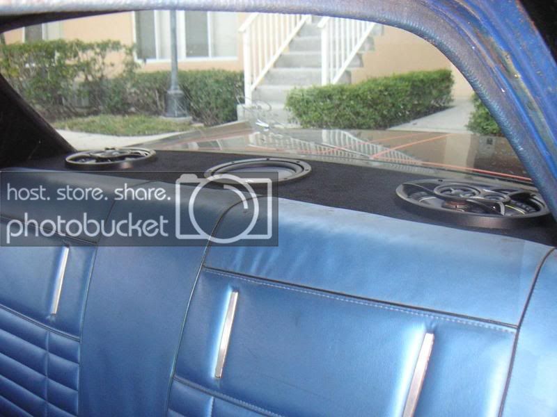

I carefully cut out a 8" hole center in the rear deck of my 72 plymouth valiant and kept my kicker ds 6930 back there.
here is a pic
here is a pic
I like that (a lot). If you could find some nice 8" IB subs and have the room... That would be superb.
I used a dremel tool with a cut off wheel to cut out the metal tray back there.
then cut a scrap piece of 1/2" plywood to fit back there and traced the 6x9 holes and the 8" sub hole on to it.
and carefully cut and test fit - sanded a corner here and there and test fit again and again.
then got a can of spray foam - and shot a fiew patches of foam down on the metal of the rear deck
and put the plywood on top of it - added maby 3 or 4 screws to keep it held down good.
once cured - the foam will bond the metal deck to the wood and be solid / prevent rattles also.
then got the black carpet from walmart - and a little can of rubber cement
cut the carpet to fit on back there real good - again cut / test fit / cut test again ext...
then just glued it down and put the back seat back in.
bang
super good looking rear deck.
extremely minimal money spent
only my time realley invested in it - wich is fine my time is free for me only. lol
id definately say do it. dremel tool cut off wheel is amazing.
just keep a magnet with a plastic ziplock bag around it near where you are cutting.
that way the magnet will catch all the particles of steel / metal that will be flying around.
you dont want that stuff to land on your speakers also... so watch out

my 72 plymouth posted above is running a small amp in tri mode for the rear deck.
the left and right 6x9s are on the left and right channels - and the sub in the middle is running bridged off the same channels.
it might not be such a bad idea to pick up a litle cheap o amp to power them. my local swap shop and pawn shops have $25 used car amps all over the place - and a wiring kit for such a small amp would be verry cheap also - I even think walamart has one for $30
