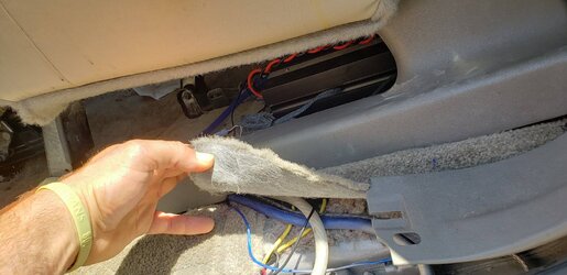

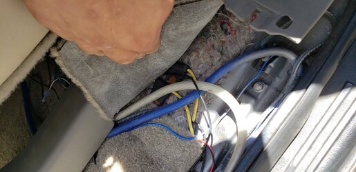

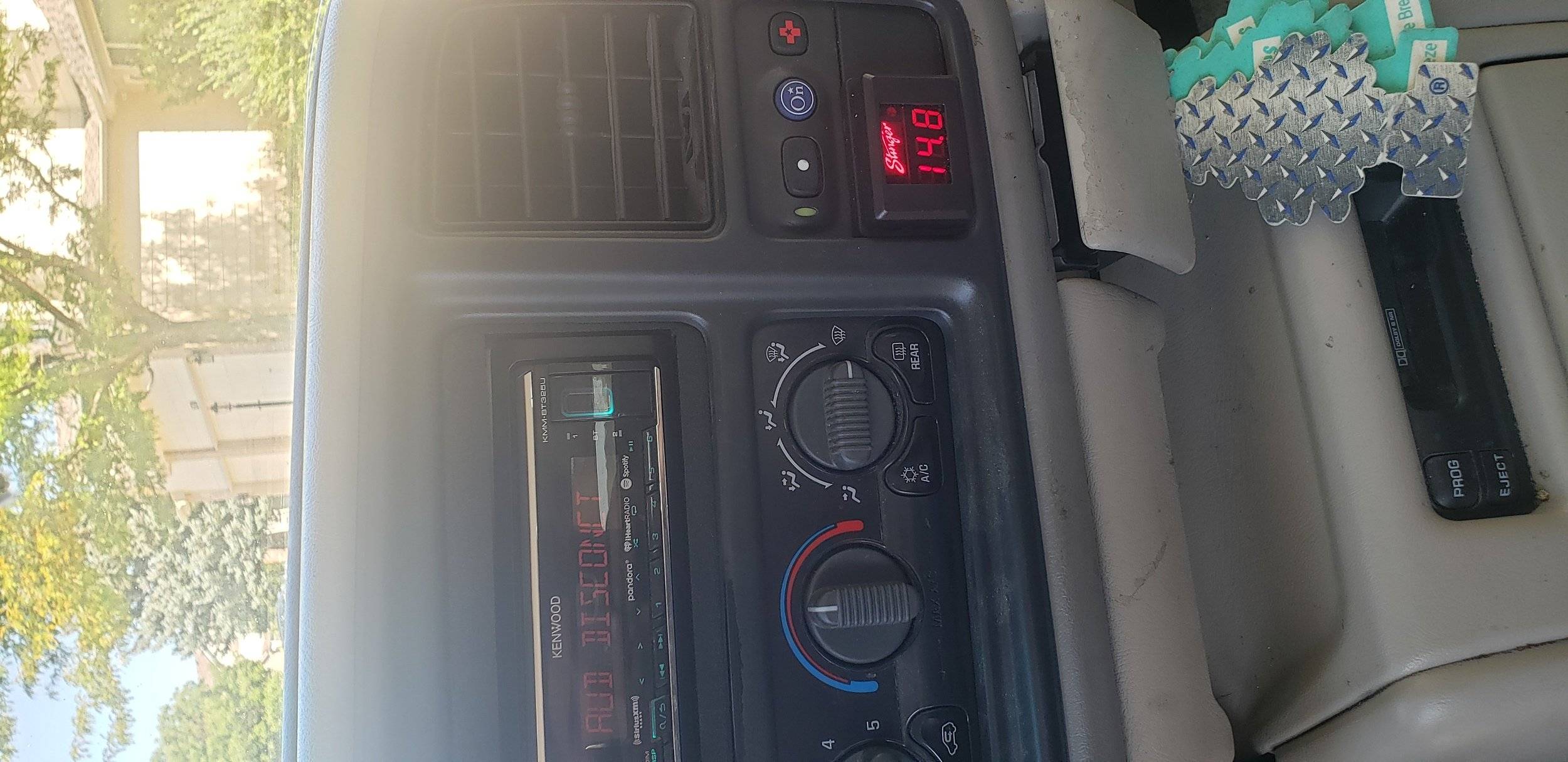

Went ahead and copped the pioneer mvh-s512bs. Gonna be here Wednesday, cant wait to install. Hopefully i dont need a new wire harness, doesnt look like i will. I installed my stinger voltmeter in the blank spot beneath the onstar(pics coming) and i put 5 amp fuses on the ground and power. Tapped all three to the power, rmt and gnd on my amp. Will probably connect the rmt to the pioneer when i swap it in for the kenwood.
Working on the new alt. Might just do another battery as i have plenty of space in the rear.
Also, something has been draining my power...when i turn it on its barely above 9 or 10 volts..started recently after i put in the VM..could be anything tho
