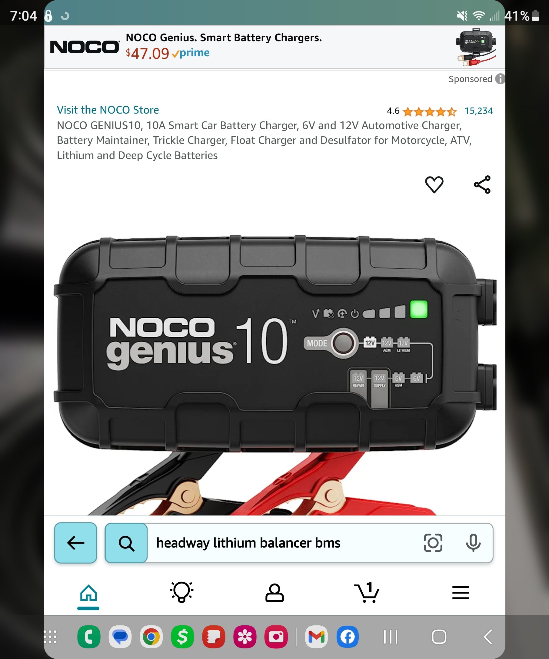

Building small headway setup. 16 ah 8 cells. All new to me. Can someone shoot me a link for a cheap but safe lithium charger please. Its confusing when i search i have a regular 12v charger but cannot use that one of course thanks in advance. Or could i possibly use the 12v trickle one i have for my motorcycle some way?

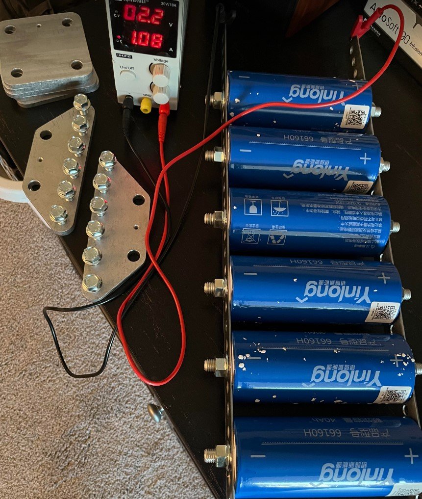

You do. You will want to passive balance them and then use the adjustable power supply to charge them to your alternators charge voltage.

So charge them to 14.4 volts? Thats where my alt charges. So i will need a charger with a setpoint on it? The charger part is confusing me. Im reading different thi gs everywhere. Some people have said i could just throw my reg charger on it and monitor the voltage? Why couldnt i just build it and balance it and then run it with an isolator to let it get to full charge on my alt? Sry i am learning. Thanks for the help
That's why I recommend a adjustable power supply. You can set the voltage/amperage to whatever you want.
I parallel charged mine to 2.2 and then 15.8 when in the buss bars in series.
