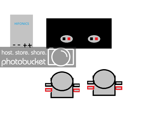

So this is what I've got along with approximately 15 feet of speaker wire. Amp is Hifonics Glx1400.1D, and subs are Pioneer TS-W3003D4 (Dual 4-ohm). How do I wire these to one ohm when the box has terminals?
Every diagram I see has amp wired straight to subs and doesn't have terminals //content.invisioncic.com/y282845/emoticons/mad.gif.c18f003ab0ef8a0d9c27ca78d77a6392.gif.
Also each sub has a seperate chamber so wires can't go from sub to sub. Is there a way to get this wired to 1-ohm? Thanks for you help guys.

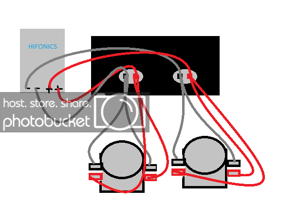

So this will run the amp at 1-ohm?
What you drew will work and is electrically correct and will result in a 1-ohm load on the amp. But, like CCooney said, it might be easier to jumper both VC(+)s together and then connect one wire to the terminal(+) inside the box - same for the VC(-)s. Do it just like the Sonic Diagram. Solder wires at the VCs.

My brain hurts just looking at those diagrams. It's late so if anyone sees a problem with either of those, please feel free to chime in!
