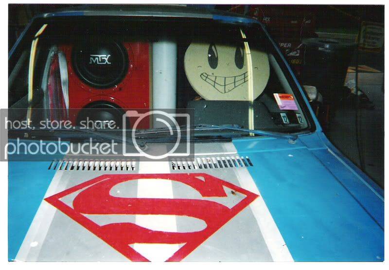

No one loves the MTX RFL 152s or is it just too old school for anyone here? That 4.35" peak to peak is not false advertisement although that sub has a high Fs so it didn't sound that great as a daily sub so it wasn't popular.
People were doing over 160s on a termlab back when these came out in like what, 2003? They were all over termpro with many team members using it.
You've answered your own question about my reply... peak-to-peak. The OP's question was is there any production sub with more xmax/excursion than a XXX, the answer is no. And the RFL, with its peak-to-peak spec clearly puts it nowhere close to a XXX.
That 4.35" of excursion figure is not only peak-to-peak (so you can cut it in half to compare it to other subs made by manufacturers who dont publish bullshit specs to make their product look better), its probably also xmech doubled (since its pretty much an SPL-only sub where xmech is more important than xmax) so you can chop even more off that figure before you halve it.
