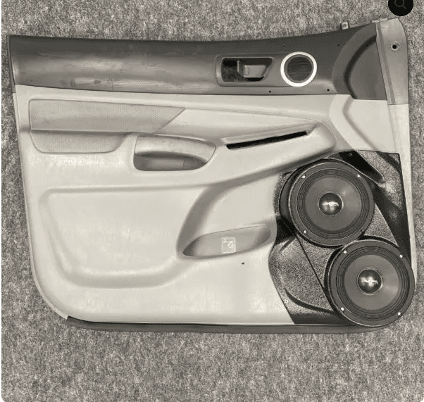

If I went this route and ran 2 6.5 mid bass and a tweeter in factory location. Could I run a single passive crossover and wire the two 6.5's to the one passive? Or would you just use bass blockers for mids and tweeter and get rid of the passive crossover?
No, and no.
If you ran two mids and one tweet with one crossover, you'd cut the power to the mids in half, but not the tweeter.
Nor would I use bass blockers. You're wasting the unused frequency range and the power for it.
With those, door pods, either:
Run one set of components with a crossover, and use the other hole for just a mid, OR
Run two sets of components with two mids, two tweets, and two crossovers. You would use a 4ch amp for the front doors/4 sets.
Don't know about your rears, maybe HU power, maybe another amp.
Where is the mounting location for the tweeter now compared to where it would be when it's mounted with these. I'd bet you're putting the tweeters in a worse location. Wouldn't they be lower, and more likely blocked by people (more often)?

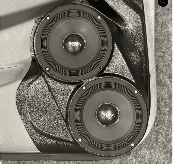

What model are the components and what are the dual 6.5" drivers you want to use? The ones in the picture are really professional-style midrange drivers, they play well from about 100-150Hz to 8000hz, not exactly midbass, more like low-mid to mid-high. You would not get a lot of that 40-100Hz punch from those drivers. At 92.5db, two of them in parallel will be too loud for normal dome tweeters to keep up. Are you thinking that you want to add the duals to your existing comps?

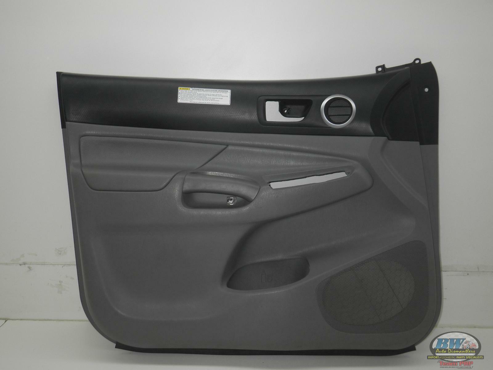

As you can see the factory location is high on the door.
What Size is that Tweeter location in the upper door card?. You havent bought the dual Pods yet have you?. At one point in one my 98 Chevy Xcabs I ran a set of CDT Braxial(On Sale atm.. Mine were almost $500 bucks when I bought my first set) components and a set of DRT25 tweets on a 4ch up front( PPI Phantom 900.4) with a single 1k substage(XFL12 DVC2,and PPI Phantom 1000.1D) and it sounded really nice for my temp system until I went Bigger, and then added a set of CDT M6 eurosport mids on a PPI Phantom 600.2 in the doors close to the upper portion of the Brax. set pretty much these now

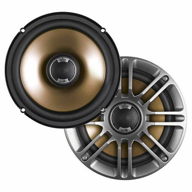

But i think It would be nice to do the Braxials in the doors and if you have the space or dont mind trimming a bit to squeeze the Mid Tweet combo 2" in there. I think that would be a really nice setup, and just get some Polk DB 6.5 coax and run the rears off HU power with an inline Bass cap on those.

Anyways its These for the rear doors. And Amazon has them for like $58 bucks. Dammned good speakers for the $
