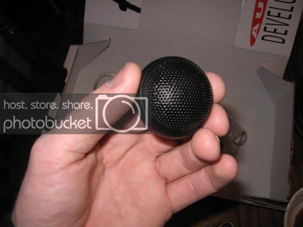

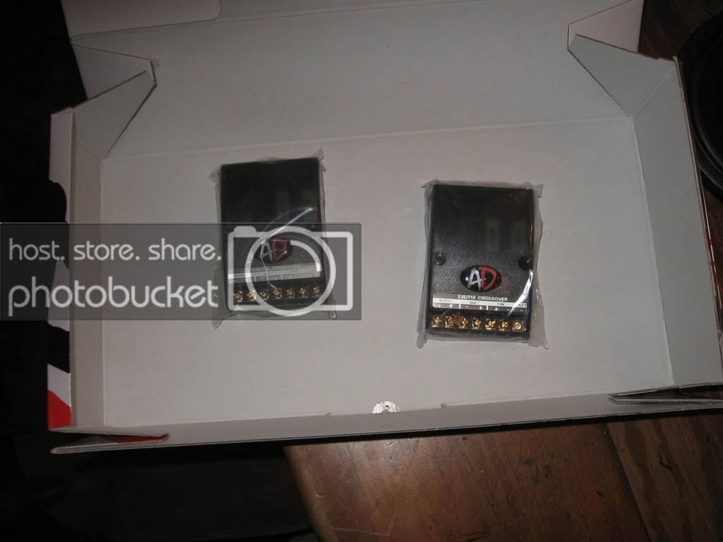

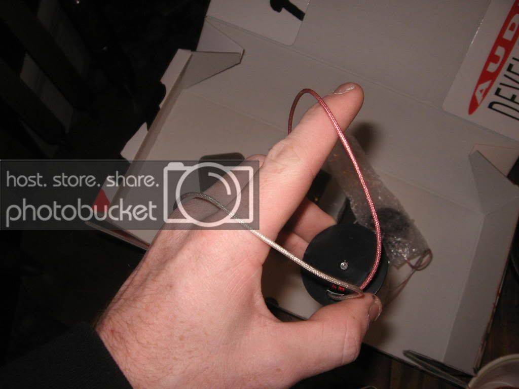

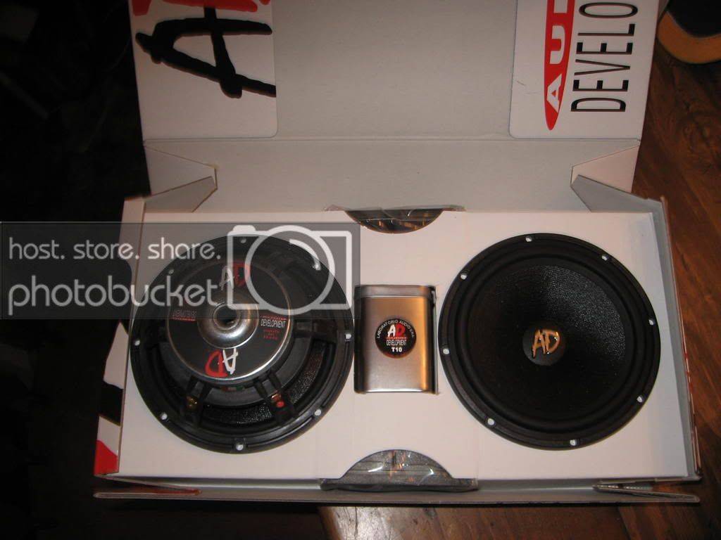

Good information im really trying to follow this. im like a newbie at component's sad i know but this would be my first set of component's of me installing. i do have a couple questions if someone could post up here pm me bout it i would really appericate it.
1.) you take out the stock speaker but what do you do with the stock wiring do you use it or not?
2.) how do you hide the wiring for the crossovers
3.) how do you hide the wires for the tweeters
4.) how do you actually wire everything up .
Here is what im working with would really really appericate the help guy's sry i know im a newbie in this part of audio but i gotta learn some how:D. Most of the music i listen is rap once i have my system in that is but i do listen to techno , rock and metal also and i will be running for now a deh pioneer 4800mp.
