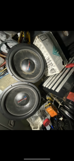

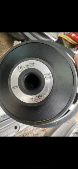

I need some help and advice on American Bass XFL-1544 V2’s recone kits as AB doesn’t carry them anymore for XFL line🤦🏻‍♂️,
so does anyone know what the voice coil spec sheet is for reference to rebuilding if no drop-in’s kits then anything that will fit and work I heard Soundqubed HDX3.2 15’s would work but that just hearsay as I have six 15’s I’d like to rebuild better and more powerful if possible I know theirs some people that can rebuild if last resort any help links or information is greatly appreciated in advance…🤙

I kinda wanted to do it myself and can just need VC specs former winding height ID & OD coil mm measurements/ spec sheet…

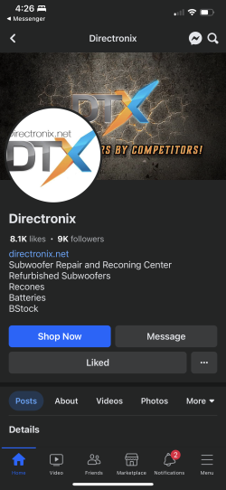

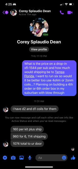

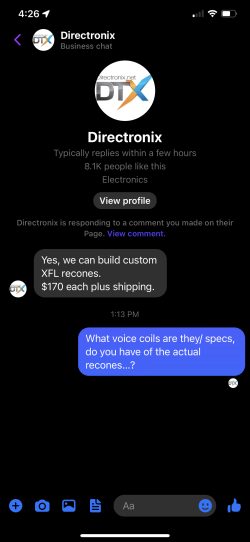

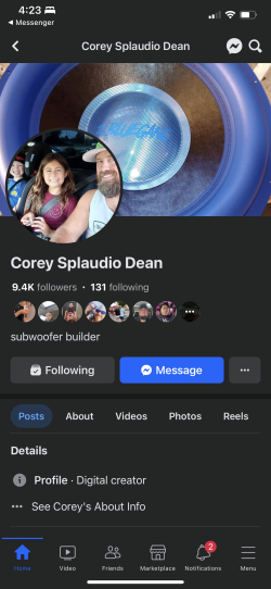

Are you still wanting to get yours reconed I know two people on FB and they can and have their own rebuilding business, IDK if the price would be the same for you as yours are smaller or the same price but my quotes were $160 plus shipping from one rebuilder and the the rebuilder is $170 plus shipping.
I’ll post links here if you’re interested or if anyone else needs some in the future…🤙

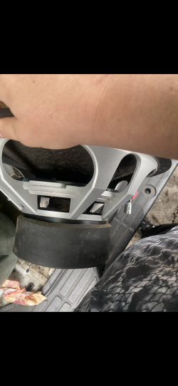

Easiest thing to do is measure the gap and pole piece to see what coil diameter to use and measure depth to see what winding width will work well. If my memory is correct it’s a 3” coil and is standard size so anything with an inside diameter of 3”-3.02” and an outside diameter of 3.20-3.28” should be fine. Verify gap dimensions as I’m going off memory here.
Yeah I had torn one down and used my digital calipers to measure coil size ID & OD and winding height and spiders all had it written down and had pictures but the hell if I know what I did with that was years ago and had the XFL’s in my shed stored in the back go figure and they are buried and just being lazy to dig back out and was hopping somewhere someone had a spec sheet to do a parts list and shop around even the guys I msg that will rebuild them that know the specs wouldn’t give me the coil specs kinda of a ass move but that’s how they make their money doing only rebuilds/ recones and I can understand that as I’m a mobile A/C tec./mec. on semi’s and off-road equipment 12v/24v systems and people would call me all the time for my knowledge aka just fishing because they know just like I don’t know but have the knowledge just forgot…L😁L
