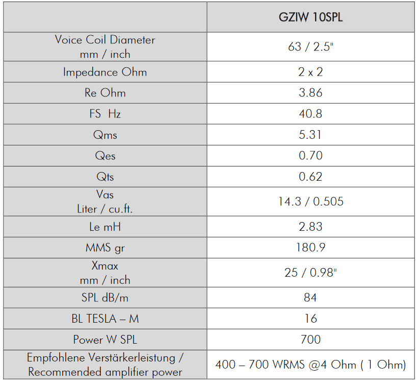

I got this snippen from the spec sheet of the subs I have, not really sure what to look for since it shows the Impedance at 2 x 2 ohms and Re (which I don't know what it means) at 3.86 ohms:

You have the dual 2 ohm coils. You must exchange them for dual 4 ohm model or go with an amp like the kicker which is rated to make its power into 2 ohm final load.
