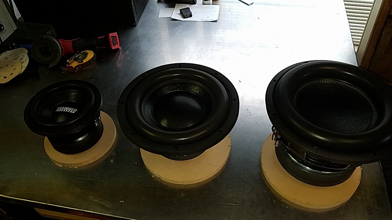

Testing big boy out soon for bed box
Parts on the way for 2 2k 12s with 400oz motors. will run a DS18 EXL-P2000X4 on mids and a DS18 H-KO2 HOOLIGAN per sub. Now I need to make up my mind on box design or the blow through.
