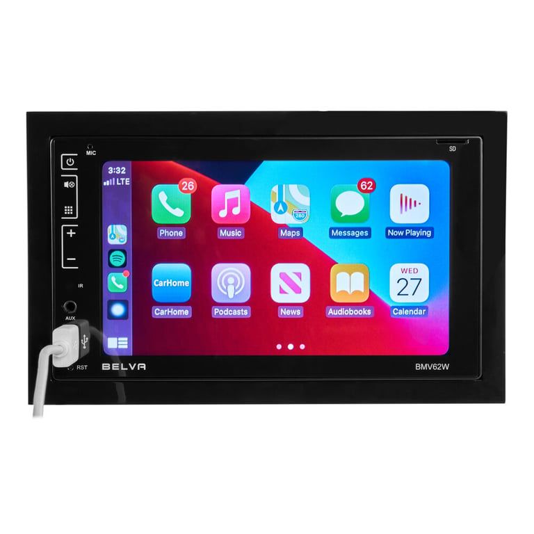

This unit.. $79.99 @ Sonic Electronix
Belva BMV62W​

That Belva unit looks like a good choice. The truck is a DDin, so it will fit. I was hoping to get a SDin so I don't have to fabricate a counsel to install the EQ. However, I'm just being lazy.
I'm on board with the HU needing to be a descent product. However, in my opinion, it's not as important as it used to be with CD players, especially if there is a separate EQ in the system. The problem is, I hear there is just as many issues with the name brands as there are with the off brands, so I'm seeing what offbrands are out there that are reliable. After the HU, he still needs speakers, the material for the box and custom door panels, etc...
His current equipment is pretty descent. He has a PPI PC700.4D amp, PC1800.1D amp, and an NVX VCW124v2 sub.
For $80 bucks.. Its really a decent unit and may be hard to find something within that price range with the features it has? There may be something out there though?
