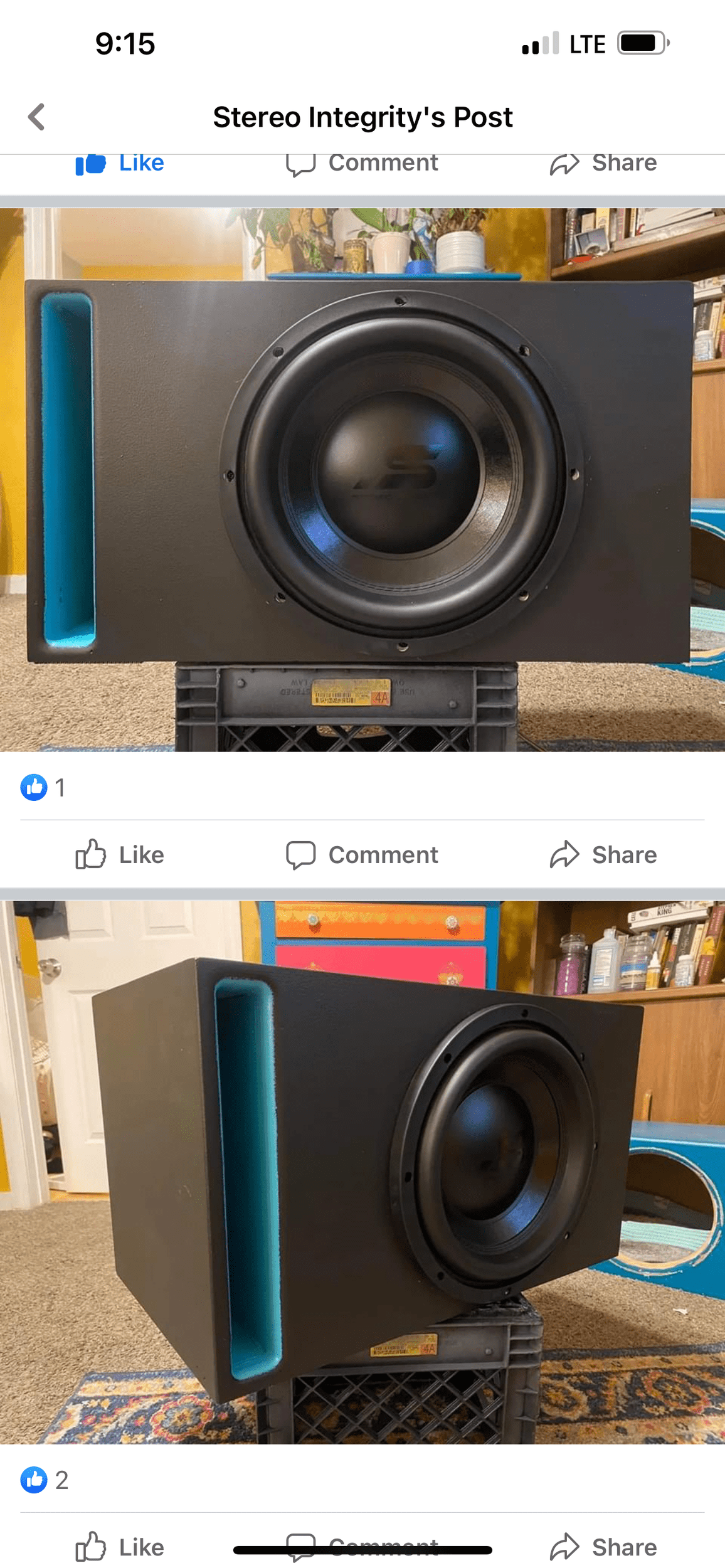

They posted this beauty a few weeks ago 😍
