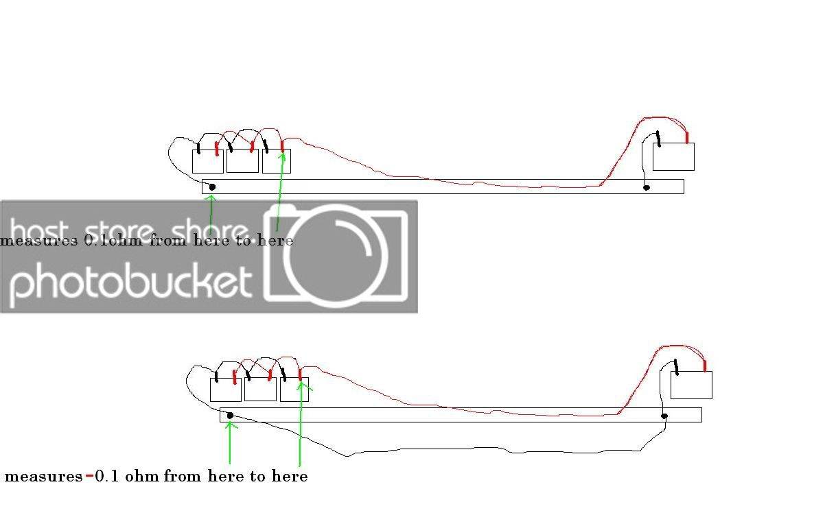

I just checked my ground in the rear with my DMM. im getting 0.1ohm with the way i have it set up now (1 run of positive only to the rear batts)...
but.. i used a spare piece of 2/0 and used it as a temporary ground from front to rear (so 1 positive run, and 1 negative run now) and i measured it again at the rear batts, and its measuring -0.1ohm (negative 0.1ohm). is that correct? i thought 0 was the lowest.
heres a pic of what i did,
first one is how i have it setup permanently, second is what i tried temporarily:
is -0.1ohm better than 0.1ohm for a ground?
Its the same thing, its your meter acting odd, it probably initialized differently than before.
Or you switched the way your leads were measuring the resistance.
A DC resistance has no polarity so there is no +/- Measurment.
the -.1 and .1 are the same. u crossed the red and black leads somehow either at the multimeter or at the source point.
Or ur multimeter is running low on batts and is acting funny
