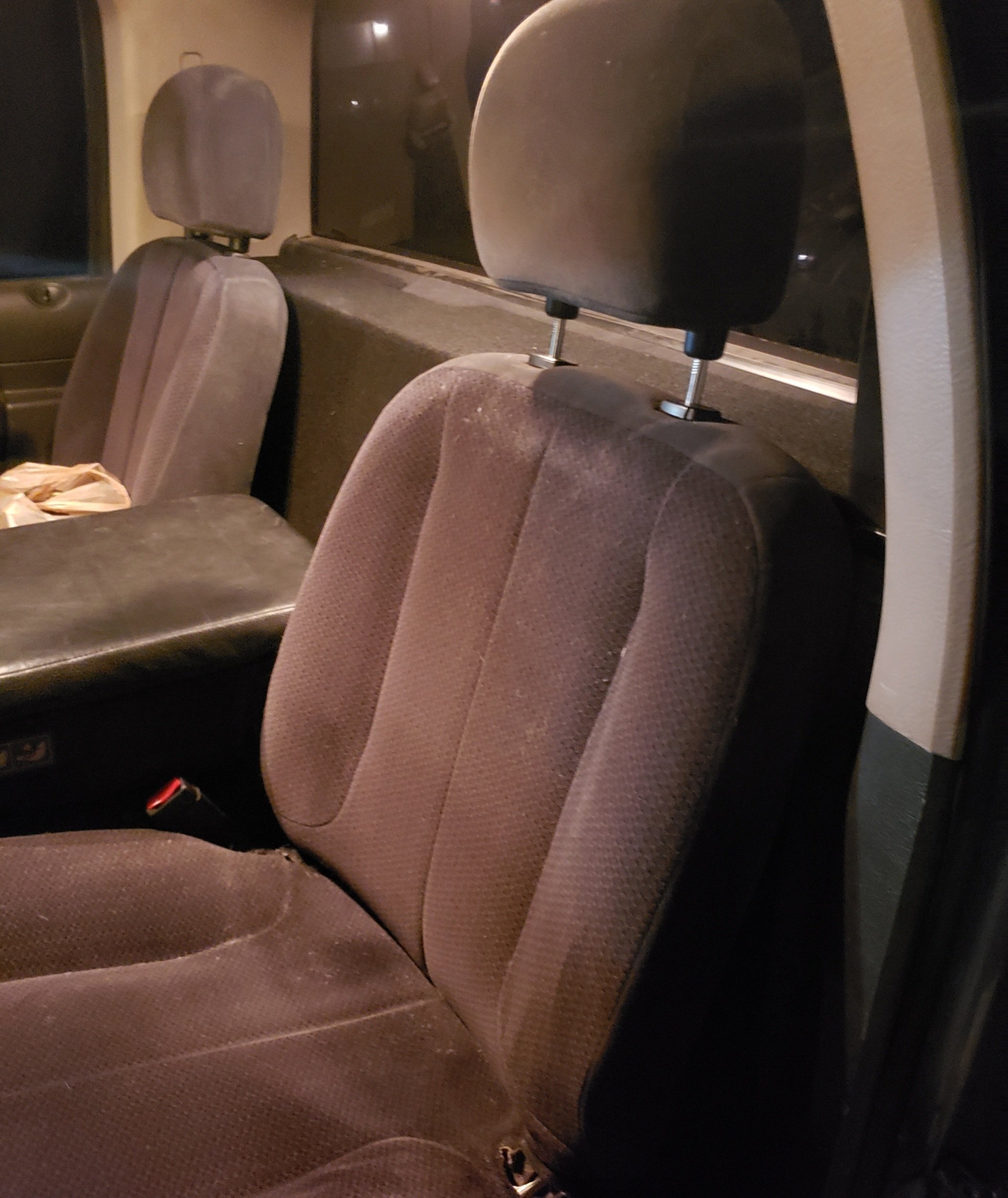

I'm running 4- VFL8's in a standard cab Dodge behind the seat in a standard cab Didge on a 3K amp. I'm also running a 320 amp alternator and a 1/0 big three. Standard cabs have a big advantage of a small cabin, but a huge disadvantage of airspace and mounting depth. This is behind my seat. 5 cubes ported at 33hz. and the seats are all the way back. Those are 8's.
