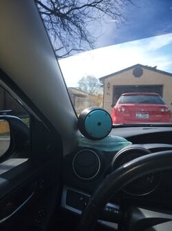

Here is the plan.
My car is on a bit of an incline, the nose is sitting about half a foot higher than the rear. The little bit of windshield obstruction is almost a non issue when its flat. Its no more a space issue than the aluminum ones i got from Germany because the additional volume is in/on the elongated backside of the pod. I could actually move them up another .5 to 1 inch up the pillar without hesitation. My tweeters pods will be mounted in that little triangular sail area where we used to have wing windows!
The straight on view are 1st and 3rd pictures, they are at pod level (about chest level), not eye level.
