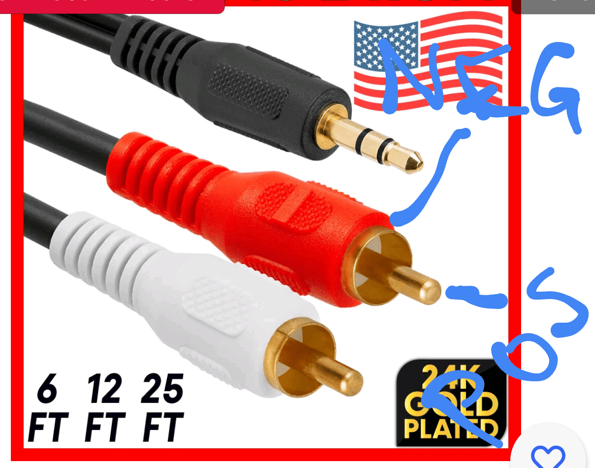

Correct. From the amp, disconnect the RCAs that come from the LOC. The picture below points to where you will connect your multimeter test leads. Be cautious that positive and negative do not touch each other. The guy in the video made that pigtail to avoid this issue. Set multimeter to A/C volts. After downloading that 1000 Hz. test tone, play it on your radio at ~75% volume. Now sweep the gain on the LOC until you read the 5 volts that your amp can handle. Boom, Jalapeno solutions. Before reconnecting the RCAs to the amp, turn down the gain at the amp. Turn it up judiciously after that with the radio at ~75% volume.View attachment 47064
