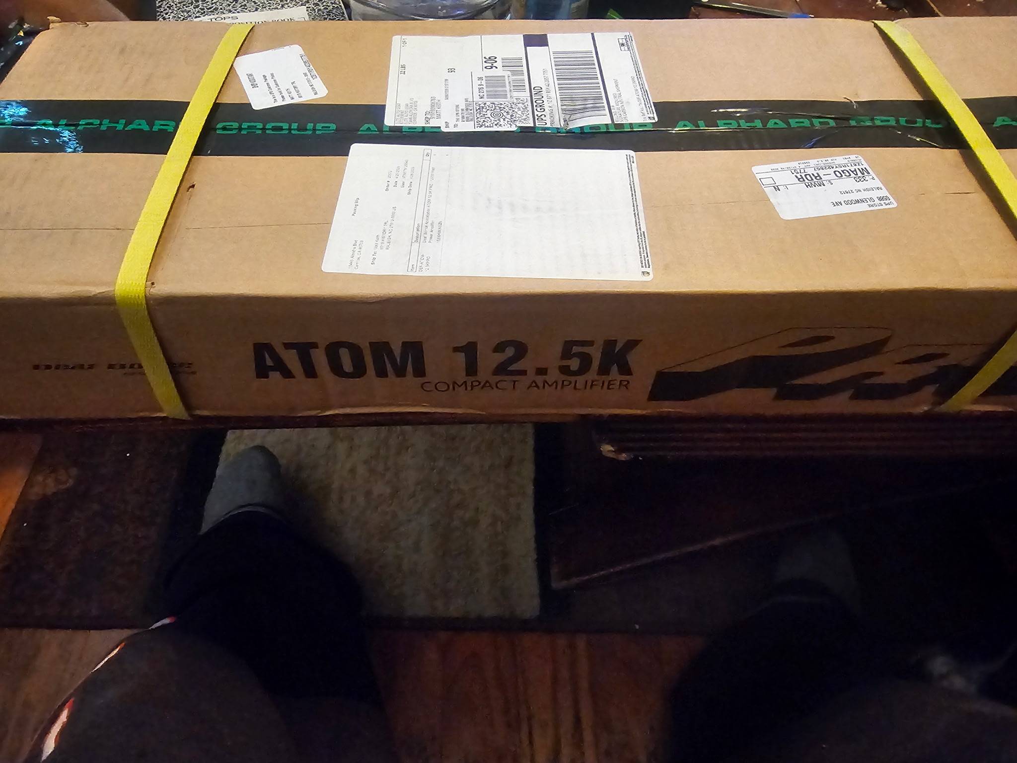

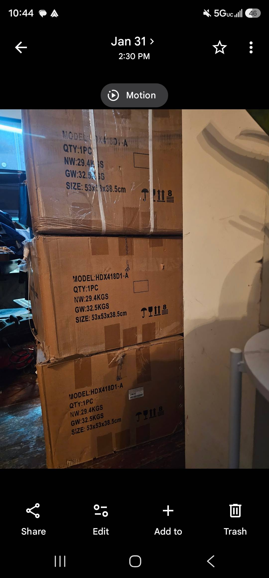

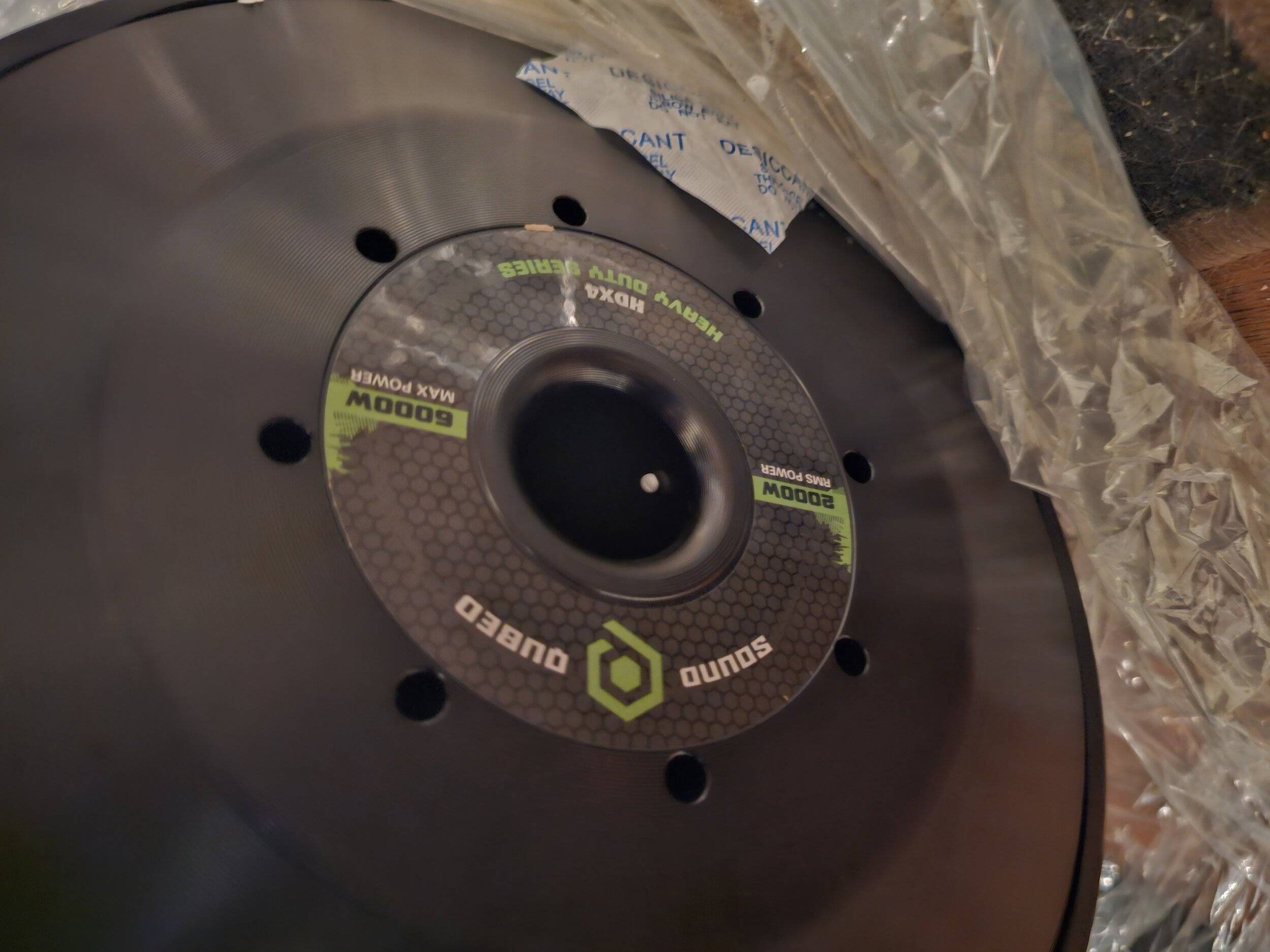

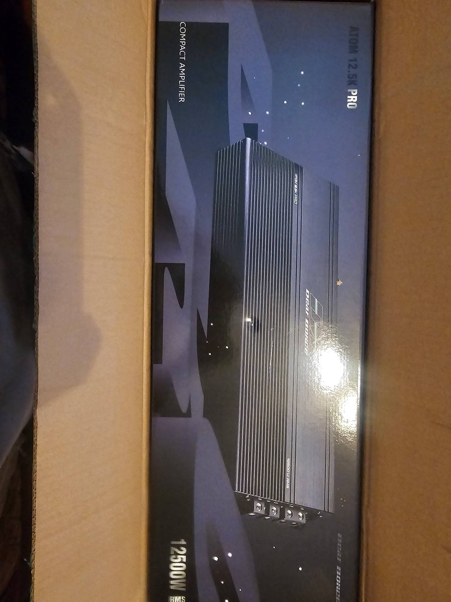

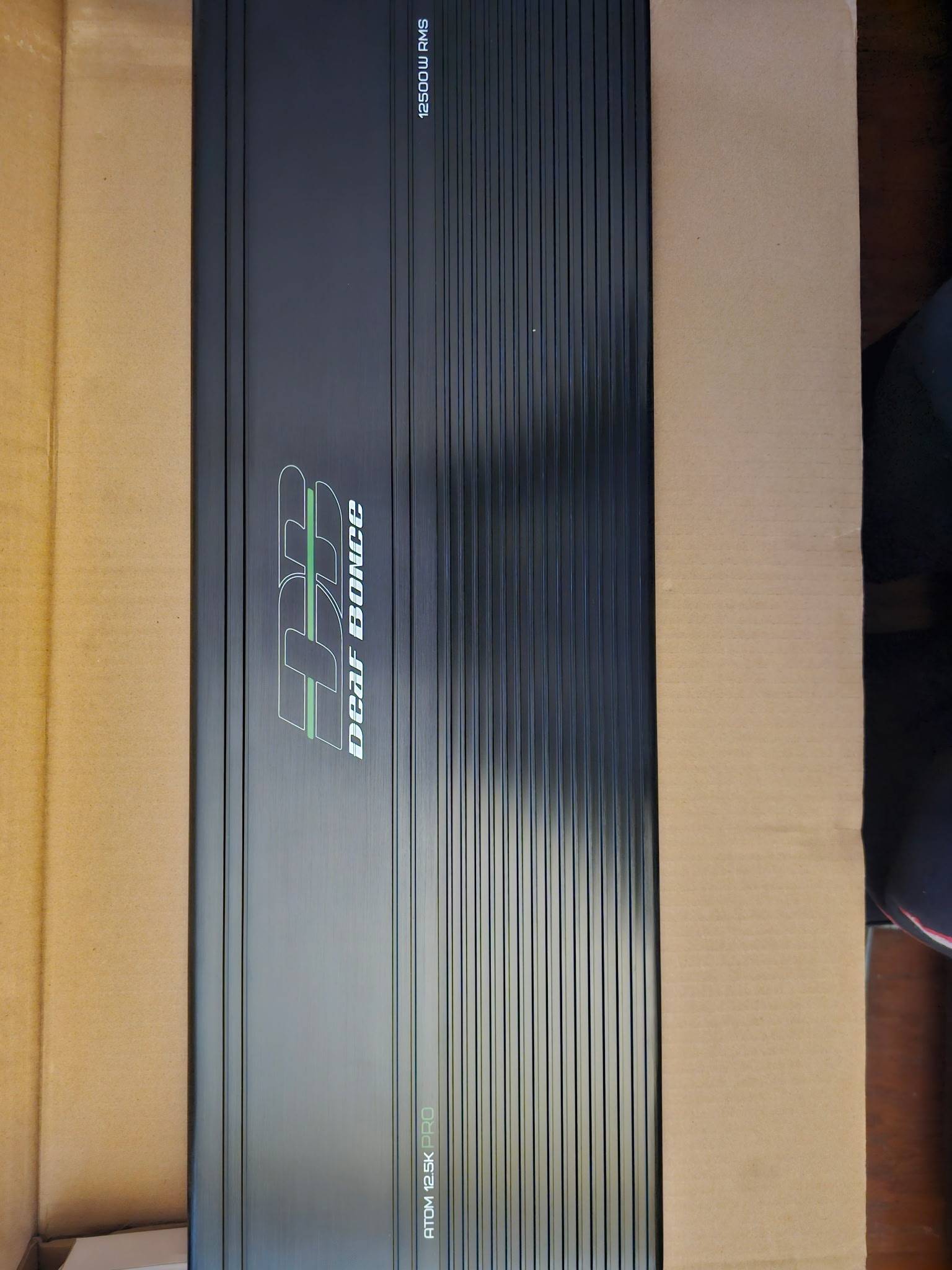

I have 4 soundqubed hdx4 18 dual 1ohm rms 2k and peak 6k. Wanted to know if I can run my deaf bonce atom 12.5k at .5ohm on these subs with no issues

No, you should not try to run that amp on a 0.5-ohm wired load; the amplifier is not rated for 0.5 ohm operation, and you will void the warranty if, make that when, it blows.
Secondly, you have only two options for wiring these subs to that amp, .5 or 2 ohms, so 2 ohms it would have to be.
I am not aware that the Soundqubed HDX4 series comes in an 18", so I'll assume you meant 15".
They are 2000-watt RMS woofers, so the optimum amplification is somewhere in the 12k range, which you won't get at two ohms - tough break.
The amp is rated for 6950 at 2 ohms, so either get an amp that puts out 12k at 2 ohms or replace the subs with four dual 2 ohm woofers and wire them to 1 ohm.
So, how are you supporting that amp, electrically?
Additinally, the difference in output between roughly 7k watts and 12k is not very sub-stantial. ;)
In a car, that 5000-watt difference (6950 to 12.5k) is likely to produce only about a 1.5 to 2db difference in output.
Are you going to be competing?

Yes the soundqubed hdx4 does come in an 18 yes I will be competing with this build. Talk to the builder he is suggesting running another deaf bonce 12.5k. And have 1 par on each sub at 2ohm final load
Cool, I didn't look very hard, might have been the site I went to.
Not that it's all that important, but man, gonna be a BIG box!
So, a set of dual 1-ohm drivers gives you 2 options per set.
1 ohm:
Or 4ohm:
So, you can power each set of sub drivers with one each of the 12K Atom amps (Atom amp, wasn't that an 80's pop singer?) at either 1 or 4, but not 2 ohms - which kind of leaves you in a bit of a pickle...
Each wired set will have a 4000 watt RMS thermal limit, so, as stated prior, you're going to want around 4k plus around 50%, that's around 6k per set.
The Atom 12K (at 14.4V at 4 ohms) puts out 3870 watts, underpowered and a waste of money.
At 1 ohm, it puts out 12k, WAYYYYY too much power, and again, a waste of money since you're talking about getting two ($2200.00).
If you're game to run two amplifiers, then consider a pair of the Atom 5.5k amps instead; same money as a single 12k but at 1 ohm, they put out around 5500 watts each, which is aligned for what your four, 18", dual 1-ohm drivers need.
AND, if you're running a lithium bank to support the amplifiers, you might want to consider something that gives you 15-16v, which will bump the two 5.5K amps to around 6K (@15v) and up to 6790 watts (@16v) each, a little overkill, but definitely a good overkill.
