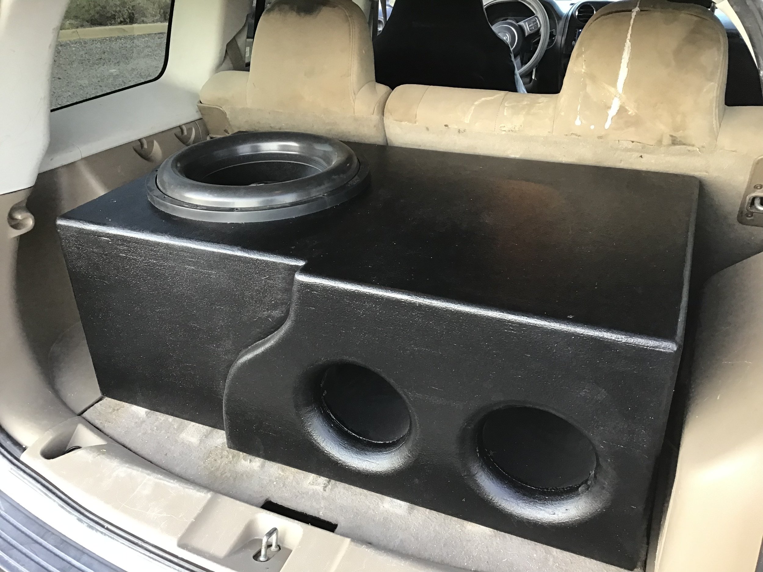

Aeroports. I have dual 6 inch aeroports on mine to cut back on space. Both of the ports combined take up less than 1 cube. 8 inch aeroports would take up more space, but would still be less than 1.5 cubes displaced. I think you can get away with dual 6s or a single 8 inch. Add in woofer, bracing and thick baffle and you could probably get 7.5 or even 8 cubes using aeroports. I did this one with dual aeroports so I could plug 1 port and get a super low tuning for playing with the low test tones. After using flared round ports on a few different builds, I’m definitely becoming a fan of them.

Thanks slug, thats a nice box. Sound wise aero ports are good ? I suppose i could tune lower his…like 32, but really not trying to go above that
