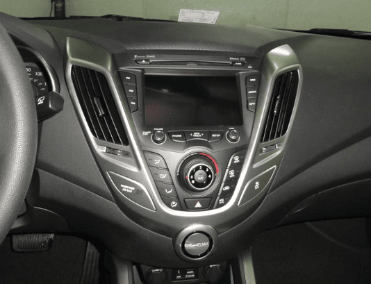

So I have a factory amplified system. I've decided I want to upgrade the whole thing. I don't want to retain anything from the factory system. Would I be correct in assuming that when I get a new head unit. And my own amps for the sub, replacement speakers in factory locations, and some additional mids/highs I can just continue the install like you would in a car without all these extra electronics. I keep looking and everyone keeps trying to sell me these adapters for the factory amp among other stuff. Not only does that over complicate the install. It cuts into the budget significantly.

2015 hyundai veloster turbo.
This is my "get around" car so loud at all cost. I was going to keep it modest but we got a new car today so now this one can be obnoxious lol.
Bluetooth is my primary connection source at the moment.
I don't really have a set budget. I don't plan on this being done tomorrow so I can save and purchase as I go. I just don't want to sink money into preserving creature comforts and factory "quality" in a car that travels maybe 15 miles a week
Okay, good start. Did the Veloster come with the "Dimension" sound system?
Are you wanting to try and retain the rear R/L panel 8" sub locations or do you have room for an enclosed sub in the rear hatch area?

Sorry I was away for a couple of days, but yes, I do have the dimension audio system and I actually already have a sub and amp in the rear hatch. I installed it a couple years back with a standard LOC. The factory 8" sub was blown when I bought the car so retaining it really doesn't matter.
If you don't want to retain anything from the factory, then it's wide open. From what you indicate the SUB may be on the table too? What sub are you using and what is it powered by?
As for the sound, are you familiar with Pro (PA) style components? If not will steer clear of them as they are loud, but sometimes brutally, not daily driver loud in my opinion. That said, I would start looking at some of the HU's from Kenwood, Alpine, Sony, once you have established a budget for that piece, pick a few of of those that do the things that you want. That can help with the LOC, amplifier(s) and speakers which will follow.
Some things to consider, straight up passive system with an HU/LOC/Amplifier(s)/sub or are you considering something active like a DSP configuration?
When I stripped my factory system and started from scratch. I didn't need any adapters. I wired the new head unit wiring harness to the vehicle power, constant power (for memory and clock) and ground. I located the amplifier turn-on wire and ran it directly to the amplifier. The speaker connections were directly from the amplifier, so no adapters were necessary.
