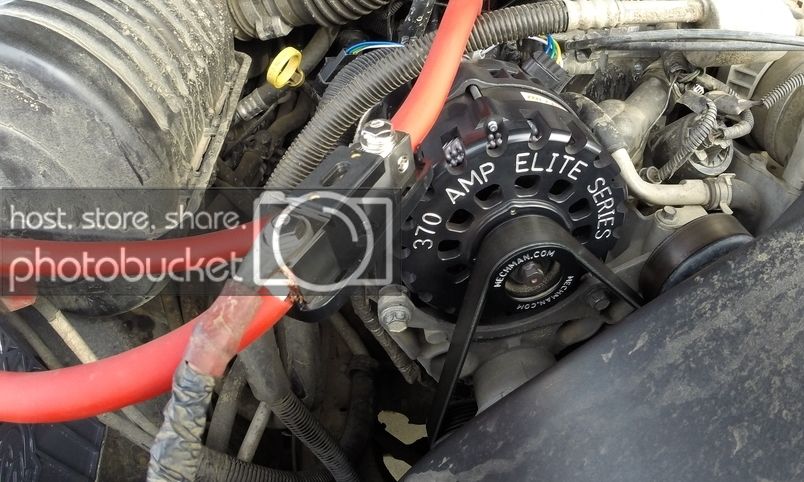

voltage good, still clipping?
couldn't find a grommet on the passenger side for that run that's on top of the intake so it will have to stay there for now, excuse the mess i do a lot of off roading and playing in the mud and what not
