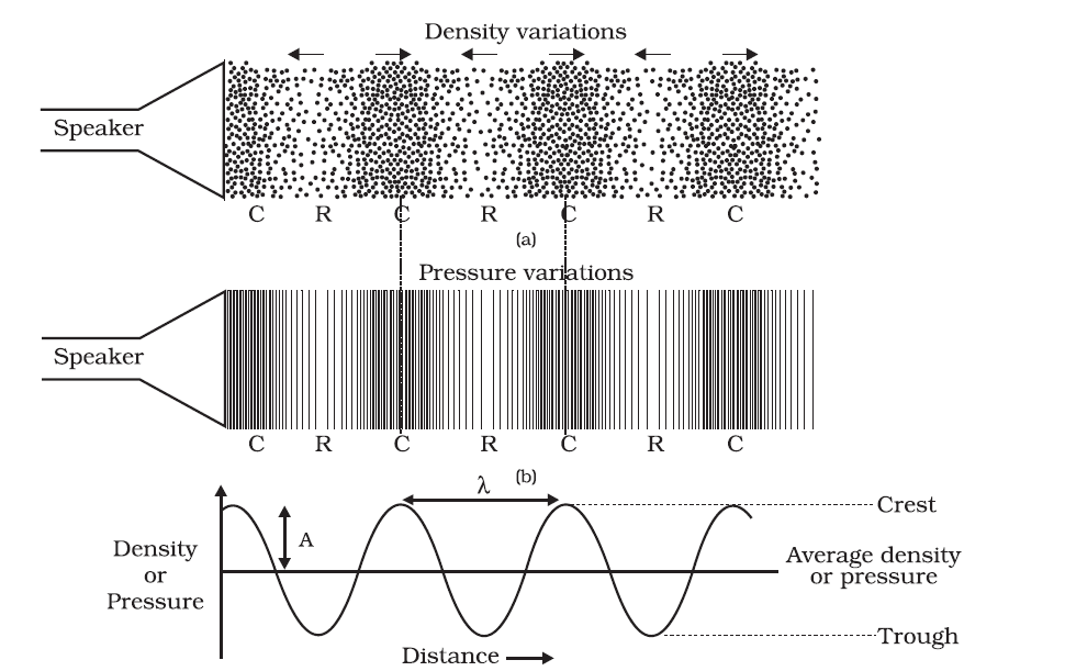

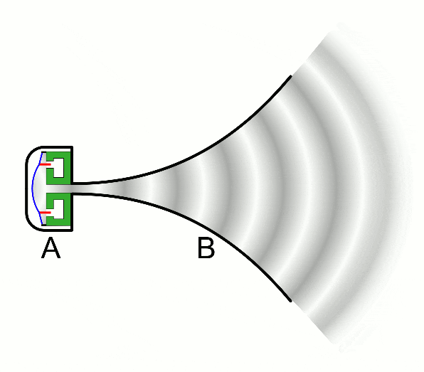

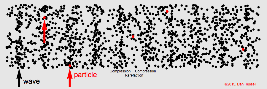

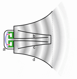

Some random data for you relating to accoustic coupling:
You can see how the wavefront stays coherent as it matches or more closely matches the surface area of the cabin (height and width), like waves and air flowing through your clam slowly expanding and contracting as one, instead of abruptly expanding and breaking apart more, like if your port just immediately opened to full cabin area. It’s really air impedance, but haha I’ll leave it there.
View attachment 52876View attachment 52877View attachment 52878
