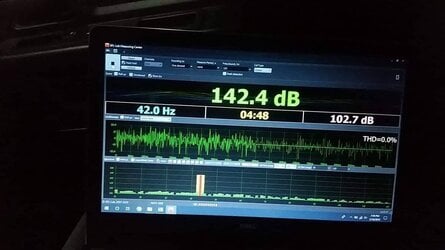

Got the meter today and finally learned what incredible deebeez this thing is hitting. 141.8 lol Keep in mind that my electrical system is bone stock and I'm running these on an audiopipe APMI-2K wired @ 2 ohm. With box rise, realistically these things are only seeing about 700-800 watts (if that). In the video I had a brain fart and said they were wired @ 4ohm. Anyways, here's the video:
Wired to .5ohm and saw a little bit of a gain. I think this has hit the max, the t-line just doesn't allow me to throw enough power at these 8s before they hit their mechanical limitations. The $150 SPL Challenge runs until May 31st, so I am just going to build a burp box and see what these things can really do.

Pretty good score for $104 worth of subs and a t line. There's more left in them with a cabin resonance aligned burp box and more power.
