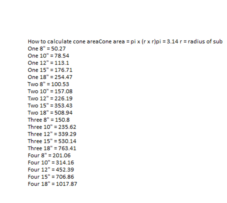

WORKING OFF THIS CHART:
4 of these (okay $1076 but...) tuned to 24 hz - WOW!
4 of these in a 6 cubic foot box would absolutely kill it! To die for!!! (or of).

I tell ya, those SI 12s are damn good subs. The cone area w/4 is almost the same cone displacement as the 6 10s would be. I would think even after bracing and vent displacement you would be close. I'm sure someone could model it for you in WinlSD. Off the cuff I came up with a gross volume of about 7.5cu ft, 12" x 4" x 31" port, heaven at 24 hz!
