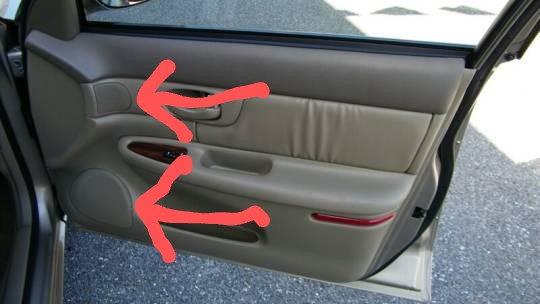

This is my car door. It's on a curve around the 5 1/4. I suppose it's possible to jam a 6.5" in there maybe? But I doubt I'd be able to do an intricate flush job that looks good. Still some 5 1/4" make quite a bit of noise at high-end levels.
I'm thinking of adding a couple 3" or 4" mid-ranges in the dashboard but I'd rather avoid the work of modifying panels when possible.
I already have the best 3/4" tweeters on the market according to spec that fit the OEM hole(see picture) which happened to be JBL's so it made me think from there I should get a high-end line from JBL to match in the rest.
