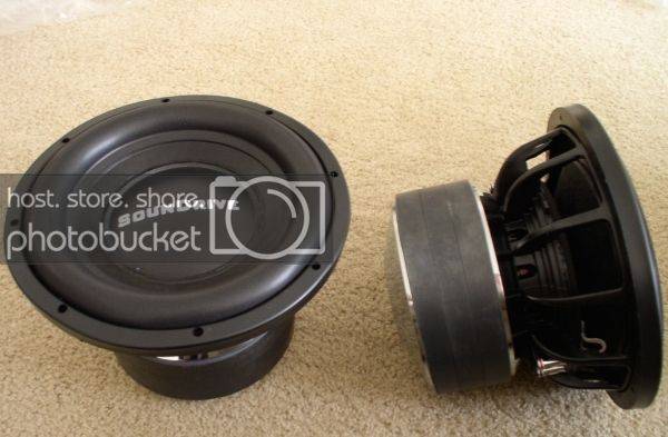

Soundrive SDA3 12's

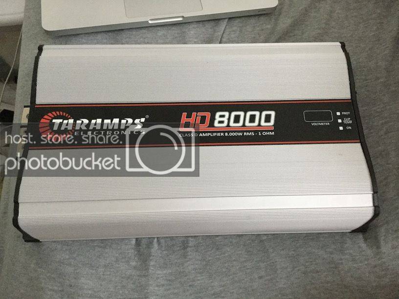

Taramp's HD8000 Ex

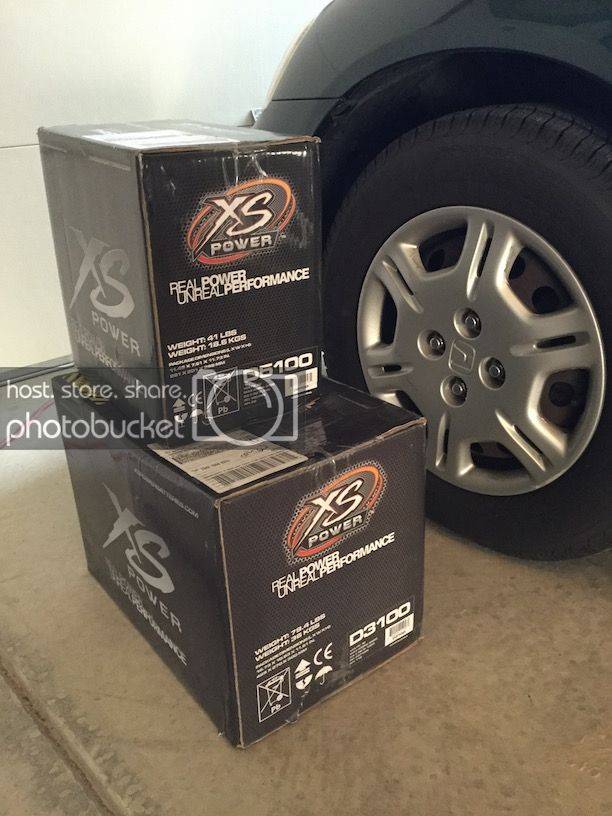

Xs Power D5100 & 3100 (maybe more battery coming)

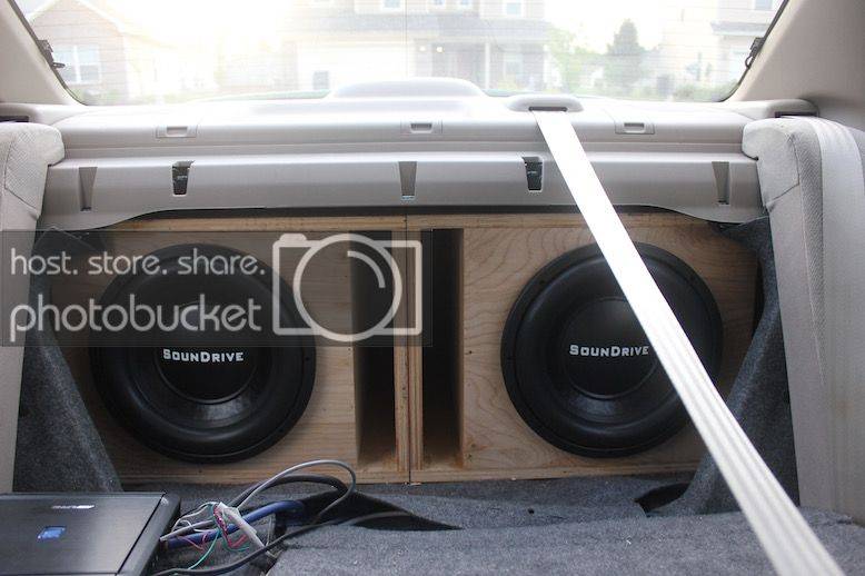

Le' box design

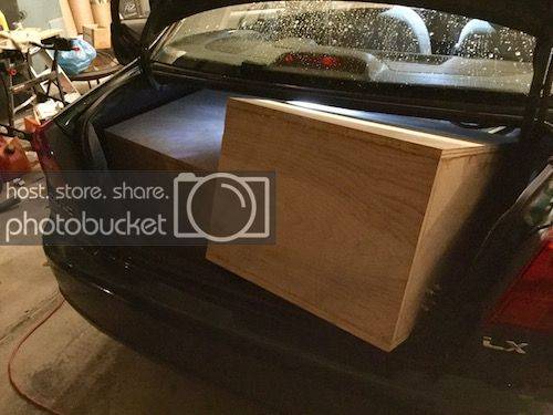

In the trunk, making a beauty panel and sealing off after everything is wired, batts etc.
Garden hose
Tight fit but we'll make it work

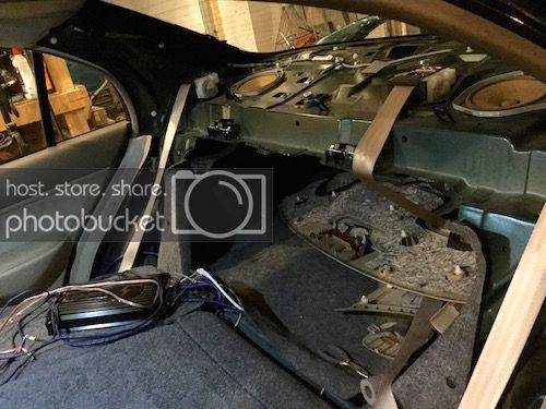

Got my crimper in, still waiting on amp inputs and need to order outputs. Started disassembly tonight.

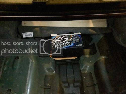

Boxes coming out
Where I want at least the first batt to be but its within a 1/16" so I may have to shave some metal on the trunk cutout under the deck.
And were I ended for tonight, hoping to get the rear seats and passenger seat out tomorrow.

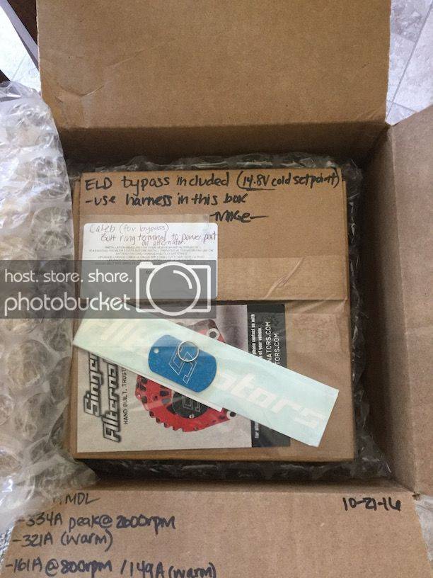

Hope that alt goes in alright. I had a bit of a problem fitting my 275 amp Singer in my 01 Civic. Don't remember exactly how I got it in but it's on now. I think I went kinda backwards because there's not much room for tightening the belt. I think I had to put the belt on then work my way backwards to the mounts, then adjusted the belt... Hope that will help a bit
Thanks, I haven't looked much into it yet and have only taken the alt off of this once. I am planning on getting a shorter belt for it to reduce the amount of adjustment needed on the horizontal sliding mount.

Got the alt in finally. Ended up using a 40" belt, still squeaks a little on startup. Ran 4/0 from alt to batt and batt to frame, still need to do batt to eng. Made the factory ground and pos longer with some 8awg I had laying around. Got heat shrink, deadener and amp inputs in the mail today. Currently have a sheet and a half of deadener down on the rear deck. Hopefully get firewall drilled tomorrow to make my runs to the rear.

Ok joking aside, just wondered why 2 separate boxes instead of one?
That'd be my guess as well. There's about 9 cubes or so of usable space in the trunk, but getting a box larger than about 4 cubes (gross) in the trunk is nearly impossible without assembling in the trunk.
Runs to the rear?!
I usually have that after eating something bad...lol.
Well thats certainly one interpretation
Probably easier to put them in the trunk vs building 1 big box in there. Just my guess.
^This. I was only able to get maybe 3.75 max with one box and still be able to get it in and out of the trunk. Im right over 5 net with the two separate boxes and probably could squeeze a bit more in there if I really wanted.

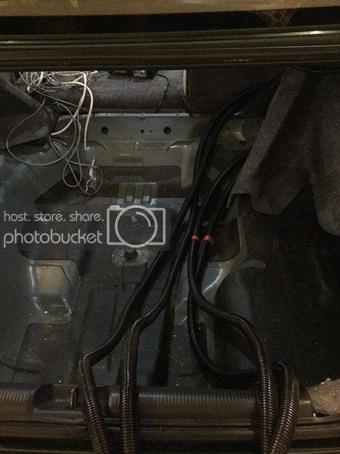

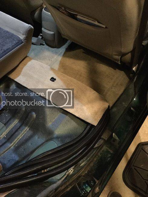

Got around to pulling the passenger and rear seats out today. Got half of the carpet up. Finally finished drilling out the firewall, using a step bit was great fun.. Four runs of 4/0 front to back now, stuff is heavy AF and hard to work with. I would really like to get everything together this week to do a test before making it all look nice.

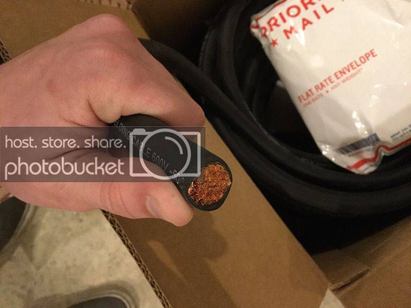

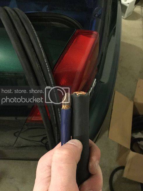

And knu 4 awg vs 4/0 welding cable just for fun.
