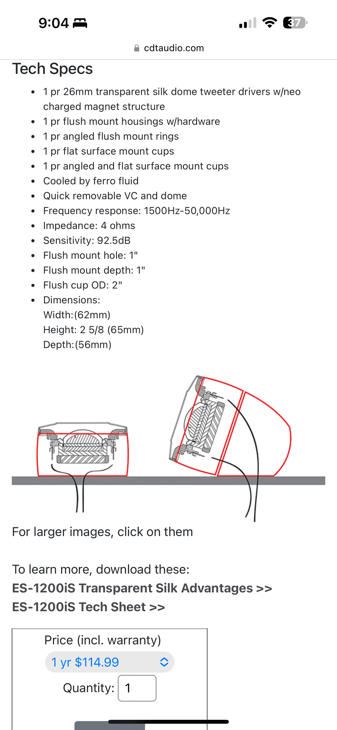

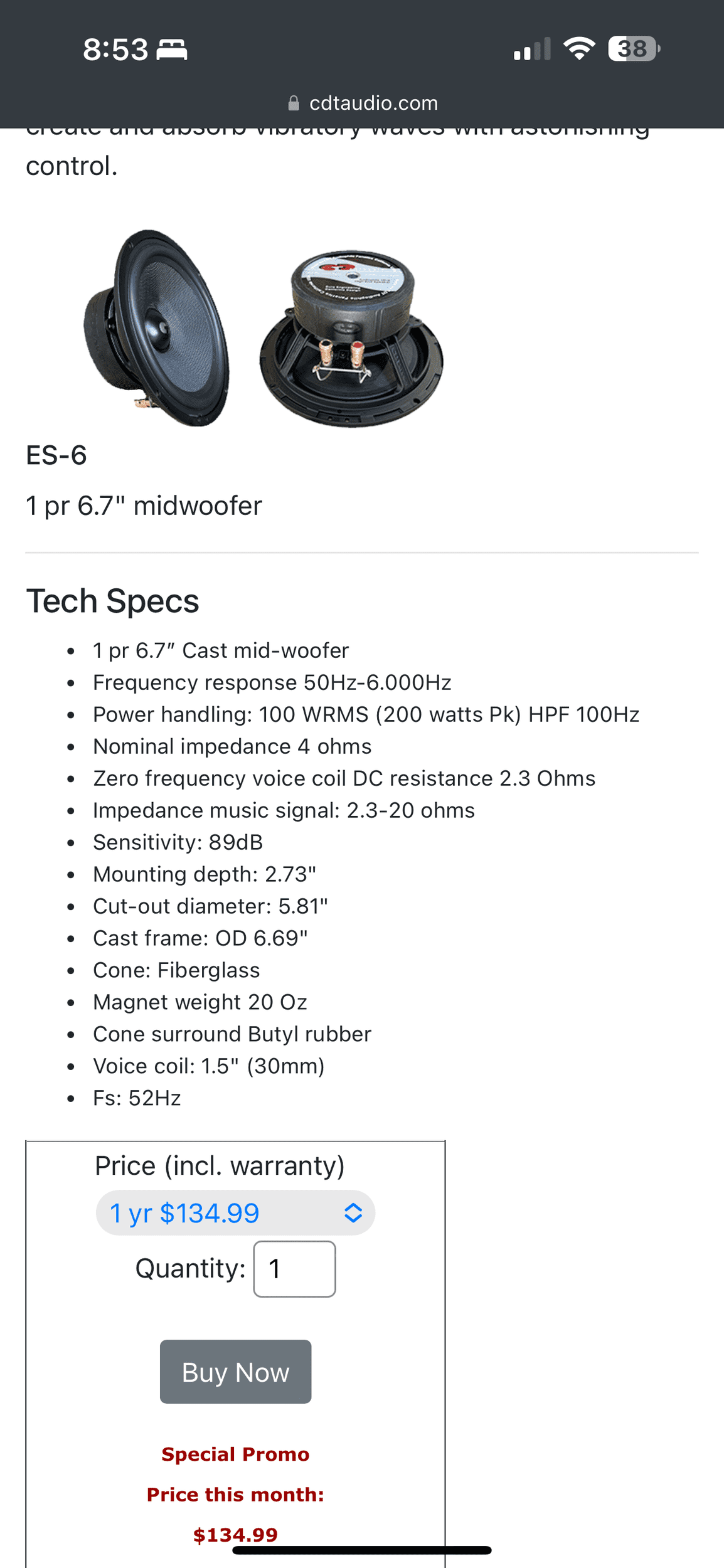

Pretty sure I’m going this route. I’ve been happy with the CDT components in the Ram.
I already have leftover Mx-1000 cross overs that I got with my three ways before. They are running full active through my Helix v eight DSP.
I also already have a 5ch amp(4x100, 1x300w). With this amp my components might be a bit underpowered, I guess I’ll find out…
These as a front two way:

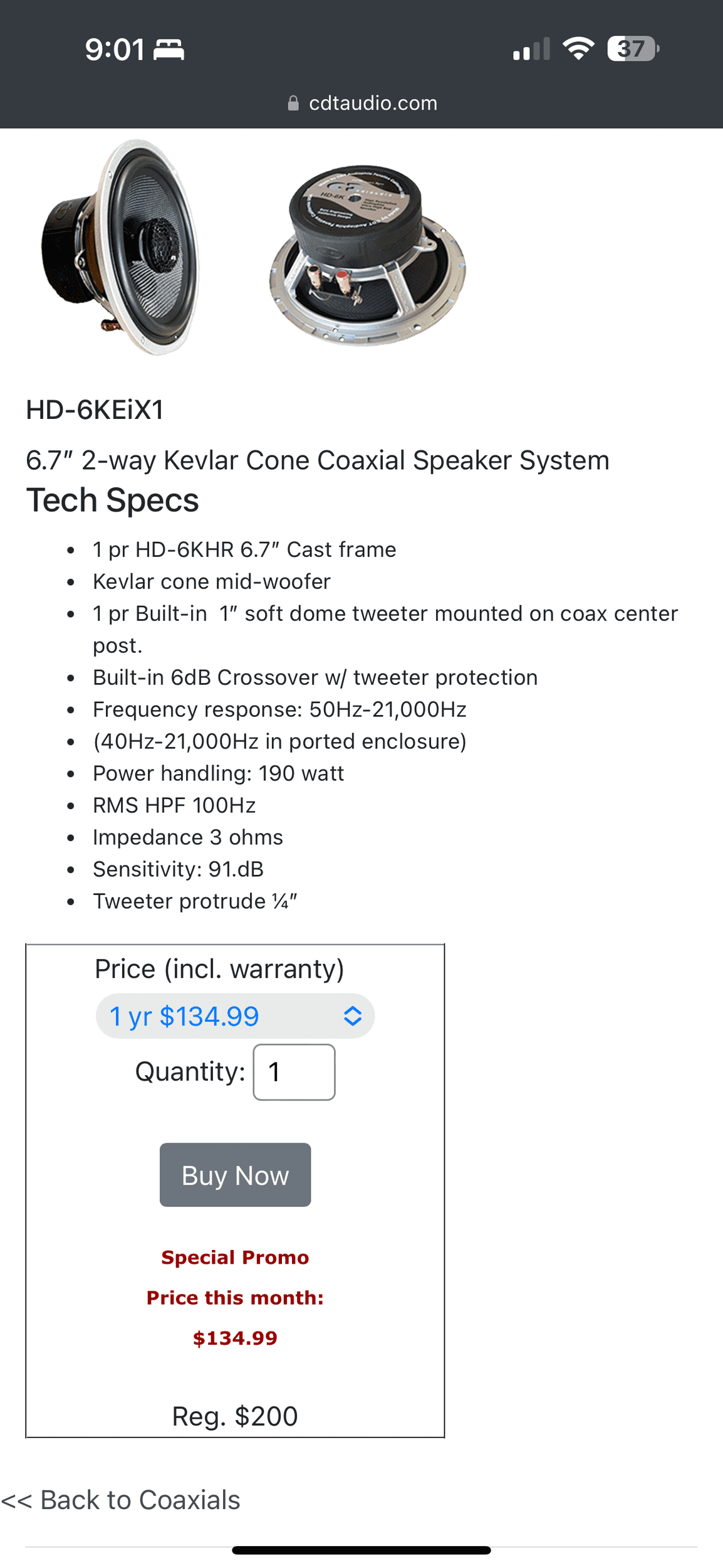

And these coaxials in the rear doors:

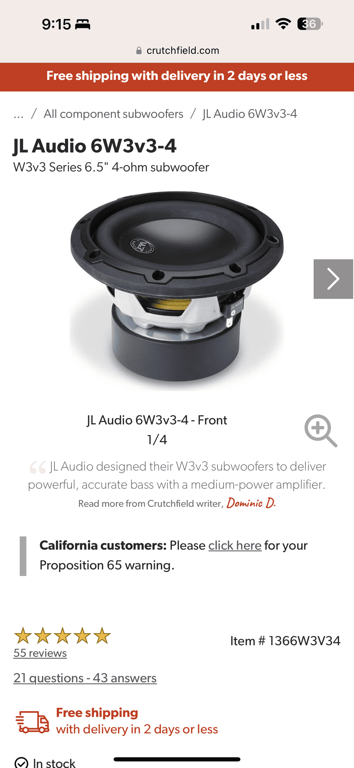

With a JL 6W3v3 sub in the factory location:
Thats some nice gear there. I really like all my CDT speakers Ive bought. They should sound great man.
