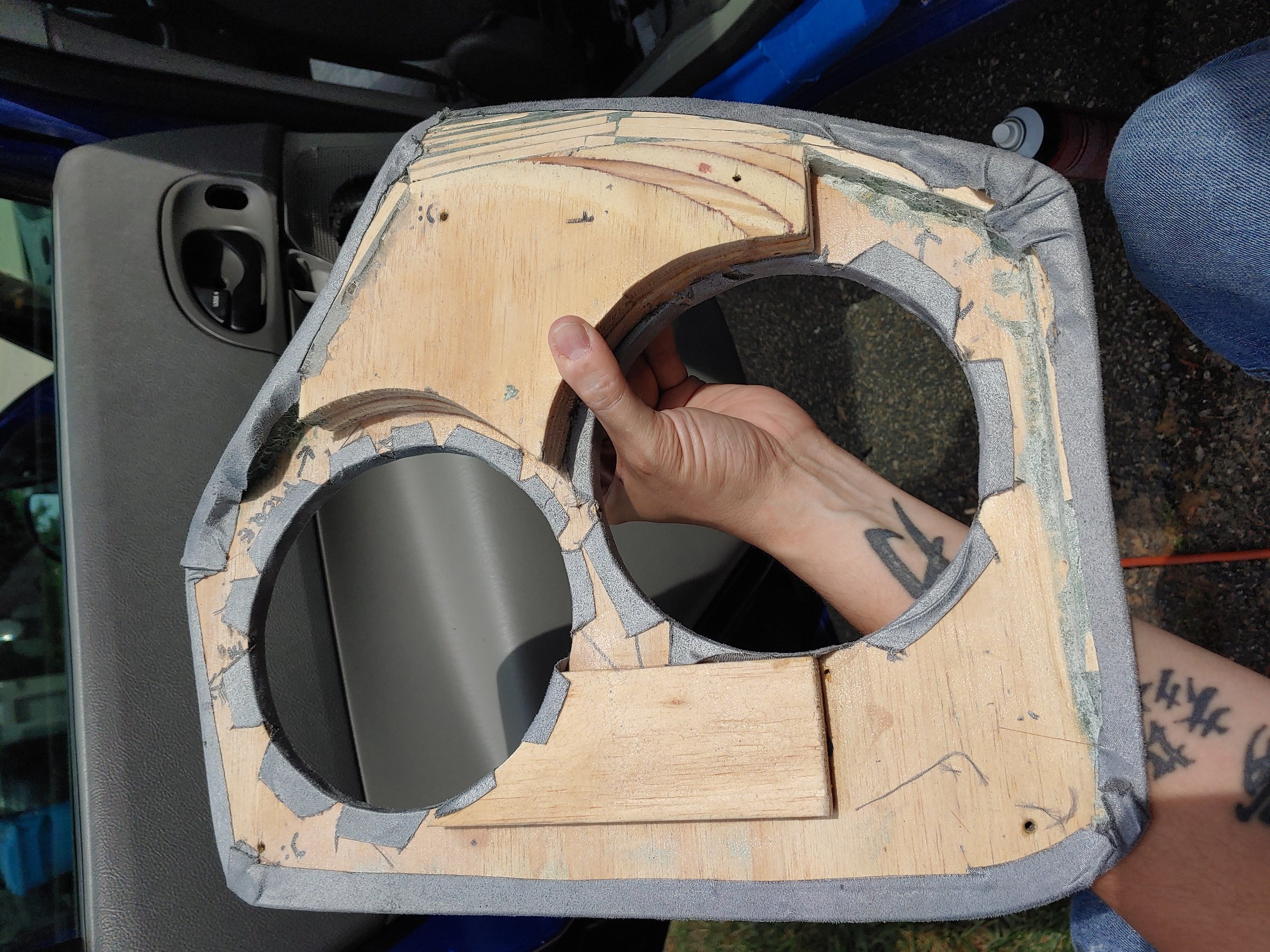

Here is a shot of both of the inner baffle pieces I am using for the door mounted midbass after the first sanding. Notice how they aren't symmetrical. I made the baffle a little bigger for the rear passenger door.
A little quick fitment before I added the second coat of filler. I hit both the front and the rear of both. See there was a little filler ouside the lines but it came right off of the deadener.
Another layer of reinforced filler was added. I added a bit more in the third layer but I didn't take as many pictures this time. You guys get the idea. I sanded them to 120 grit in case anyone is curious smoothing the edge profile and the front and rear face.
My original plan was to hit them with resin and chop matte but with both the deadener, aluminum tape, and neoprene I really didn't feel like it was necessary. We'll pull the door cards in a couple months to see how they fair. This a single layer of deadener by the by. On the rear of the panels I used a layer of neoprene which is pretty hydrophobic anyway.
I added a few pieces of aluminum tape which you can see in the background. When there was a single midbass in the door I used butyl rope and non hardening modeling clay and it made a proper mess, let me tell you. The cable hanging is for the window/lock switches. I will tape (aluminum) it after I wrap in some neoprene or tesa tape so it isn't in there making racket.
Aaahhhh. One of the more satisfying shots I have taken in the build. I ended up using seven self tappers which turned out to be more than enough. I could rock the whole car when I pulled on this little bugger.

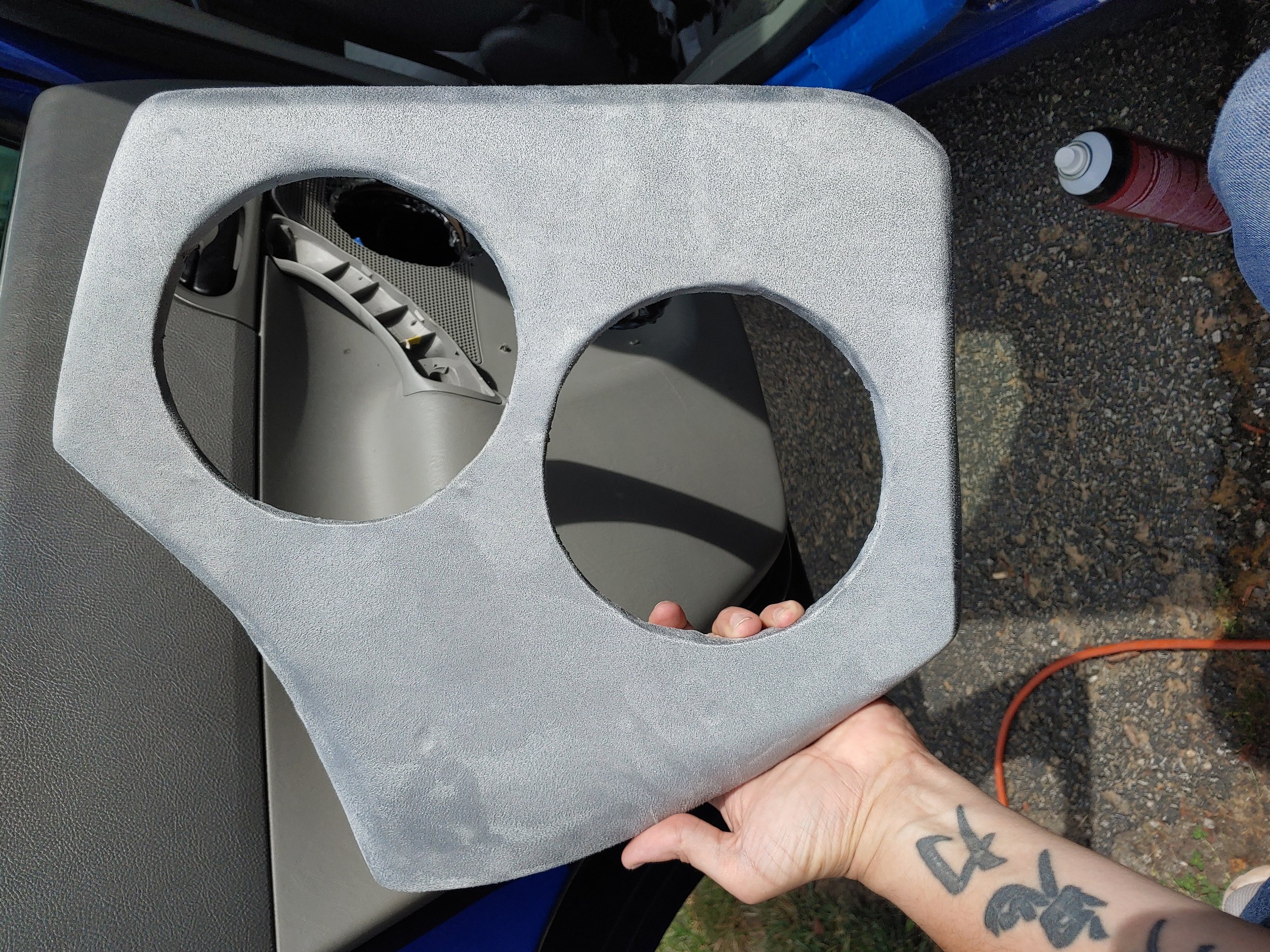

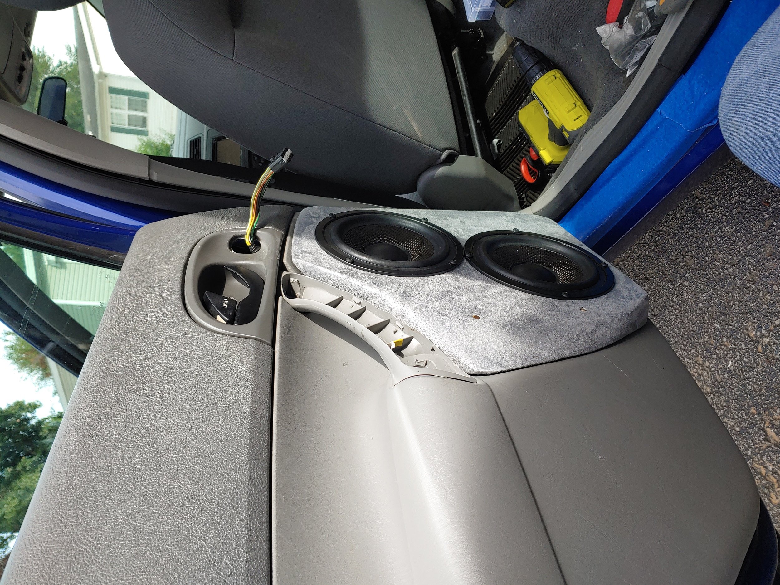

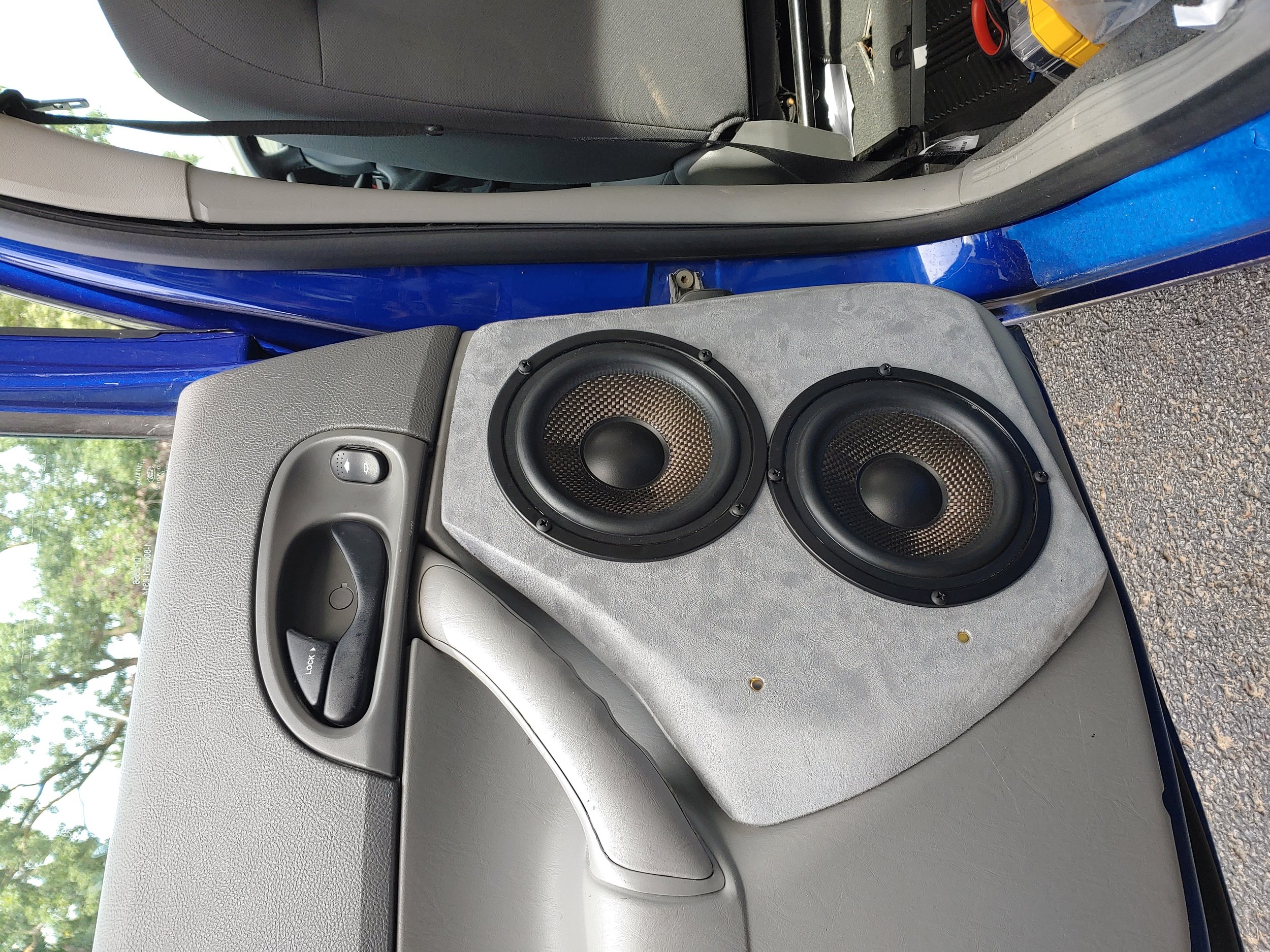

The panels were much easier to wrap than I thought they would be. The rear were glued a bit more before I installed them but you guys don't need 10 pictures of that. The color is called salt. It actually looked greener until I mounted it to the door. It's a microfiber suede I picked up at Joann fabrics.
I ended up using two of the front screw holes then added 5 more to the rear of the panel to secure it. I suppose I could take a pic if you guys want. I used a couple sizes based on the depth I had available.
The gold pins were used to cap the holes and I think they give a cool little touch. I will be building a cover/grille later out of fiberglass to shield the speakers but that's later.

Thanks brohamster. I spent a lot of time on them and am so glad they are done. I didn't mention before but right now I have them wired in series 8 ohms and bandpassed. 63hz 18db/octave -1.25khz 24db/octave. Worked with them a little on the EQ too. All through the deck so far.
